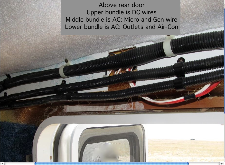

As mentioned above, all of the AC wires that go over to the passenger side, do so in a clump over the rear door (they are in two wire loom conduits, separate from the DC wires conduit). They stay "high" until they are in the very rear/passenger corner, at which point they come down the wall in the very corner of the closet, go forward and over the generator box (just below the fridge wall vent), and then head up the wall behind (outboard of) the stove area.

Okay, so here we start with the wiring that goes "across the great divide' - from the driver's side to the passenger side. Here are the three main looms as they pass over the rear door. The large upper one is the DC wiring (would be nice if it were not in such a single large bundle as that de-rates the wire quite a bit but oh well it seems to still work fine); the middle one is AC wire for the generator and microwave; and the lower one is AC wire for the outlets and Air-conditioner. This is accessible by removing the carpet "hump" over the rear door.

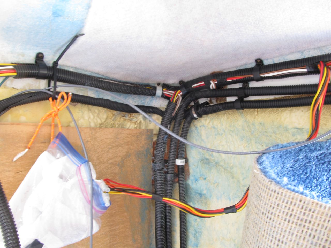

Next it continues on at the ceiling/wall junction until it gets to the rearmost/outboard corner in the closet. At that point the DC bundle splits, with some heading straight on across (where it can chafe on the refrigerator fins - something to check), and some splitting downward along the corner. The AC wires all go down in the corner (I think that one AC wire going across to the left is one I was in the process of adding for an outlet by my new hall counter). The thing in the baggie is the inside generator control that's in the closet front wall. So in other words everything on the right half of the photo is rear wall, and the left half is outside passenger wall. This is only accessible by removing the carpet "wall" of the outside of the closet (in my case, having navy carpeting, I was tired of the "black hole" and so will be putting back marine hull liner carpet that is more similar to the overhead carpeting in our rigs - it's such an irregular wall that carpet is more practical than something like wood).
This one is a little messy, as I was starting to "do things," but is the bottom of that same corner, looking down from above. As in the last photo, right half is rear wall, left half is passenger wall. The silver box is the generator surround, sans carpet. Again, this is behind the closet carpet/wall.

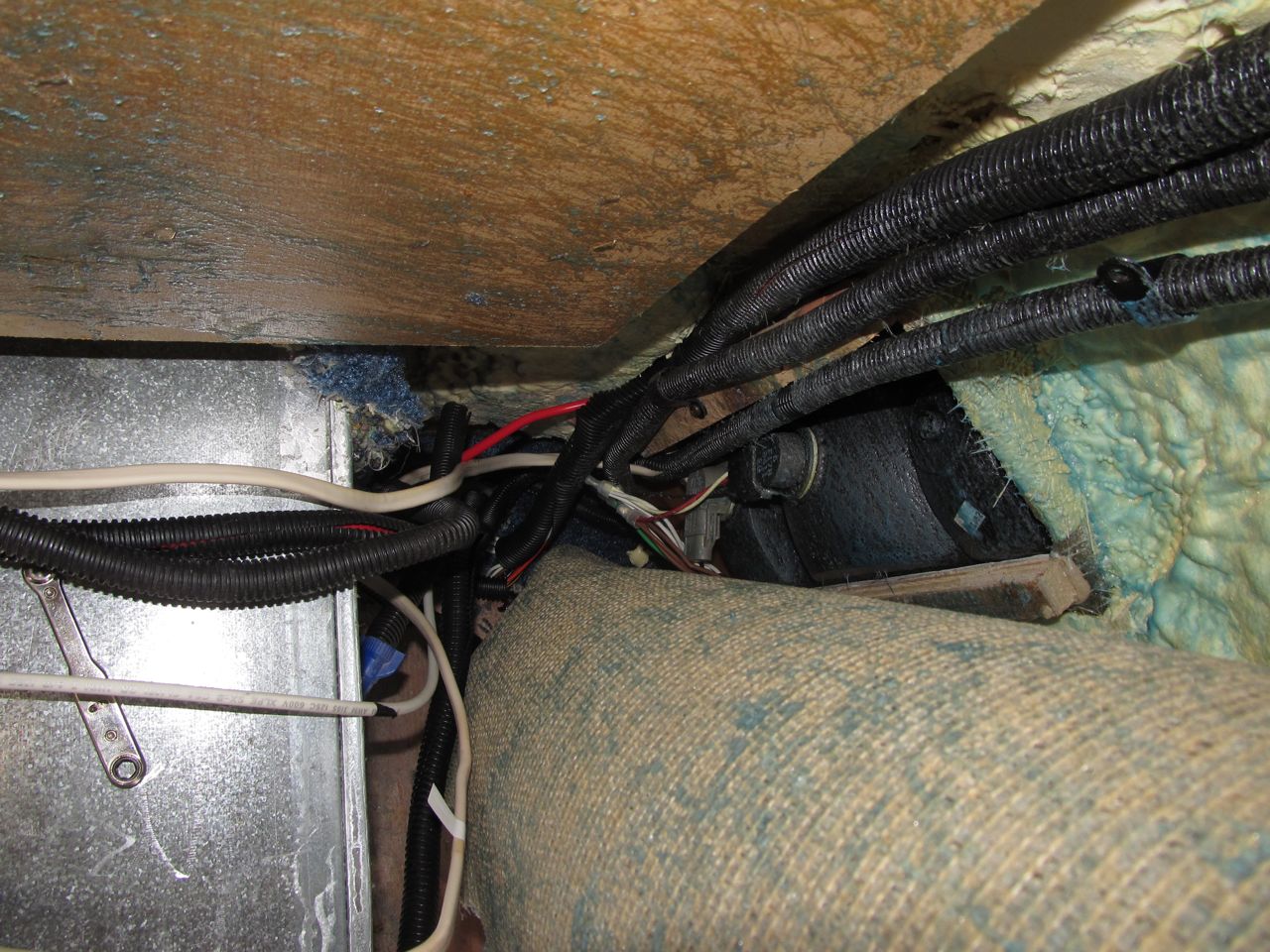

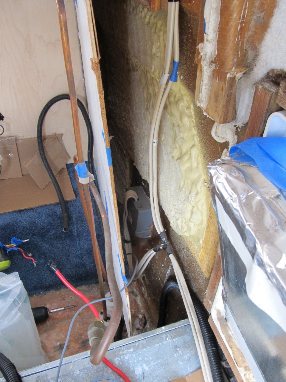

Next we have moved along over the generator box to the forward end, and are now behind the stove outside wall (just ahead of where it joins the refrigerator outside wall). The AC wiring has now moved along over the generator box (leaving behind an outlet for the refrigerator to plug into on the outlets circuit), and is going to head up the wall, with the outlets circuit making a stop at the exterior outlet before continuing on.
You can ignore the piece of black "loom" on the left (in the stove area); I think that's the refrigerator drain that I have moved aside. You can also slightly see where the two propane lines come up through the floor (normally behind a false wall that's outboard of the oven). The bent one (used to) go to the fridge and the straight one goes up to the range.

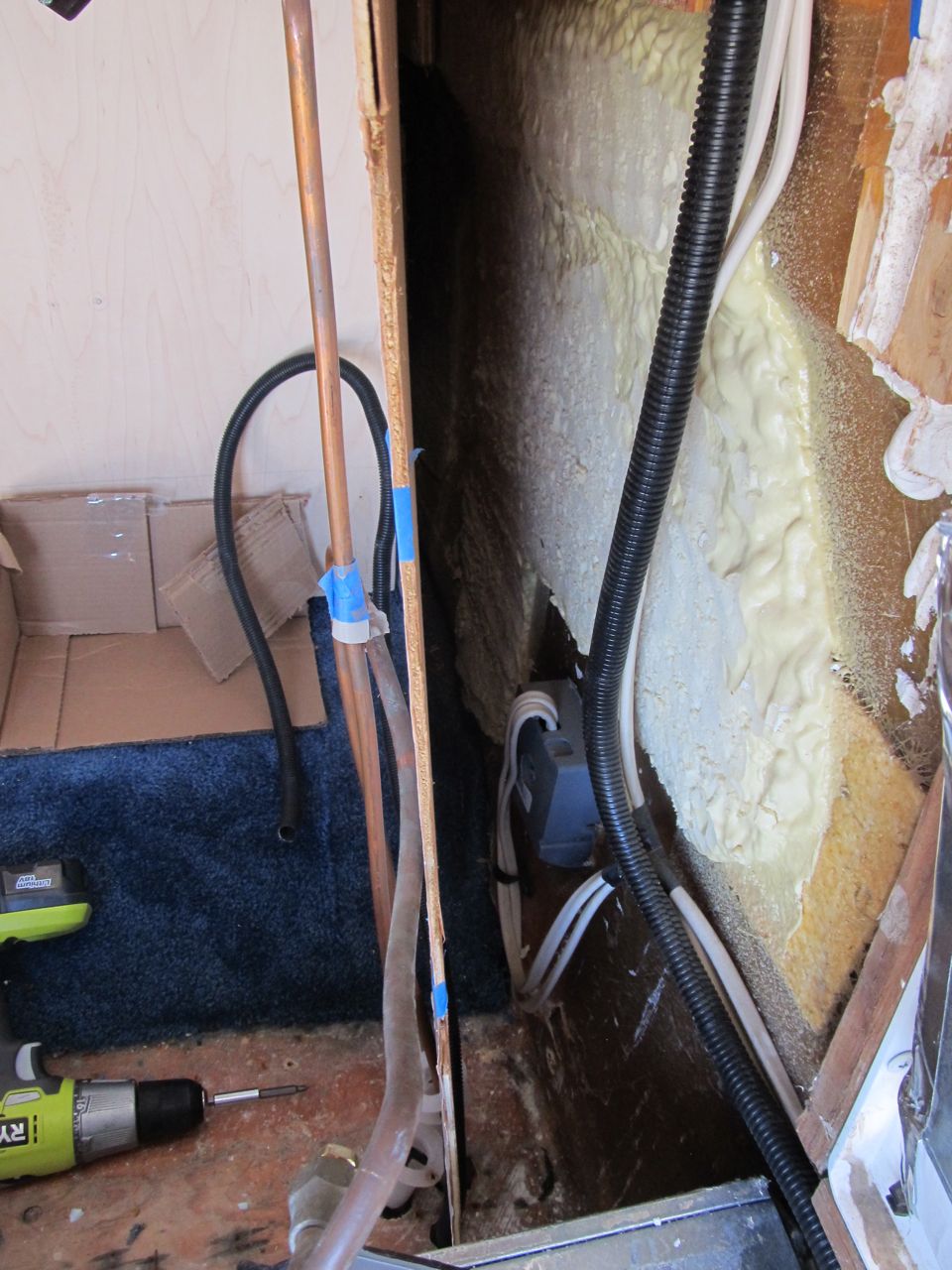

Here is another similar view, but since they are both a bit roughish, I figured a slightly different one might be helpful. Now you can also ignore the red wire - that's the 8 gauge DC wire that powers the DC portion of the refrigerator (I have pulled it over to this position - normally it's above the rear/outboard generator box, where it connects to the refrigerator).

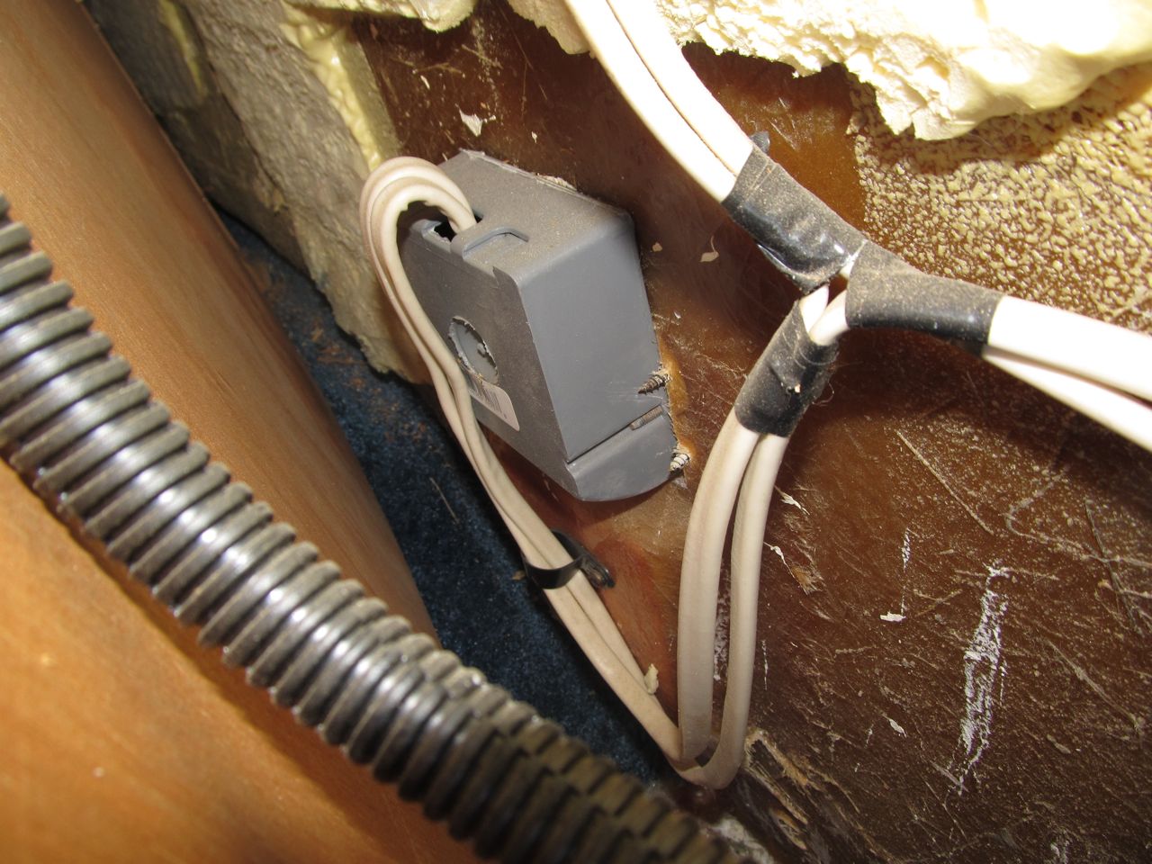

And here is a close up of the back (inside) of the outside outlet. The single black loom looking thing is the stock refrigerator drain tube. It goes out through the floor by the propane lines, IIRC.

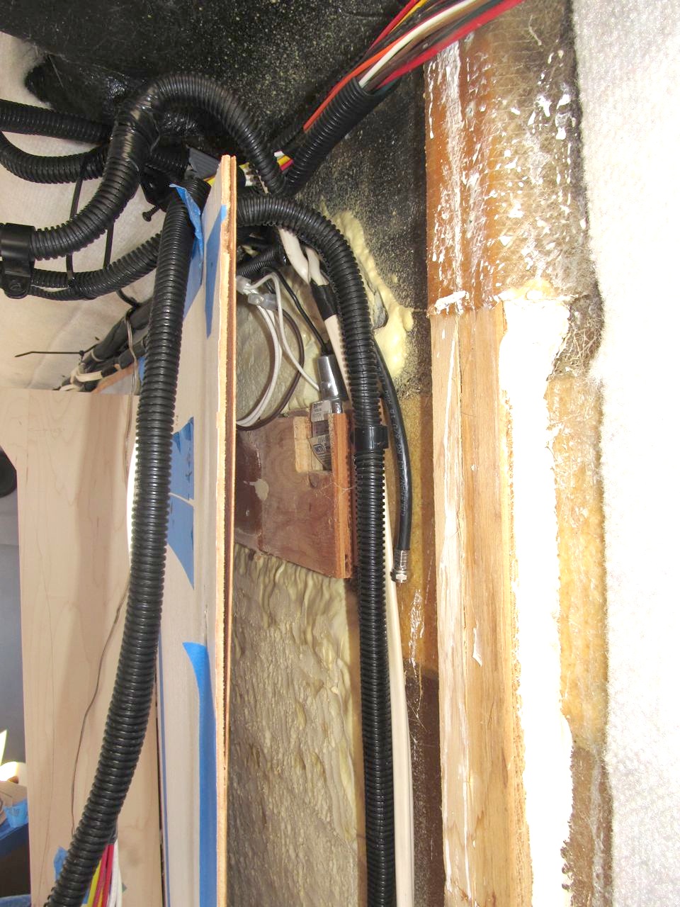

And lastly (if anyone is still here ), here is a shot of the top of the behind-stove-wall area. The wall is pulled out slightly to see behind. It looks like kind of a jumble, and is hard to make out, I realize.
There are the wires coming up from below. For reference, that "board" with the square cut out of it is the allowance for the rear (inside) of the "porch light" under the awning. Then when you get into the heart of things up top, there is the Air-con wire leading to its junction box behind the microwave, the microwave outlet feed wire, and the wire going to all the rest of the outlets.
You can also feast your eyes on the somewhat, shall we say "whimsical" application of the insulation foam. This is similarly inconsistent in every Chinook I have seen. Maybe it should be "Cool Autumn Day" foam and not "Arctic Foam." I plan to supplement with either some Thinsulate automotive insulation or some Armacell wherever practical. That said, I try to stay away from extreme hot and cold weather, and I don't expect a four season type RV. It works out okay for me as-is, but a little supplementation where reasonably easy to install won't be a bad thing.
