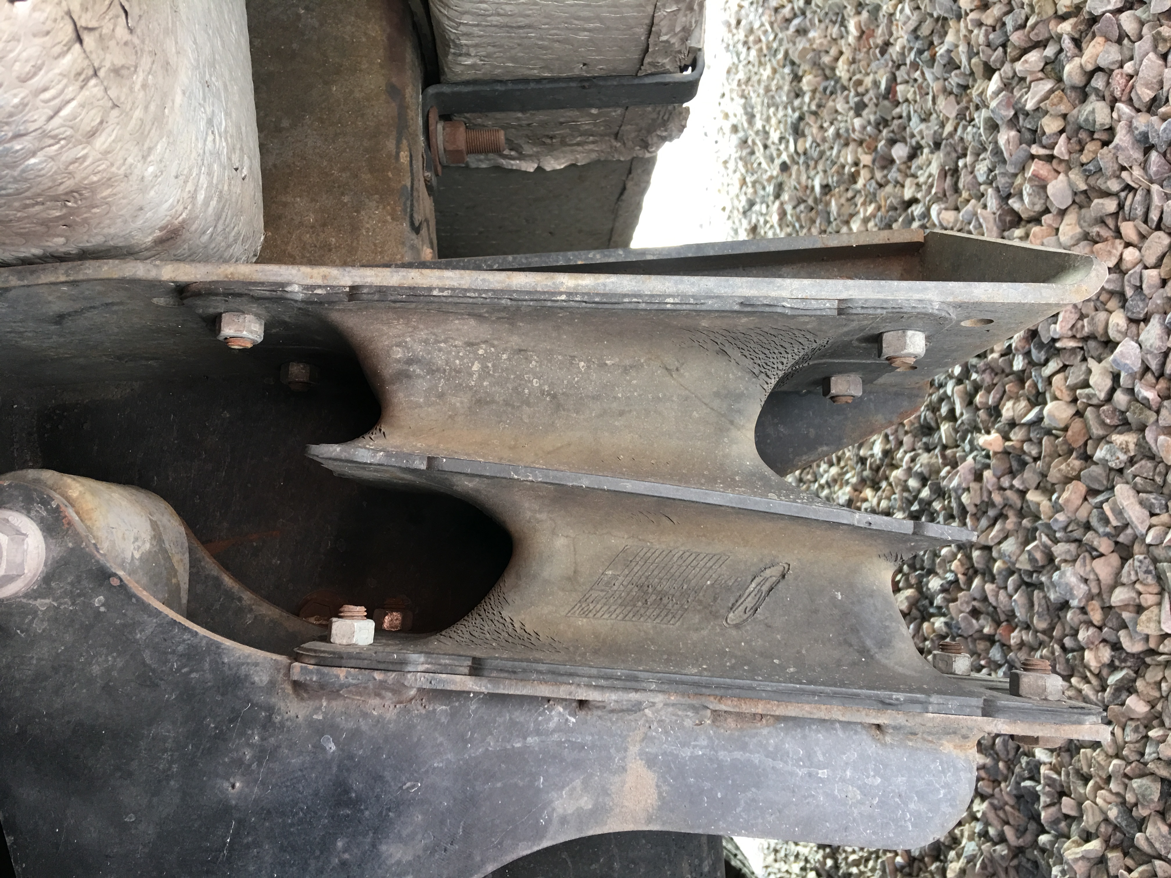

For what it’s worth, here are some dimensions with the picture I supplied in correspondence with MorRyde to get replacement cost & P.Nos. The attachment got posted sideways for some reason.
MOUNTING PLATES
* driver and passenger side units appear identical
* front / rear mounting plates = 5” wide x 10” tall
* width at midpoint of “sandwich” = 4 1/2 ~ 5”
* sandwich inner plate = 5” x 8 1/2”
BOLTS
* grade 5, 1" long by 9/16" hex, coarse thread
* 4-hole pattern front / rear plates = 3" x 9"
* 3/8" hole diameter
RUBBER BLOCKS
* Stamped BAR 75
I was informed these are the DSR rubber shear spring block #75 rated for 9001 - 12,000 lbs. GAWRR but don’t have replacement cost and part nos. yet. They will ship direct.
BTW, my mounting bolts don’t have lock nuts and were rather loose. I would recommend new bolts with blue Loctite next time.

Anyone know what is the stamped number on the Moryde means? Mine says "10" but I noticed that Rokover's says "75." I was under impression that each number identify with a specific model of spring. I am going to call the company and see if they know which one to send me.
