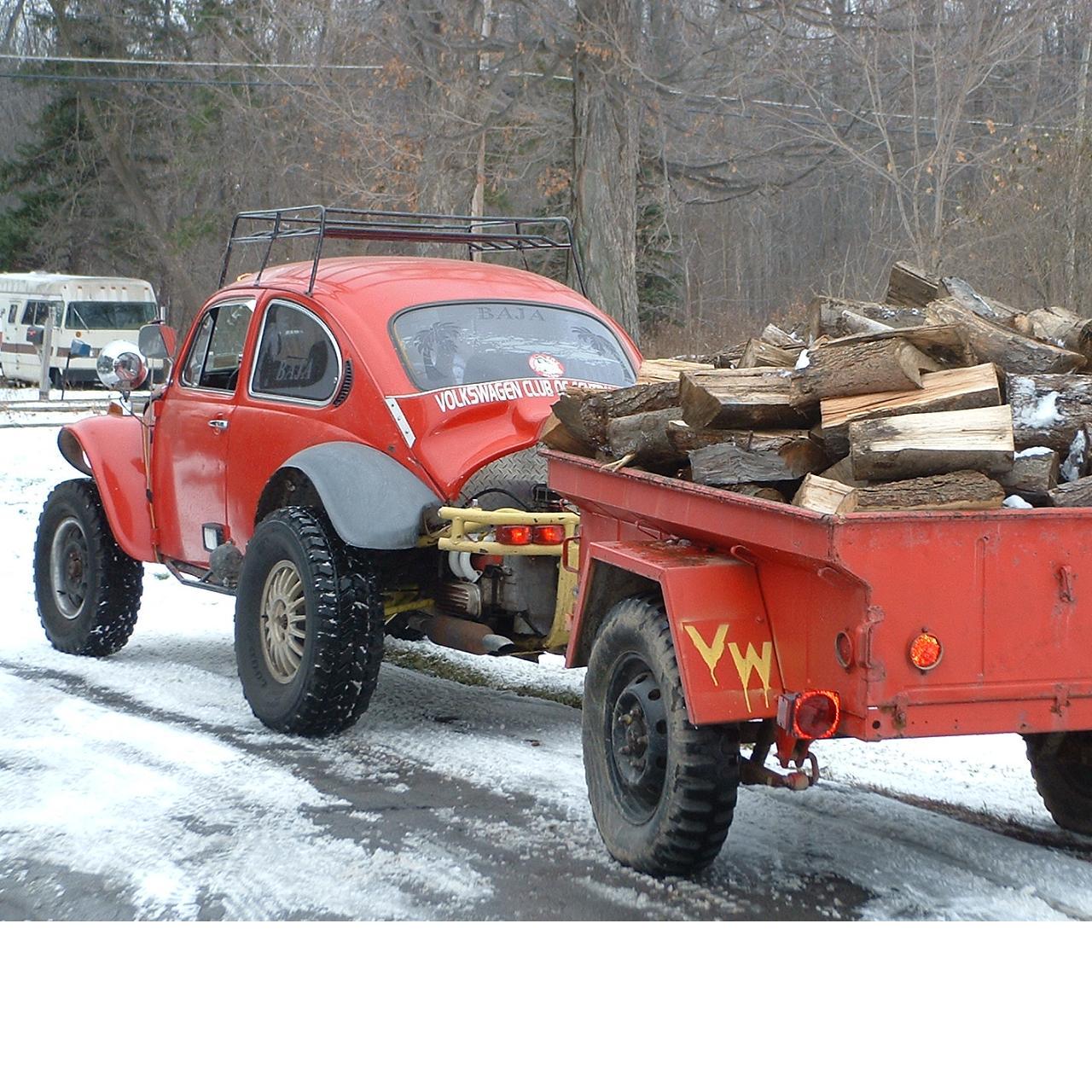

I'd think you could mount some kind of rack/storage box above the rear bumper area? I'm not quite sure what it looks like on the side door model?
Or just rethink your order of towing...
