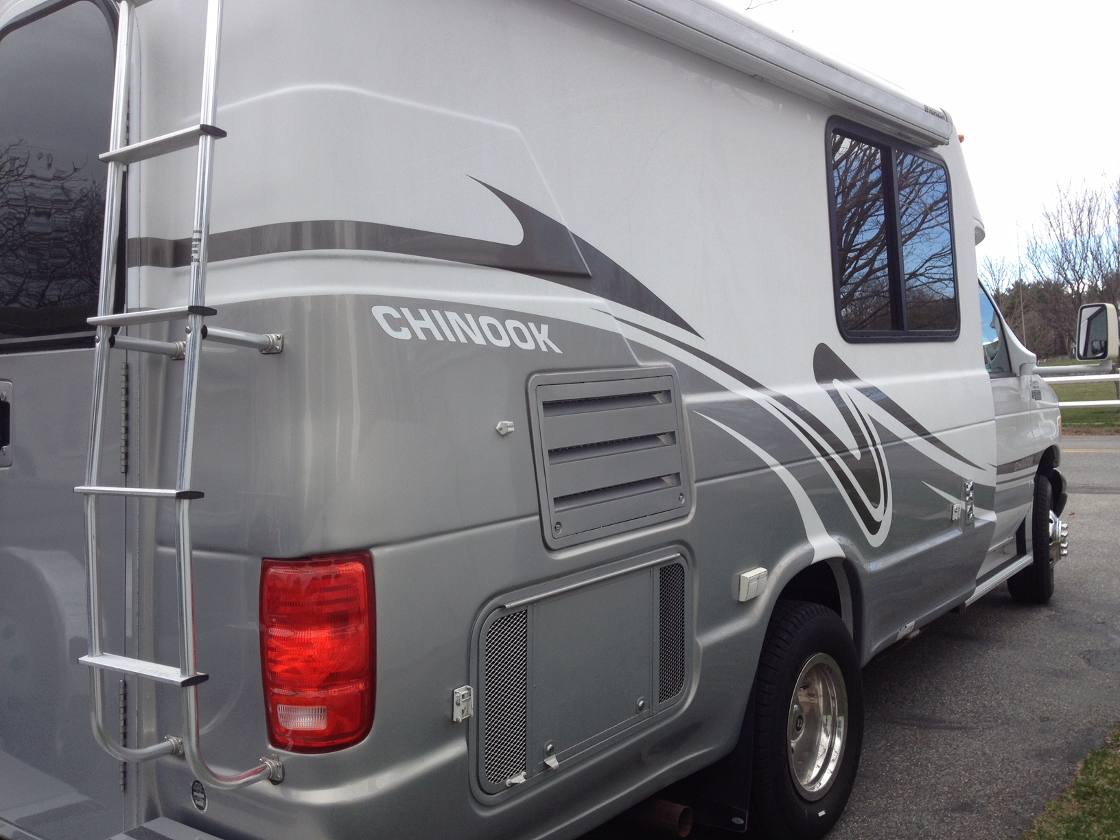

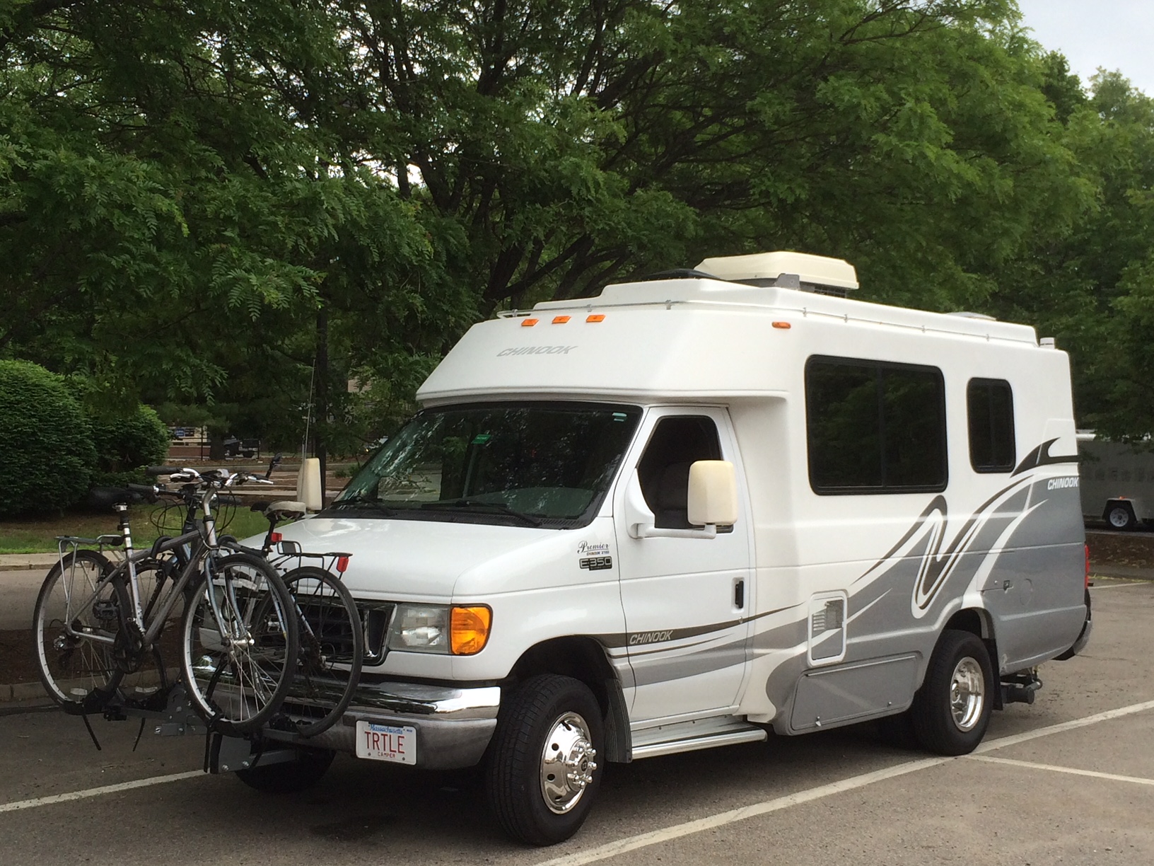

Here are some pics of what Turtle looks like, shined up and ready to roll.
