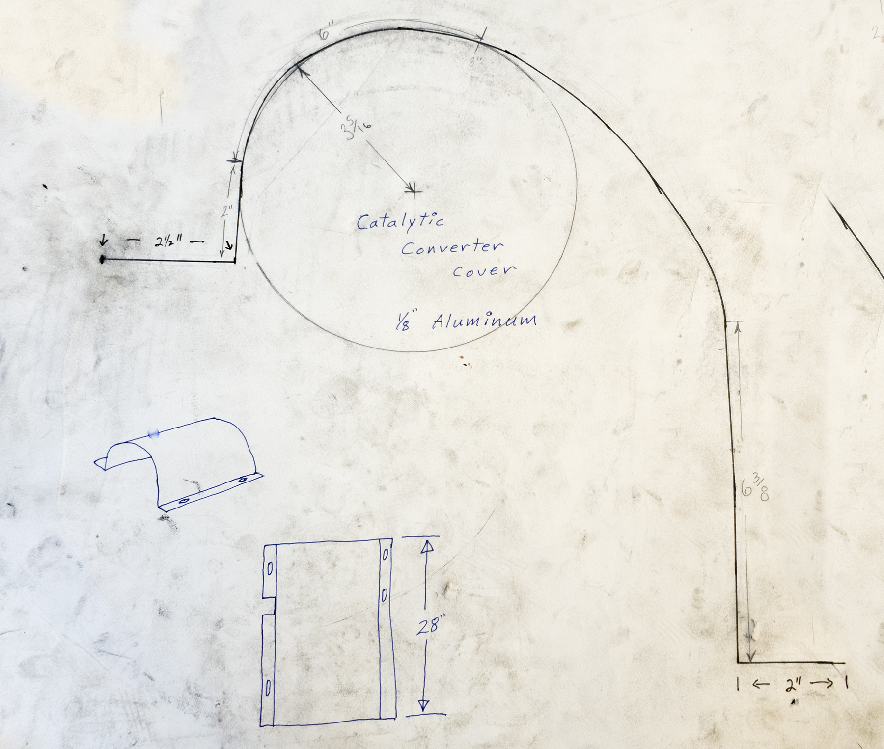

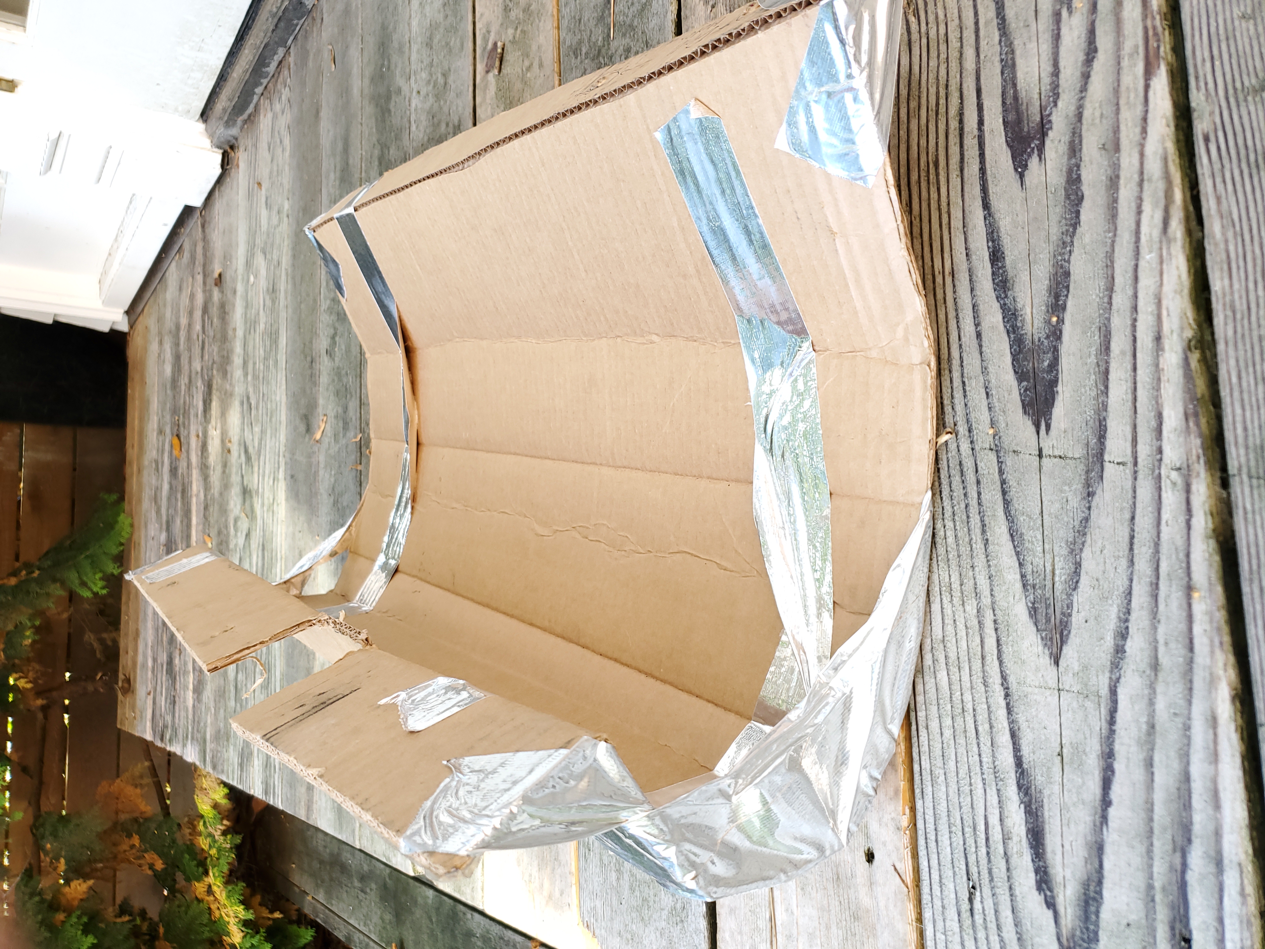

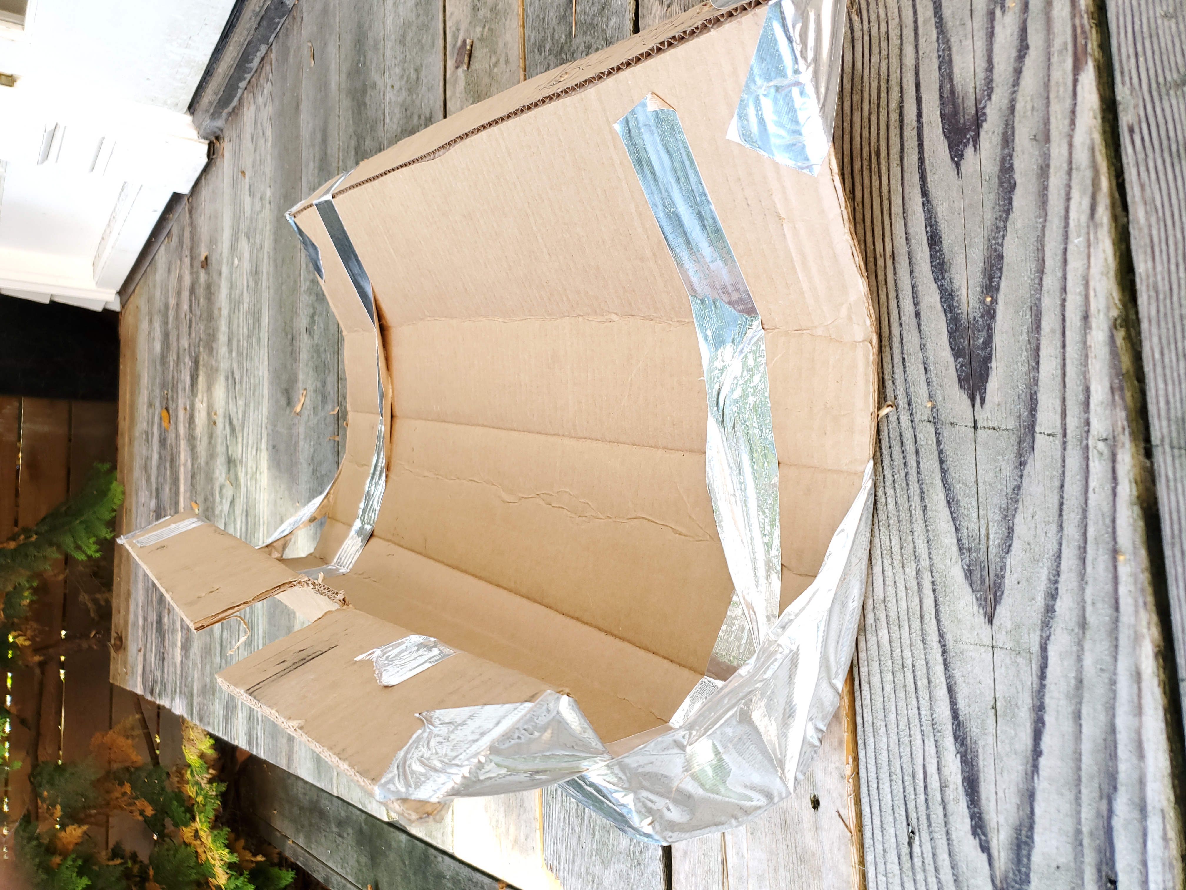

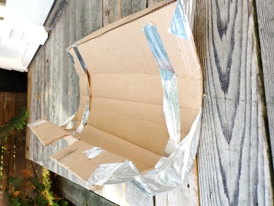

Looking under the rig, it's totally exposed. After the replacement, I was totally paranoid to leave it anywhere, so I set on a project to create my own CATALYTIC GUARD SHIELD. They sell them on Amazon for Prius and Honda Elements, which are favorite targets, but nothing for our E350 V10.

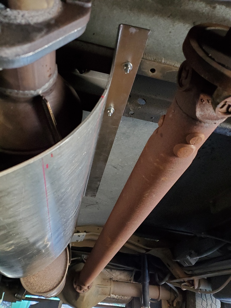

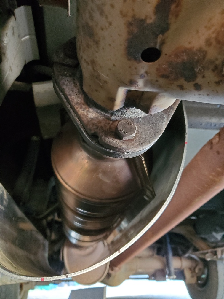

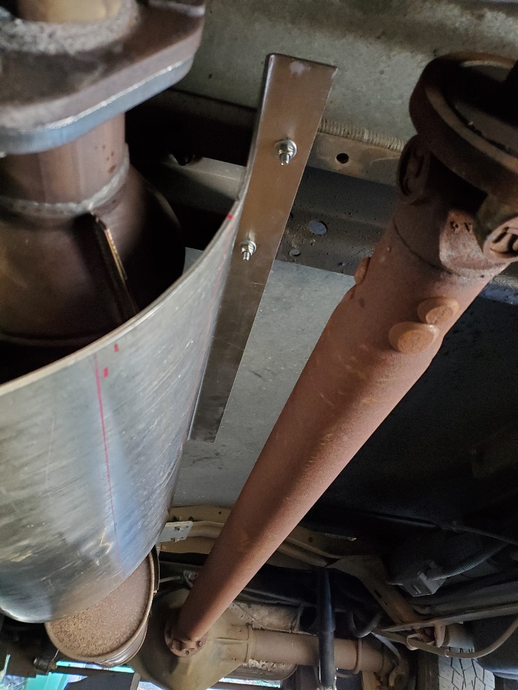

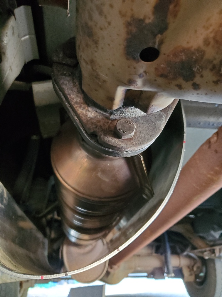

So... I spent an hour under the rig, fashioning out of cardboard and duck tape a mock-up or template of a shield that could be easily bolted to the frame, and would block access to the catalytic converter. Then, I took it down to Georgetown, which is an industrial part of south Seattle, and shopped around at welding and metal fabricators shops. Found one that fabricated the shield following my template, out of 1/8" aluminum sheet. Then my son and I bolted it under the frame. Now I sleep peacefully.
If anyone would like some photos of the setup, I'd be glad to share.

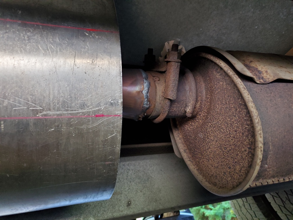

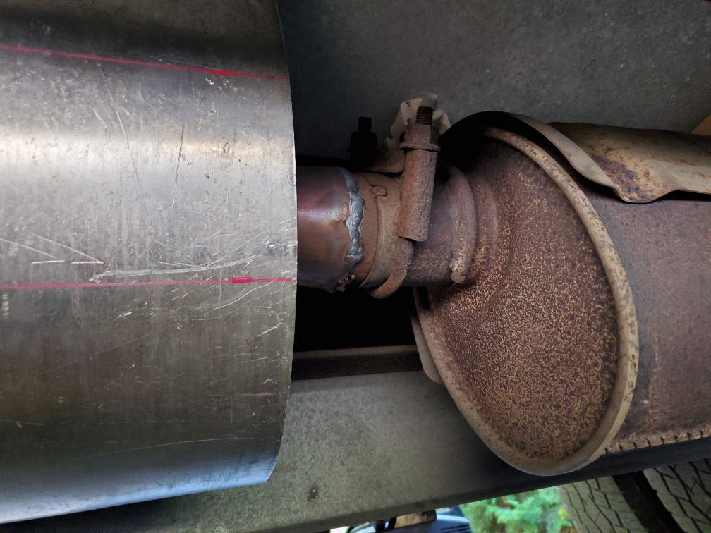

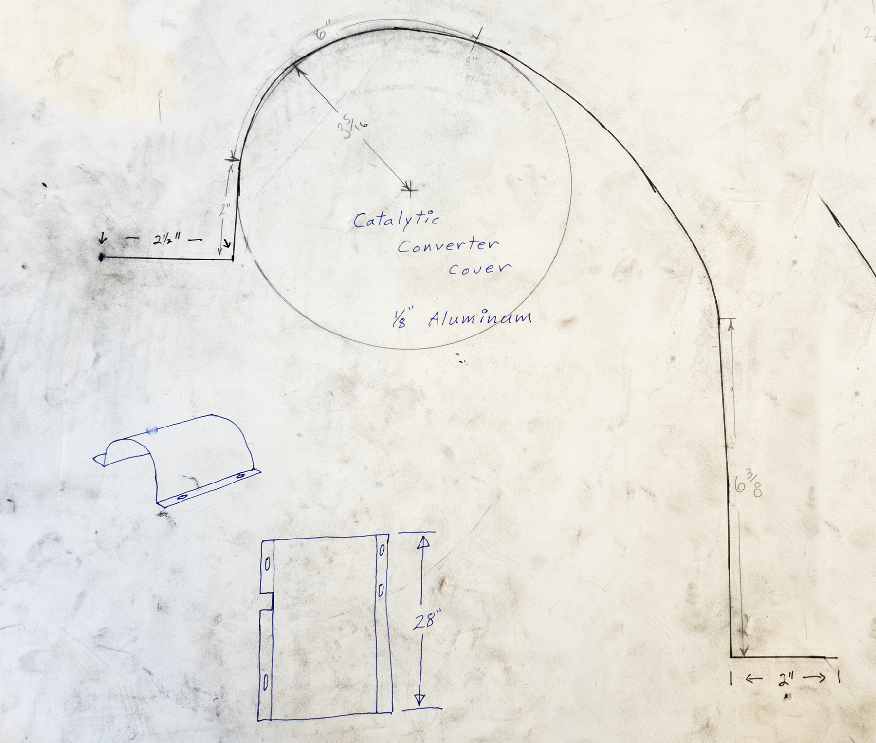

OK - here are a few pics. The most useful one is probably the blueprint. There's also a pic of the cardboard template I made (ignore the duct tape), and shots of it installed. I paid $400 for a sheet metal fabricator to make it.
Everyone's under-chassis may be different, so do your own research!
For some reason, I don't seem to be able to attach more than 2 pics at a time, so posting more next....
