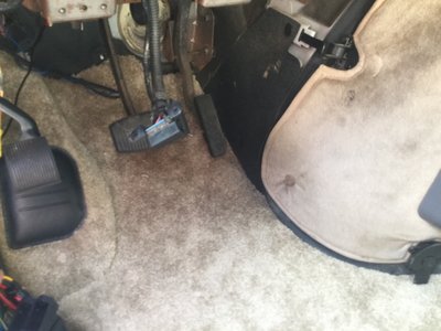

Remove your old carpet. Wear a Hazmat suit :lol:
Red arrows show the rear seat studs, green arrows show the front Torx bolt holes and the yellow arrows show where the plastic foot well clips insert into. There are two others not being shown on the bottom of the actual foot well that go into the body.
Give it a good vacuum, there will be lots of sand and dirt.

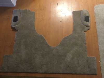

Obviously, buy new carpet. I found a 8'x10' area carpet for $50 or so. Lay out your old carpet on top of the new and trace your pattern. Do a good job here because the tolerances in some areas are tight like around the doghouse where there isn't much room to hide a mistake. Use a sharp Xacto knife and cut from the BACK side and not the front. The front fibers will prevent your blade from cutting cleanly, the harder and smoother back side will not. **WARNING** Be very careful how you trace your carpet and which direction you face it when tracing.
Step Five
Test fit your freshly cut piece in place. I gave myself an extra 1/4" around the perimeter for some safety and felt trimming it after it fit okay was a good move. You will notice there is no carpet for the wheel wells at this point...keep reading!

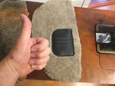

Remove the carpet and bring it back inside after you feel it fits well. Remove the old wheel well carpet pieces from the old carpet, it is roughly sewn together and easily cut with a knife. Trace and cut out matching pieces. If you want perfection, cut the stitching from the rubber foot pads and remove those as well from the old carpet. Mock up pieces in their correct orientations.
Step Seven - Optional
Restore your Grandmother's 1956 Singer sewing machine and teach yourself how to sew. I've done a few past projects with it, it's lovely to work with. Forget how to thread a bobbin, spend 3 hours getting frustrated. Realize you have the wrong bobbin. Thread the bobbin and have it work perfectly again.

Layout and sew your foot rests to each wheel well cover.

Not too bad but a day for sure. Forgot to add the layout and tracing photos. I did this step wrong and cut out my piece backwards. Make sure you place your old carpet over the new carpet and face them both forward. The doghouse on the Econolines are offset and if you cut it with one piece of carpet facing opposite to the other, your final piece won't fit. Luckily, my 8x10 piece had lots of spare... :oops:
