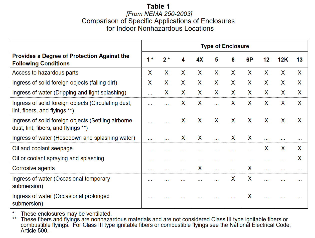

yeah, the 20 years old outdoor outlet is not meant to be satisfy the NEMA requirement for water intrusion. Only NEMA 4, 4X, 6 and 6P can deal with that. I don't think they even make small outlet cover that have these rating types. Let me know if any of you come across any.
Edit:
OK, I am wrong. Apparently, there is this Leviton 80W07-D that is rated for NEMA 4, 4X, 12 IEC IP66. Anyone want to paint their Chinook yellow? :lol:
