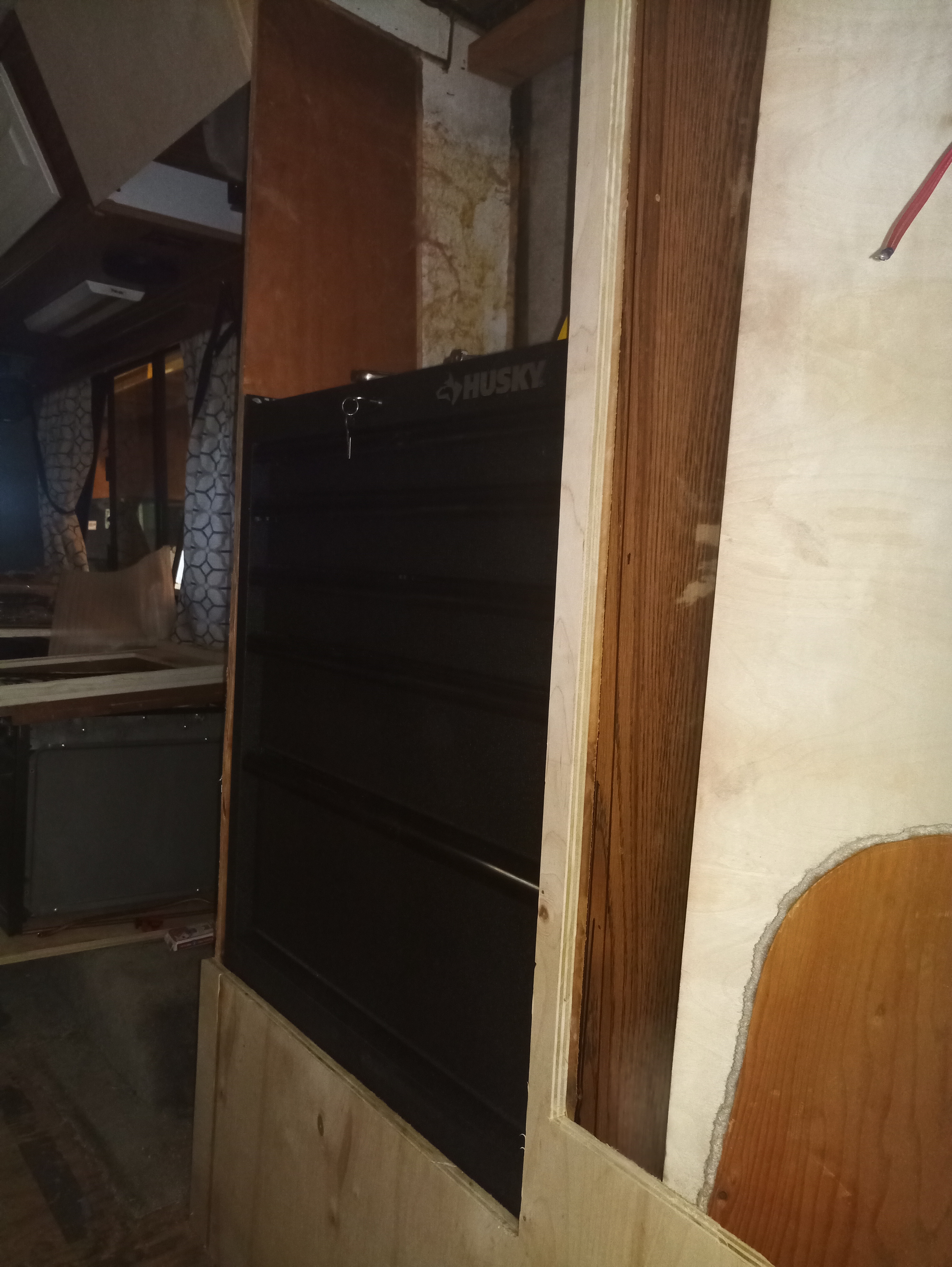

I was feeling pretty lazy today so not much more progress. Any bit of progress is good though. Where the old fridge used to be, I had said I was planning on installing drawers. My woodworking skills aren't all that great. Plus I don't have access to precision tools. No table saw or miter saw, just a mini circular saw from harbor freight, some squares, and measuring tape.
Before I bought the chinook, I was seriously considering buying a 5 window school bus with a 7.3 power stroke and building it out. I didn't go that route because of the price of building supplies right now, plus I really like the one piece fiberglass she'll of the chinook. But, one of my plans for the school bus did get implemented into the chinook.
I absolutely love tool boxes. I think they are beautiful and functional. So...where the fridge used to be I have installed a husky 5 drawer tool box. Nice soft close roller bearing slides, and the black looks nice next to the light Baltic birch plywood.
Is this look for everyone? Certainly not, but it's perfect for me. It has that industrial look I love and it saves me the trouble of having to build drawers. I still have to add the face frame on the left side of the box and build out the top of the compartment to cover up the vent but that's a project for another day.

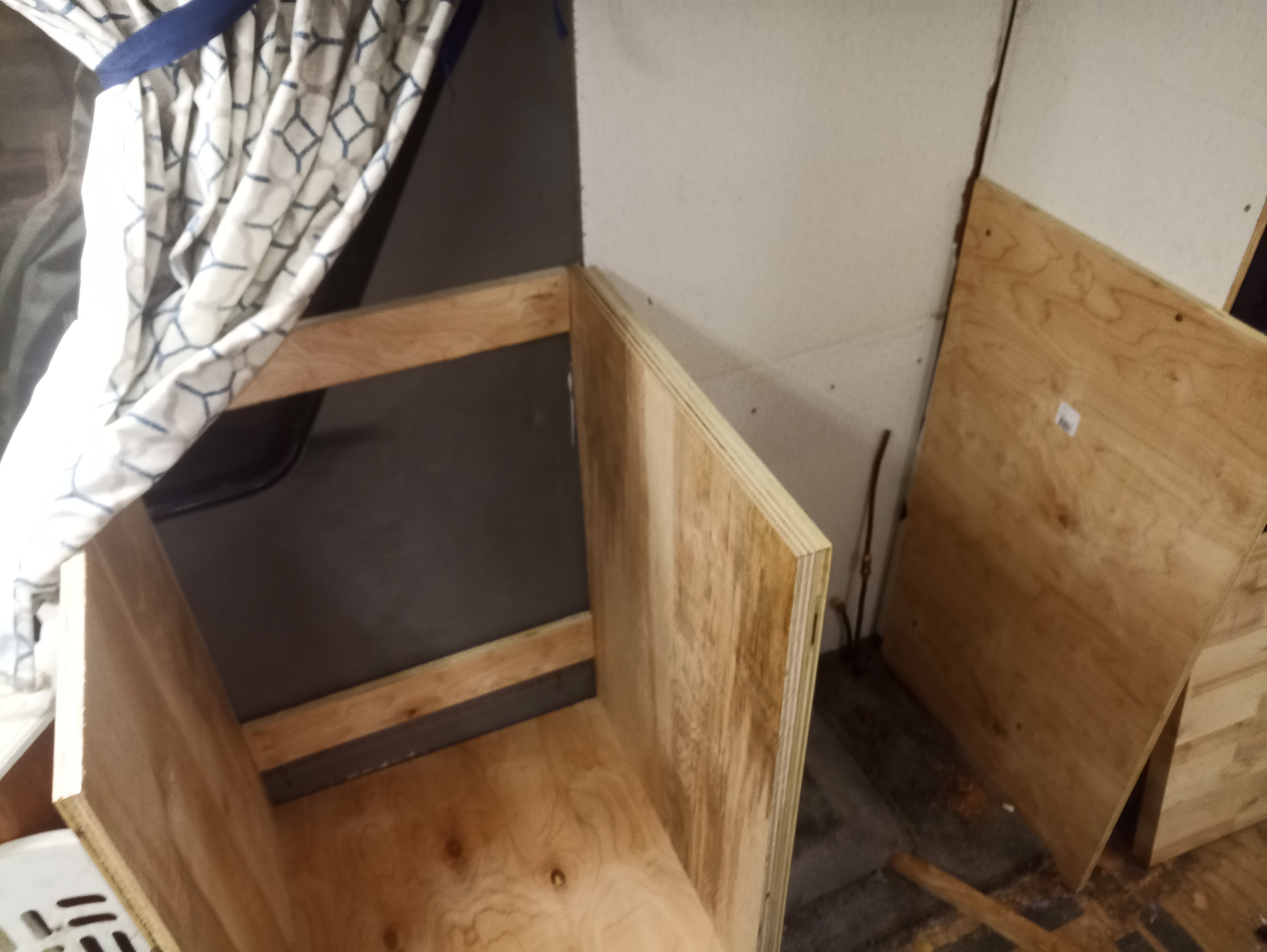

I got some work today. I started off by building the cabinet boxes for the stove and refrigerator. Once I had the boxes all together, I was able to put the butcherblock counter top on and figure out how it needed to be cut. Cutting the butcherblock was scary. Any mistake here would prove to be a $100 mistake. All went well though.
Next step was to start cutting some face frames. I got the vertical face frames cut, but I also cut my finger pretty good so I stopped here for the day. I'll pick up where I left off tomorrow.
I made some pretty frustrating and annoying mistakes. First one I made was I cut the cabinet box sides about 3/8 of an inch too short by forgetting to account for the hinge on the fridge door. You can see in the face on picture the method I used to fix it. I notched the underside of the counter with a oscillating multi tool about 1/2 of an inch. Unfortunately this isn't nice to look at. I'll just have to deal with it because I am not buying another sheet of plywood or another counter top.
Another mistake I made. When I removed the lounge chair, I made a plywood box exactly the same size as the seat base. This unfortunately ended up being too big and stuck out from the cabinets. So again out came the oscillating multi tool. On the front where the face frames are, this doesn't really matter, it's hidden. On the side of the cabinet, this is painfully obvious. You can see the seam where I cut the plywood. I'll probably put some towel hangers on the side of the cabinet to cover up this mistake.
