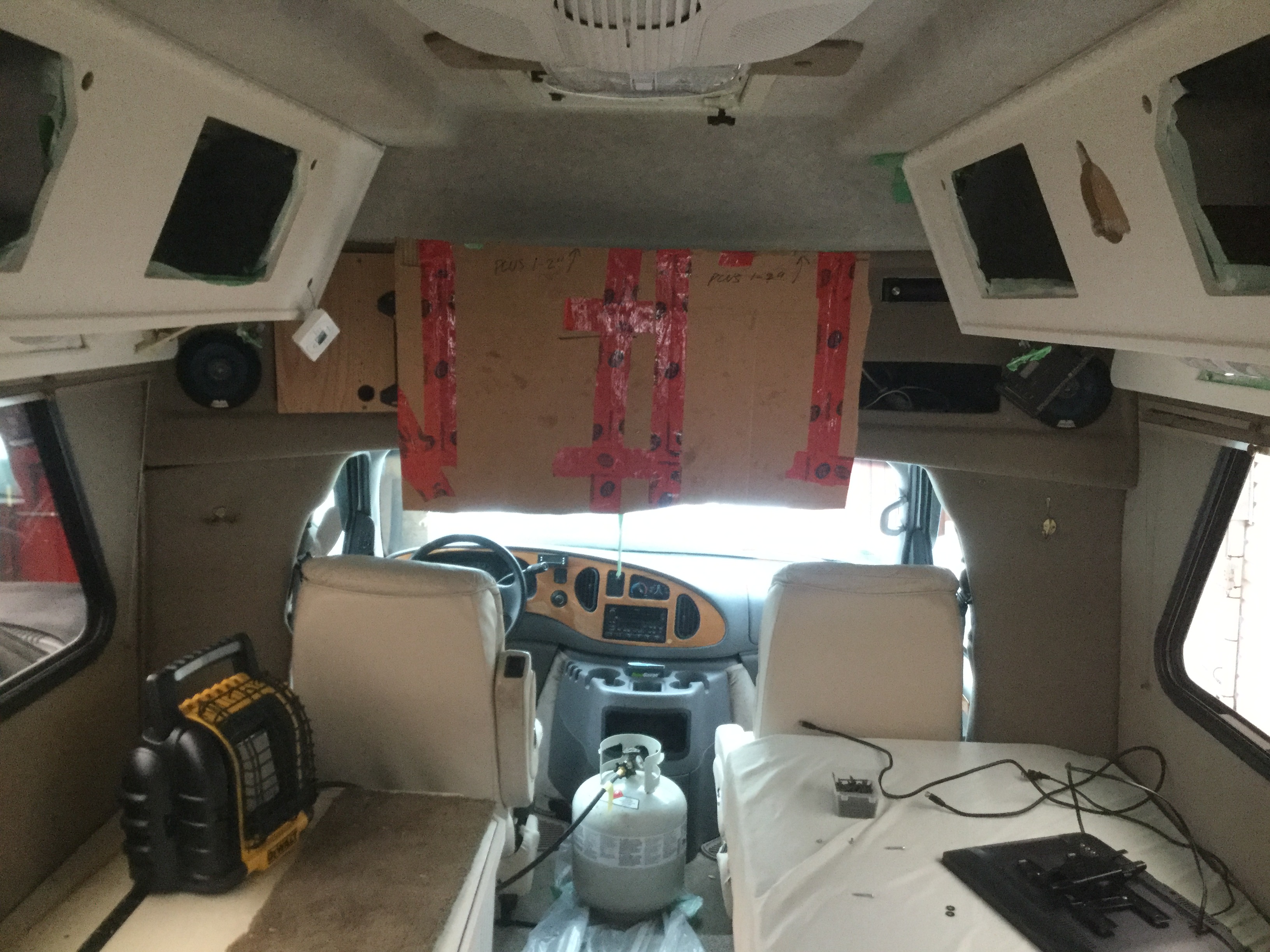

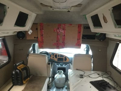

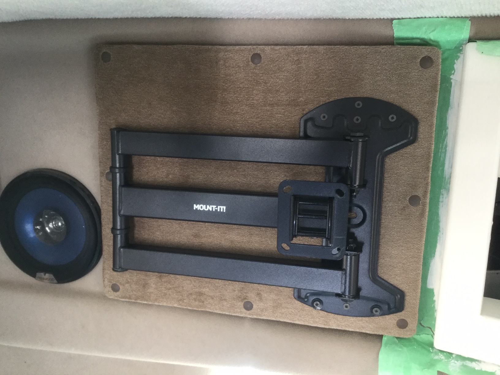

Decided to add a photo to this thread in case anyone was doing a TV upgrade...Made a plywood backer board for the 24" extendable TV mount. Upholstered it with old seat back material that was clean. Drilled and screwed it over the old TV hole and mounted the bracket tight! This can hold the old 19" TV in place or the new 40" that will be stored in the overhead cab with a quick mount bracket. In any event, it is ultra rigid and should handle any weight thrown at it with ease. Brown screw head caps camouflage the fasteners as well as anything...Cardboard mockup shows the 40" size...
