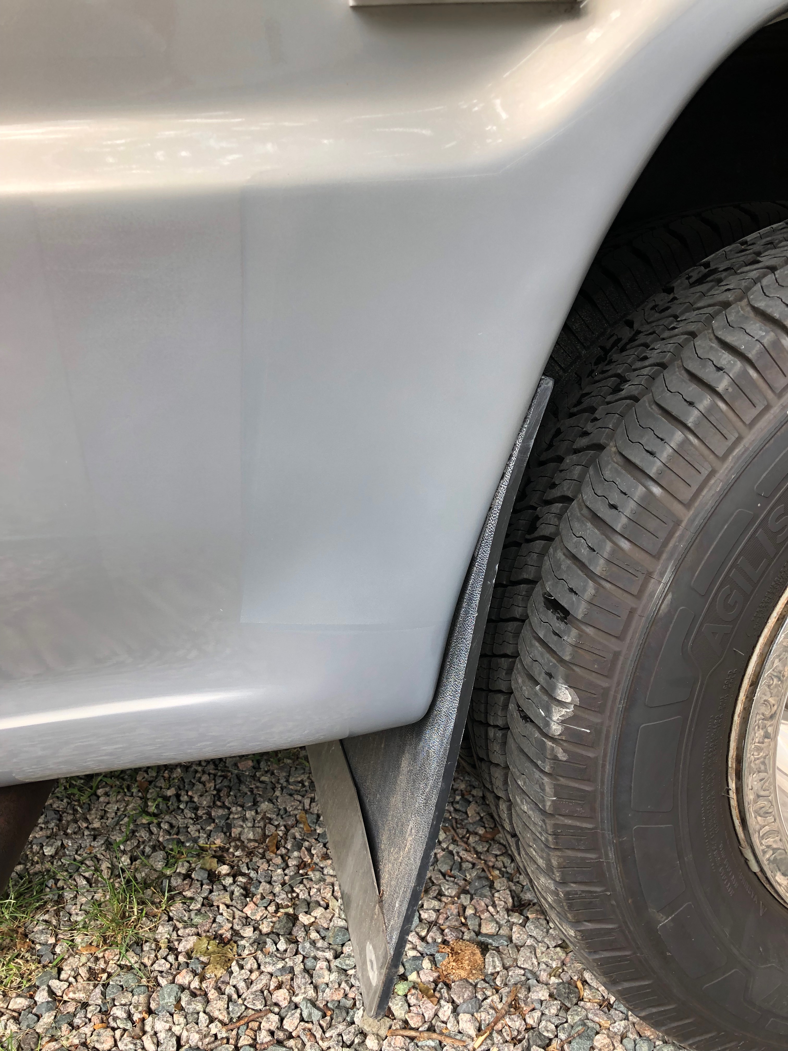

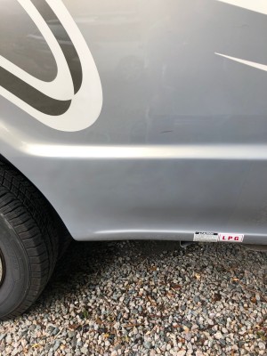

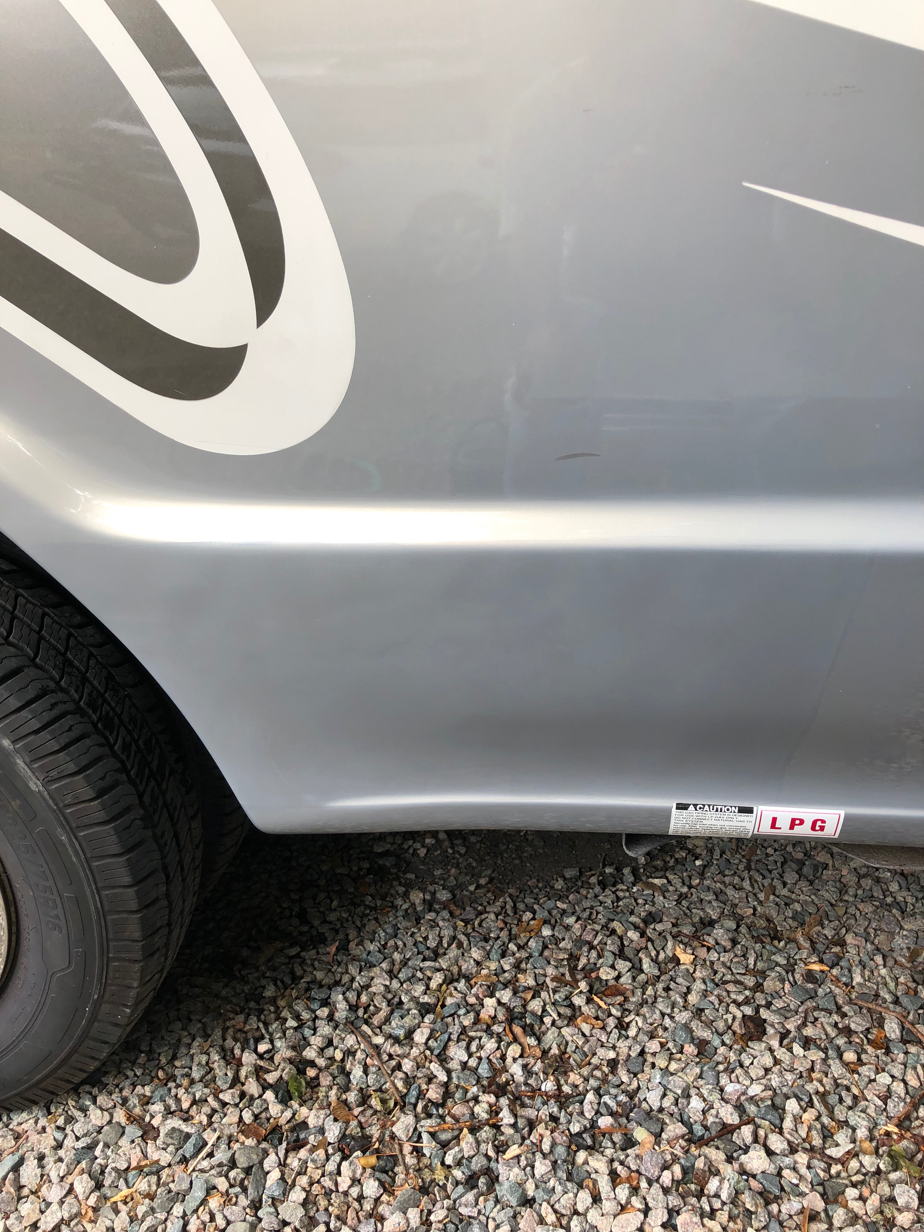

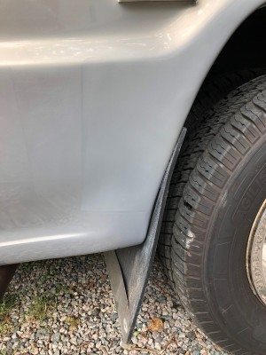

So, as promised, I'm circling back to report on the fiberglass repair I did on the lower passenger-side panel back near the rear wheel well. I'm totally happy with the patch itself--done using just gel coat to fill the scratch. It came out smooth tapers well to rest of the panel. I then sprayed a light grey undercoat, followed by a spray can of custom grey color coat, and finally several sprayed layers of clear coat (yes Chinnin, you were right--the clear coat was definitely needed...never should have doubted you!). I then used Griot's Garage Complete Compound to buff it all up...I was looking for a Maguire's product, but couldn't find it close by. The Griot's worked fine...clearcoat buffed up pretty well. That said, the color match is not perfect, so you can see a slight color line between old and new where I had taped things off (that's the consequence of not doing the entire lower panel (which is why the professionals wanted to charge me $1900 for the job). Oh well. It is well protected, and doesn't look too bad. I'll wait a month before taking it to my usual detail guy for a professional application of wax, as suggested. I'm imagining it will get less noticeable with time, not more. So--bottom line, I can definitely live with it...gonna think of it as the sort of beauty mark that comes with age and good use! Pics of what it looks like now attached.
