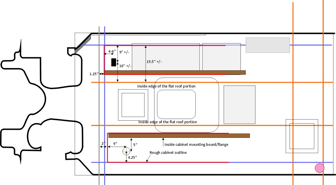

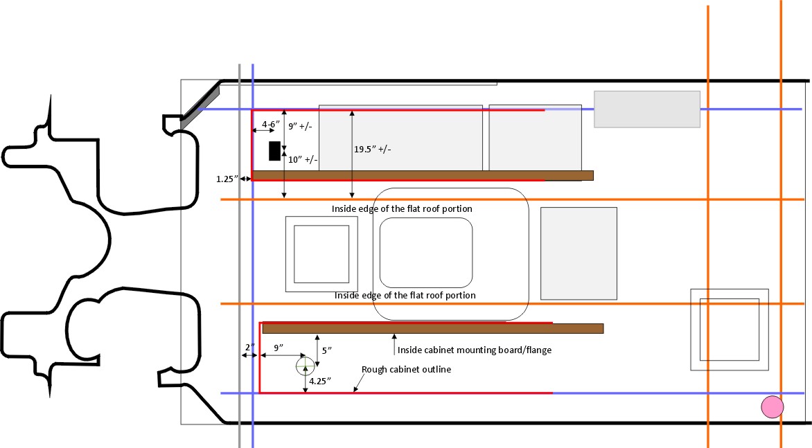

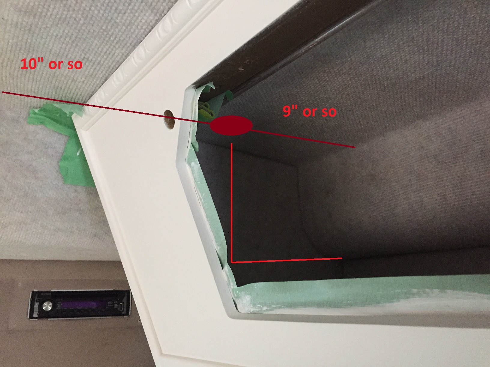

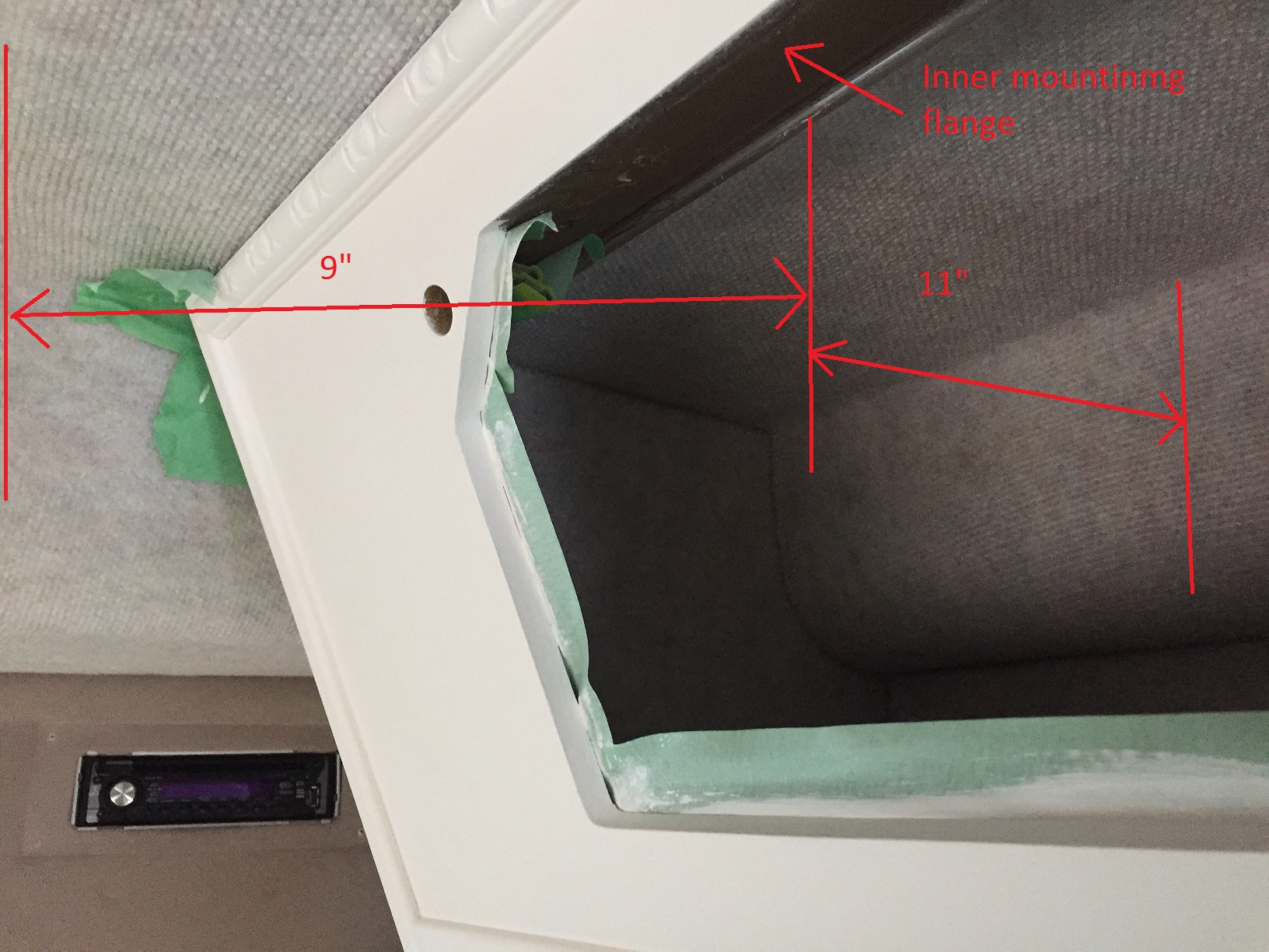

Now when looking at the roof, the antenna is well over to the left. Inside the upper cabinet there is a mounting flange that bolts the cabinet to the roof and is a few inches wide. The distance from side to side between the middle of the crank handle and the edge of this board is 5”-5.5” inches. When you take into consideration the diameter of your hole cutting tool, it gets reduced to about 5” plus or minus so that is the approximate width over I can go towards the middle IF I want my entry gland to be centered on the flat section of the roof.
We know that out top flat panel is right at about 18” wide so if the antenna is 4.25” over and the inner cabinet has about 5” of available width, then 9” over puts us right in the middle of the flat panel for our hole in a perfect world and the wires should come down right behind the front panel on our overhead cabinets.
It will be close but the gland should be centered from side plus or minus and inch or two at the outside. These are just preliminary measurements to get my head around where the hole will eventually will go. It just dawned on me that the angled front of the cabinets will prevent your drill from being 90 degrees perpendicular when drilling from the inside out. You will need to keep the drill away from the edge and in towards the middle in order to keep it square. If you drill down from the roof, then I guess it’s a non issue but I think I’d rather drill up and know I was safely inside the cabinet rather than hoping I was or hitting an edge of the moulding or something like that.

I don't think it will be perfectly centered but I guess that's okay. It might be off by an inch or so but there isn't a ton I can do at this point until super accurate measurements can be taken when the snow is gone! This at least shows reasonably close to where it will be. The 90 degree angle shows the drill potentially touching the angled face of the cabinet and how it is in relation to where the hole can be cut or if it has to be moved outwards so the drill can fit in there. The length of the drill bit will also impact it's ability to get tight to the cabinet.
I've already got a headache
***These are rough estimates only, not to be used as accurate cutting guides for putting holes in your roof just yet!!
Blue's sketch shows a length front to back of 80" total. Both my panels are 66" in total length and with a gap of 3-4" between panels so I can access the edges if I need to, that only leaves about 10" of length to situate the gland up front so the hole had better be accurate!

Couple of thoughts:
1) Why is it important to have the hole centered on the panels? I usually try to make mine a bit off center, which makes for a neater run of the wiring coming from the panel junction box (it's kind of awkward if that is right above the hole). It also allows the extra wire to lay nicer around the edges of the panel when the panel is down (that is, the extra wire you leave there so you can tilt the panel up for servicing, cleaning, re-bedding gland, or whatever).
If you aren't sure exactly where to drill, but are close, what I would do is drill a very small hole (1/8"). Then when you see where that comes out on both sides, you can adjust the location a bit if necessary since your ultimate hole will be larger.
Another thought is that for mine, I'm placing the hole near the forward edge of the cabinet. Then the wire can come in and run down that forward "wall" of the cabinet. Basically this copies the small hole left over from the TV antenna wire on the other side. That way you don't have to be up against the edge of the cabinet that is angled and is up against the visible living room ceiling.
It's not, only aesthetically pleasing
This would have been my approach
Agreed
