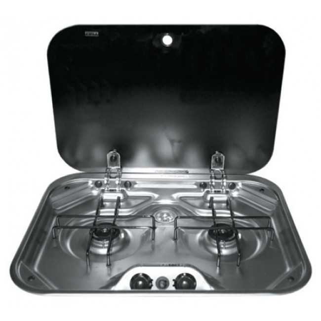

Yep... I'm installing this recessed, 2 burner with a lid (SMEV Dometic) which will be located on my new countertop which is extended to the closet wall (where the fridge was located). With the lid down it provides additional counter top space, in the up position, it's a back splash.

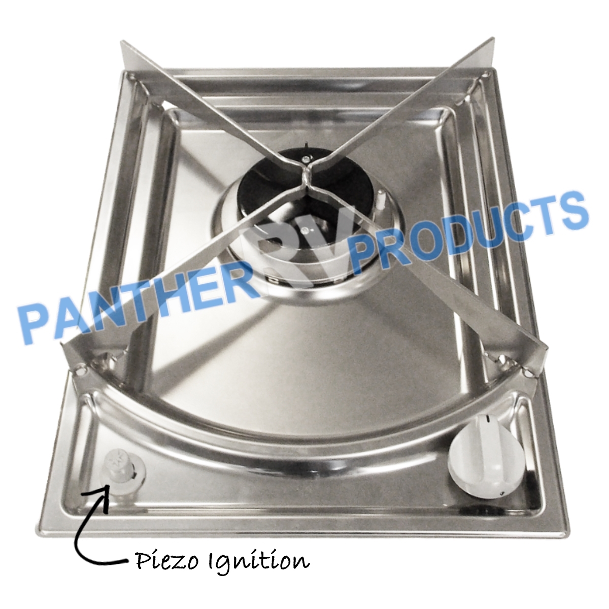

My list is as follows:
One-burner:
a) Smev one-burner

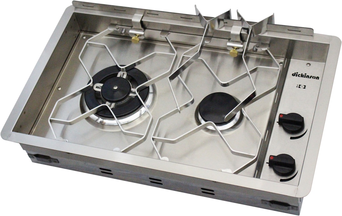

b) Dickinson drop in. It doesn't have a cover like the SMEV, but instead is recessed and has a cutting board that fits in the recess and makes it flush-ish with the counter top. The cutting board isn't in this photo but just imagine a wooden board fitting down into the trim ring. The pot clamps can be removed (more for boat use cooking underway).

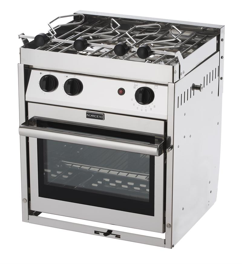

Just for completeness, here is one of the Force 10 two-burner ranges. They also make three-burner versions. Each version comes in like six different sizes (American Standard, American Compact, European Standard, European Compact, etc. etc.). They will all be valved to work fine in North America, but it gives one the chance to fine tune the width, depth, etc. because they are all slightly different. My buddy went with (IIRC) the European Standard three-burner -- and that fit just about exactly into the typical Attwood sized hole (if anyone is going to do this I can double check).
I like the two-burner as one of each size burner is right up front, and then the rear of the counter can be used for something else, and there can be shelves or a cabinet on the wall that are not above the burners. There would be some potential storage space behind the shallower oven, but nowhere near as accessible as if one went with just a cooktop, and then big, full-extension drawers (or doors) beneath the countertop. The pot clamps and rail can be removed, so the "claptrap" you see on top doesn't need to be there on an RV. Also, some of the sizes come with a trim kit for non-gimballed mounting (which we used to do my buddy's).
Oh, the best thing compared to the RV stove? SO EASY to light the oven. Just press a button and it lights (it uses a sparker with a battery, not the "clang clang" twist to spark type knob, and this sparker lights the oven as well). There is a "real" broiler element in the top of the oven. Bring on the toasted cheese!
Drat, now I'm talking myself into one of these again :lol: Well, I'll probably go with just a cooktop, but we'll see.

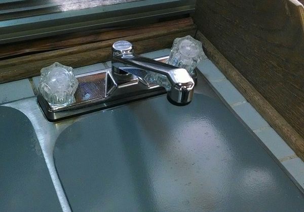

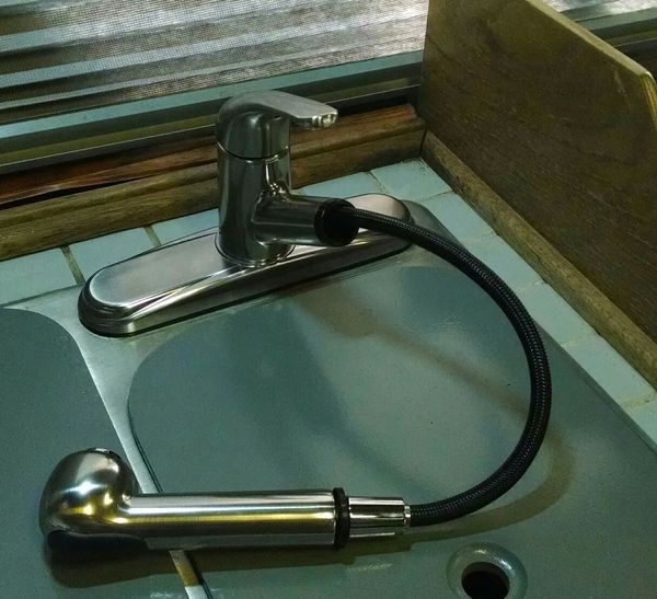

pdemarest wrote:I also want a faucet that includes the handheld function.

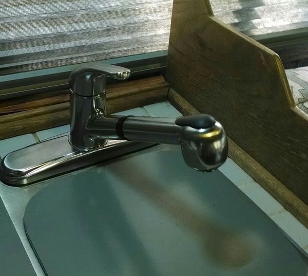

Speaking of which, today I swapped my stock chrome faucet for a brushed nickel version with pullout stream/spray function. (Both are really plastic I think.) About $30 plus shipping from eBay.
Took about an hour. I blindly reached behind the sinks under the counter to remove the old, but got smart and actually stuck my head under there with a light to put in the new. The main time consumer was unscrewing the original cold side pipe which was on super tight and had limited space to work with. I also at first accidentally installed a rubber one way gasket/valve in the wrong direction. Other than that, pretty easy, just takes a little patience:
First, turn off the pump and open all faucets in RV to drain pressure. Use pliers to loosen the hot and cold pipe connectors. Then finger remove those and the two faucet nuts that hold the unit to the sink. Replace with new faucet and reverse the process along with screwing on the new center hose and its weight to pull it back down. (I wrapped most of the hose several times around the drain pipes because I didn't need very much spray hose extension, and I also wanted it held up above my under sink storage drawer.)
Oh. One time saver I lucked out on without knowing about it ahead of time, is that the Chinook sink already had the necessary three holes in it, even though the stock faucet only used the outer two.
Here's the old, and two pics of the new:
old faucet
old faucet
new faucet
new faucet
new sprayer
new sprayer
P.S. it also rotates side to side like the original, so you can put it over the second sink. There's a pusbutton toggle control under the rubber piece at the nozzle end that flips between stream and spray.
