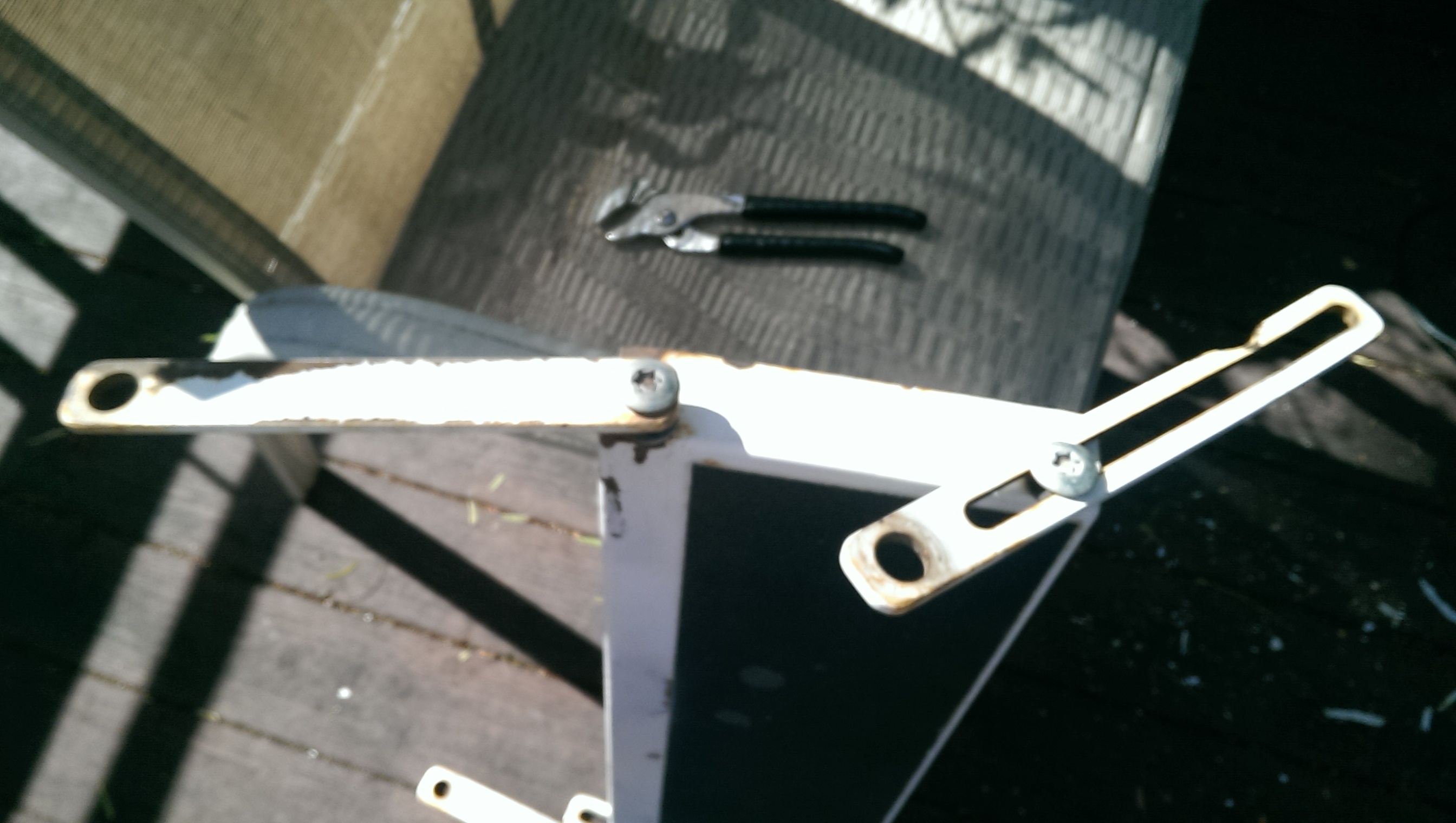

I will post the dimensions here shortly, but in the meantime, here are some more photos, showing the brackets and mounting bolts in various stages:
It looks like your "L-brackets" attached to the step frame to keep the step in place are original, mine look the same (but white), and the solid hanging strut butts up against them when the step is down. There are two 30" "axles" running through the step at the top front and top rear that allow the struts to pivot and slide when folding and unfolding.
Re: Your Rear Step Assembly: photos needed
Posted: August 2nd, 2019, 4:32 pm
by caconcourse
Here are dimensions, and a photo of the step bottom, showing one of the axles. The axles are made from a rod with threads on each end, and a torx bolt on the end. Could be threaded rod with locking nuts.
Update: added some more dimensions to drawings and added notch in slotted strut. Redrawn on my new CAD system (pencil, paper, eraser, and phone camera). Note the step triangle is a simple 6", 8", and 10" right triangle, and solid strut is the 8" leg.

Clay...I can't thank you enough for your detailed reply! Thank you! This should give my metal fab guy enough info to do the job.
Again...thanks to all!
