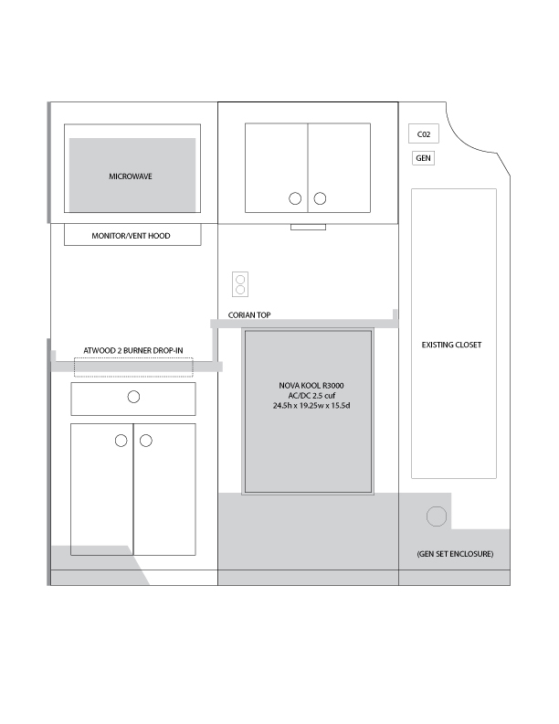

This layout shows my idea of installing a Nova Kool AC/DC unit in the same space as the old Dometic. It's 15.5" depth allows for less footprint in the same space with additional countertop space as well. This approach is a less involved project, and if one would chose to keep the old 3 burner cooktop, obvious cost savings also. It got out voted for esthetic reasons (sigh). A clean, one surface countertop won over the step-up version.

Very interesting to read your ideas and see the drawings.
I'm just in the planning stages of something similar, and the Vitrifrigo 130 (with separate compressor) is currently at the top of my list. Not sure whether I will keep the stove/oven or not. I like the oven, but never use three burners, and they use up a lot of space.
I had not thought of putting the refrigerator where the stove is and vice-versa - interesting.
I'm also really interested to read how you got the refrigerator out. I take it you removed the door and then sawed in the direction "from ceiling to floor" and removing the "door side" from the side that faces the outside wall? I will likely be doing this soon. Was it basically just foam then?
