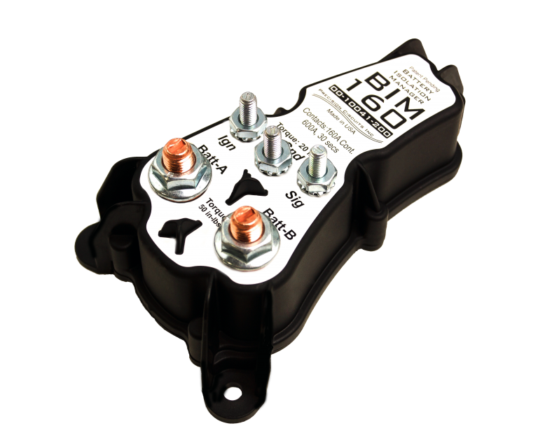

I'm not certain, but I think the battery isolation manager is just a bit fancier version of the regular 1314/1315 isolators almost all of us have/had.
