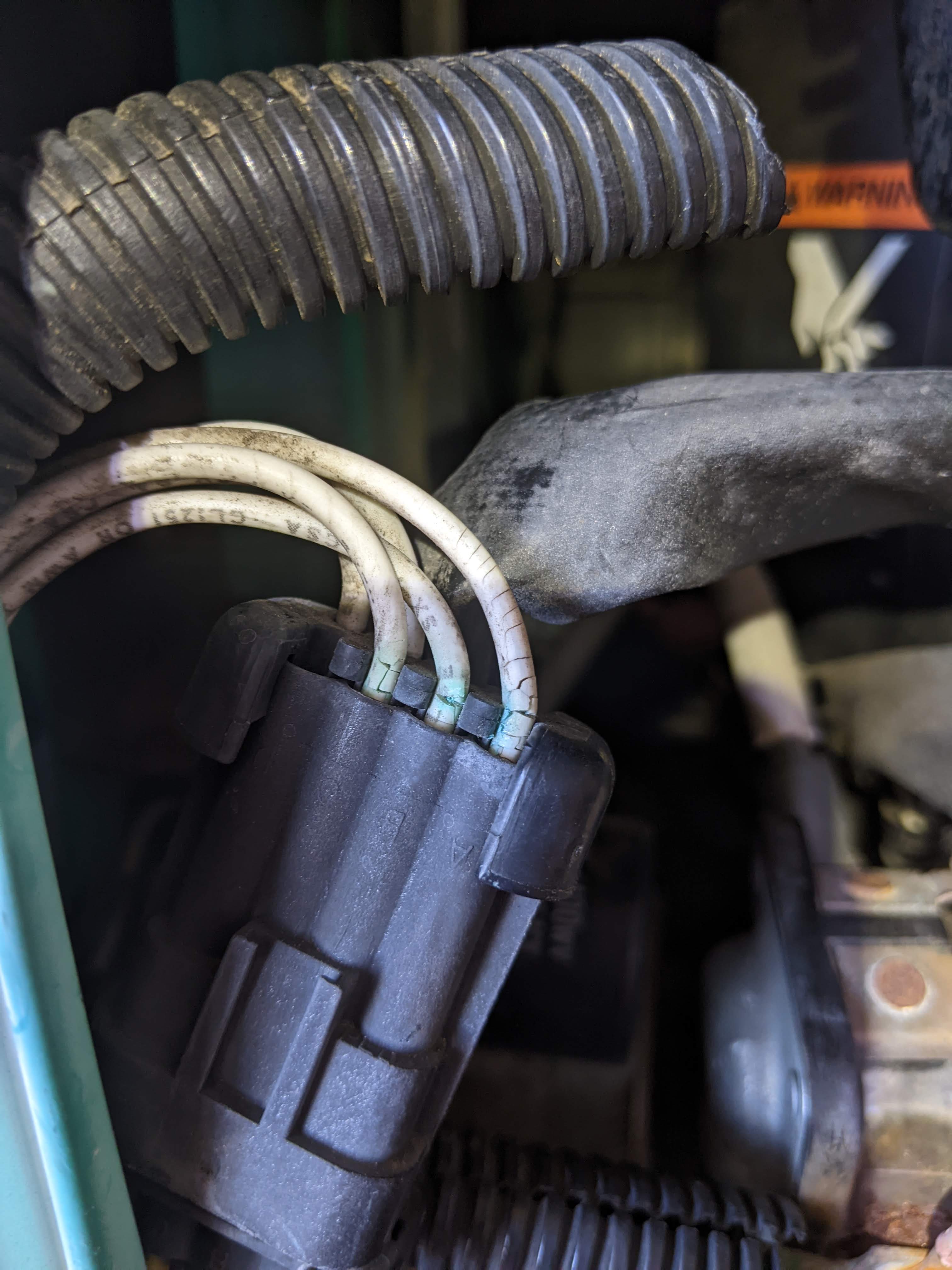

Also, I took the front cover off the switch board so that I could look behind the switch and I noticed that all three connectors were not connected to the switch. I reconnected them, but this did not fix anything. I've attached some pictures for your reference.
P.S. The LED light on my rocker switch doesn't turn on. I pressed the stop button three times within five seconds to see the error code and the light would not blink. Could this be indicative of something?
