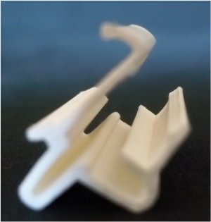

Re: Window screen removal / replace
Posted: July 27th, 2016, 2:02 pm
Here is one of the clips. As you can see, it looks like a long extrusion that is "sliced" into clip length sections. What the clip does is allow the screen to ride only on top of, and on the room side of the "fin/track." Without the clips, the screen frame just falls into the room (there is nothing on the living space side of the fin/track to hold it on without the clip).
Tim, is this what your windows and screens look like? If the 1/4" tubing trick will work, you'll have at least two grateful Chinookians.
PS: I have been wondering if someone could 3D print these from a sample (sent with $2000 insurance of course :D). I don't know enough about it to know whether or not it's possible/practical.

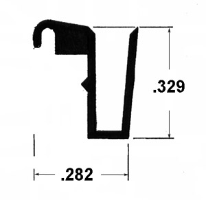

Posted: July 28th, 2016, 7:51 am
by HoosierB
Not sure if this is what Blue is referring to. Found these websites selling clips:
http://www.all-rite.com/hehr-4900-serie ... a67bdd73ea
http://www.pellandent.com/Motorhome_Pro ... Return=304
