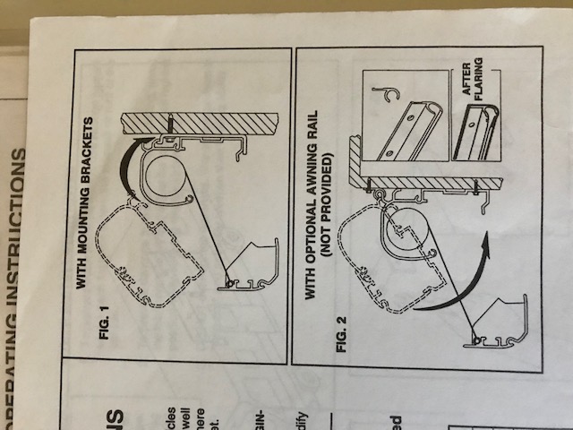

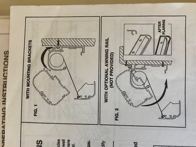

On the bottom of each mounting bracket is one screw that secures the awning to the bracket. Remove those screws. At that point the awning hanging on each mounting bracket with the bottom resting on each bottom support where you removed the screws.
All of this is done with the awning in the closed/retracted position.
The next step is to look and determine how your awning hangs on the mounting brackets. My awning has a full length rail with a full length groove. To remove the awning, you lift the awning up about a 1/2 inch and away from the brackets. IMO, to do this safely, have one person on each end of the awning using step ladders or whatever for a safe working position. If you look at the photos you will see the top of the mounting brackets and the leg that fits in the groove of the awning. Really very simple to remove it.
With that said, there is an optional attachment method noted in the instructions. I’ll post my model number to see if yours is the same.

Looks like we both posted simultaneously (sorry, you were really the person being asked).
The way you described it is the same as the brand new Fiamma my buddy bought last year and we installed (using the 2003 brackets, which were nearly the same as the new ones). Kinda like those tables that fit into a wall track.
