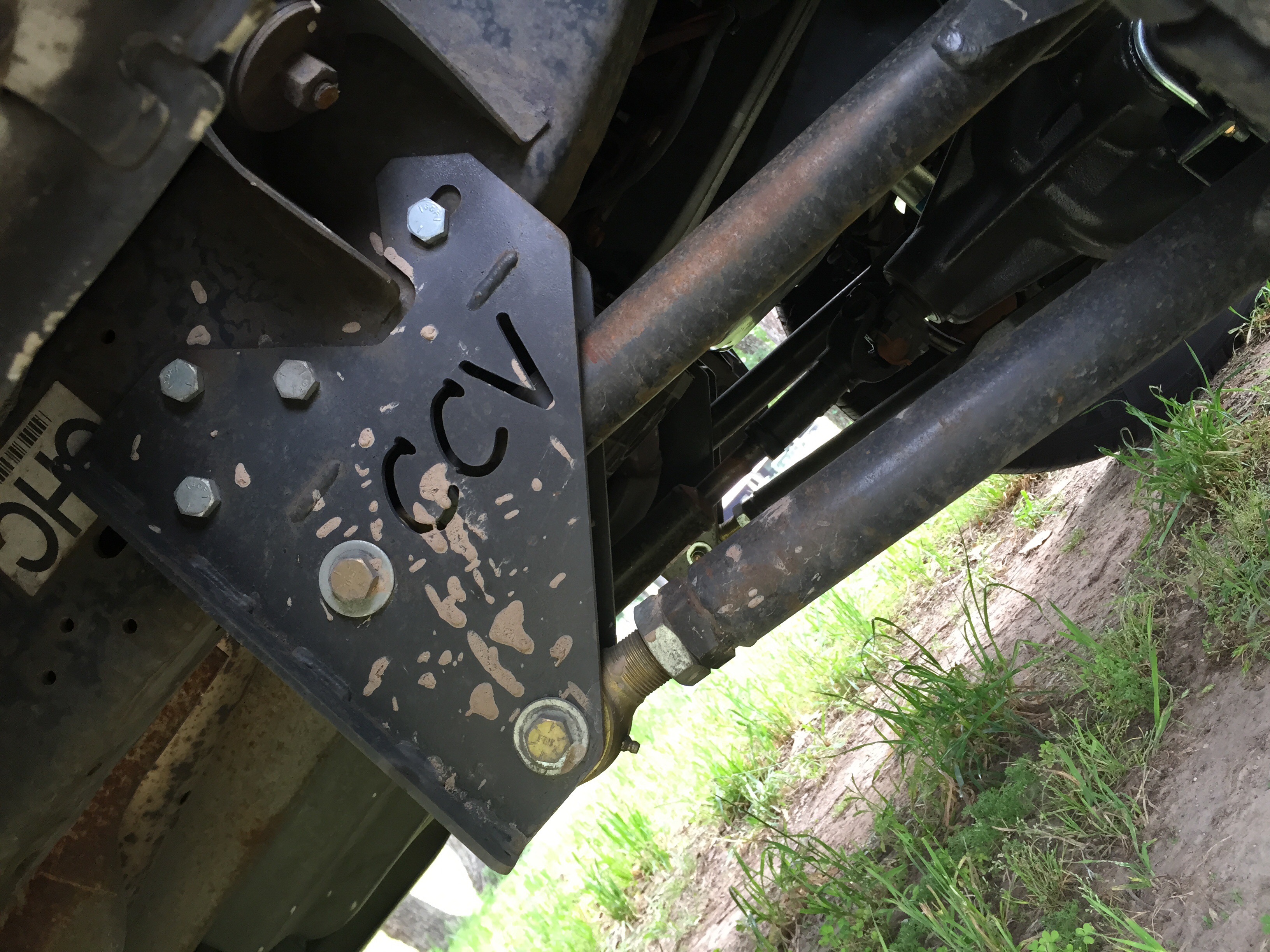

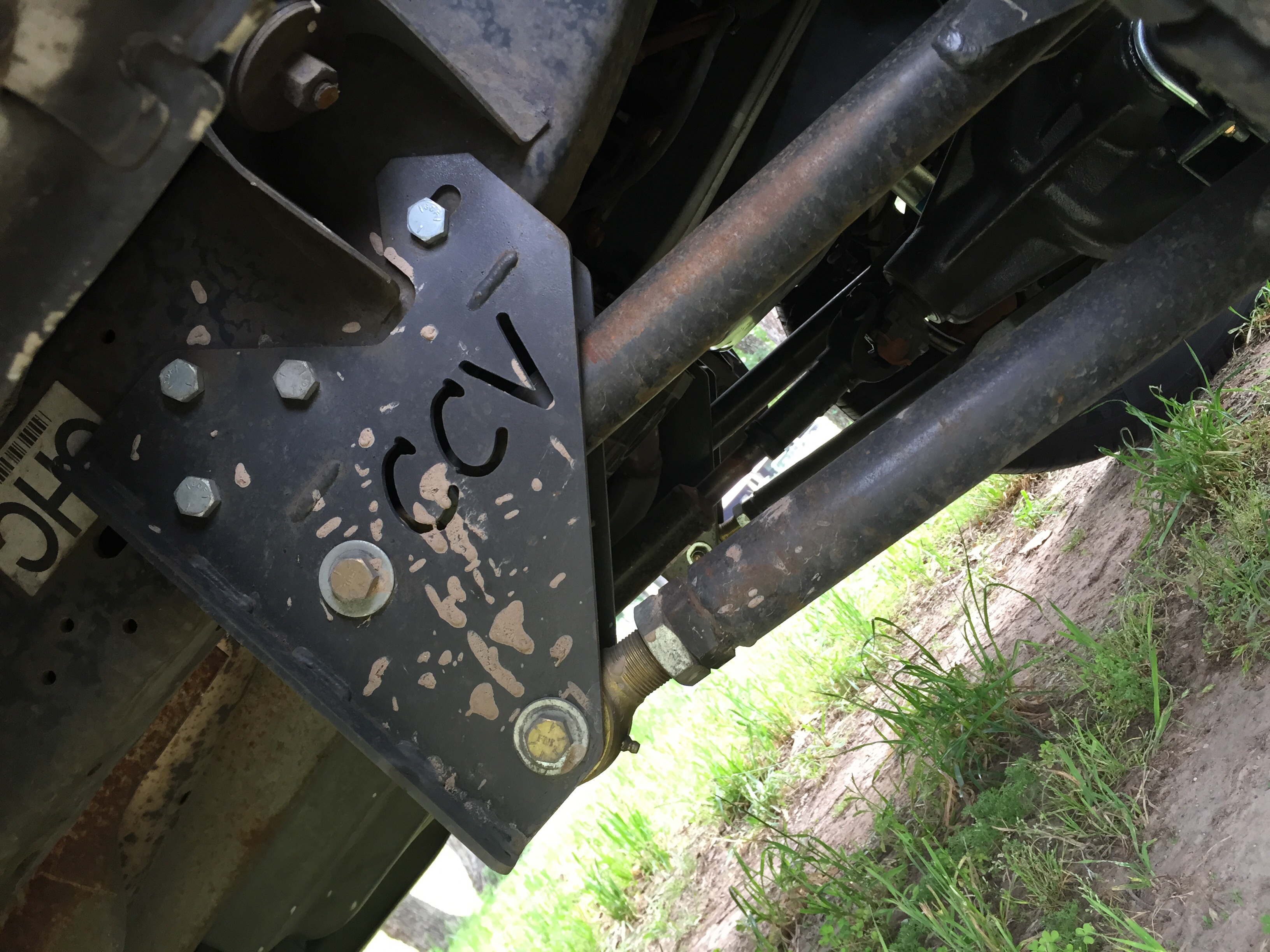

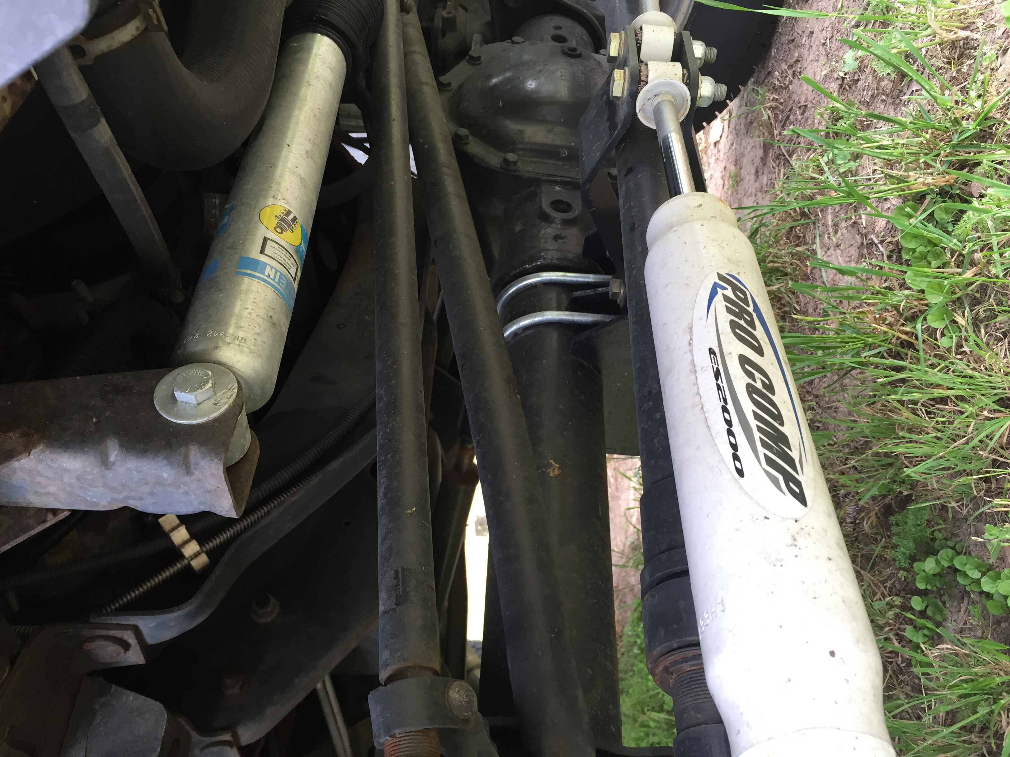

So many pictures. A video would be better. Here's something for now. Where do you live? Maybe if I'm ever in the area I'll let you have a look.

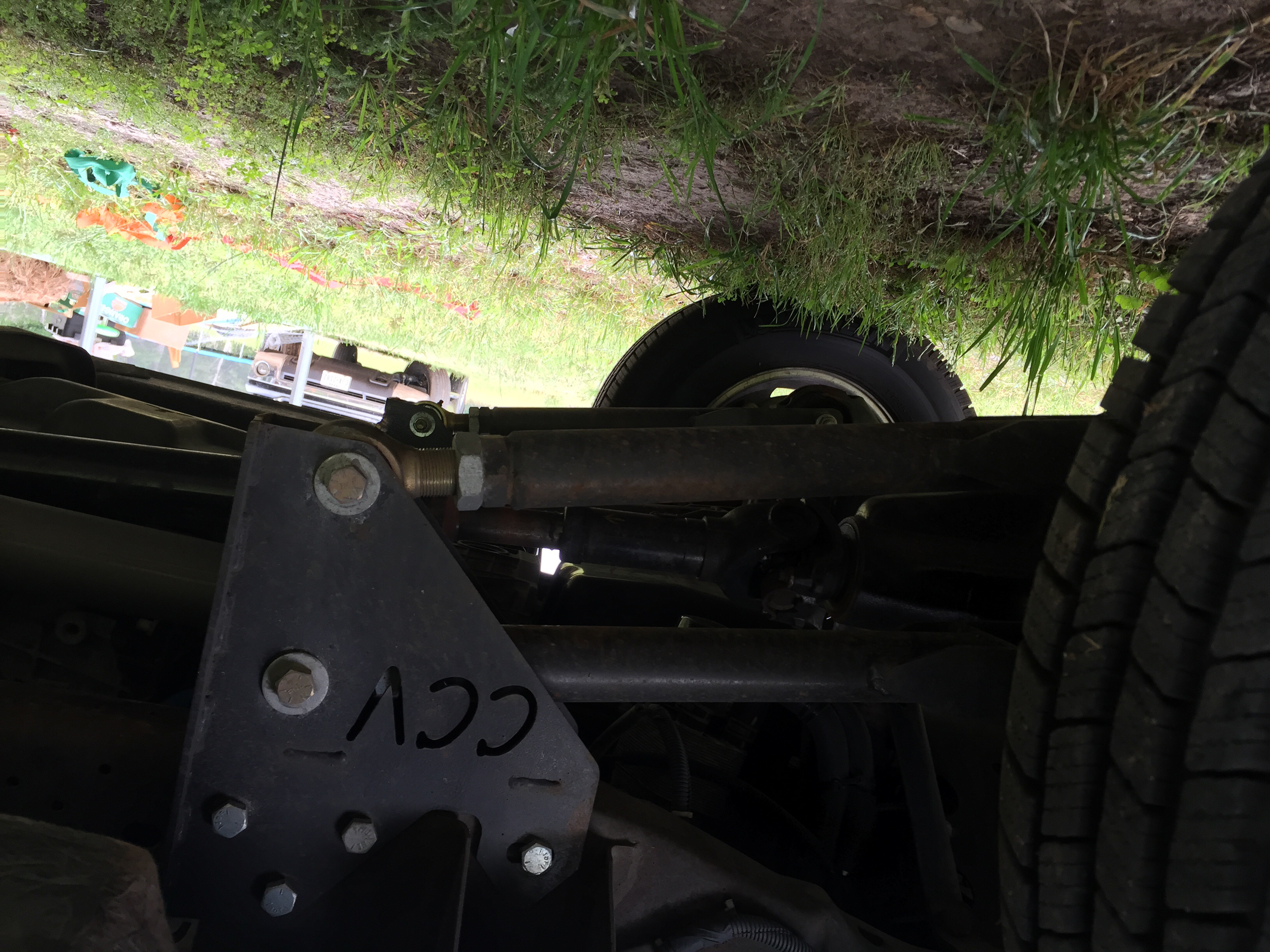

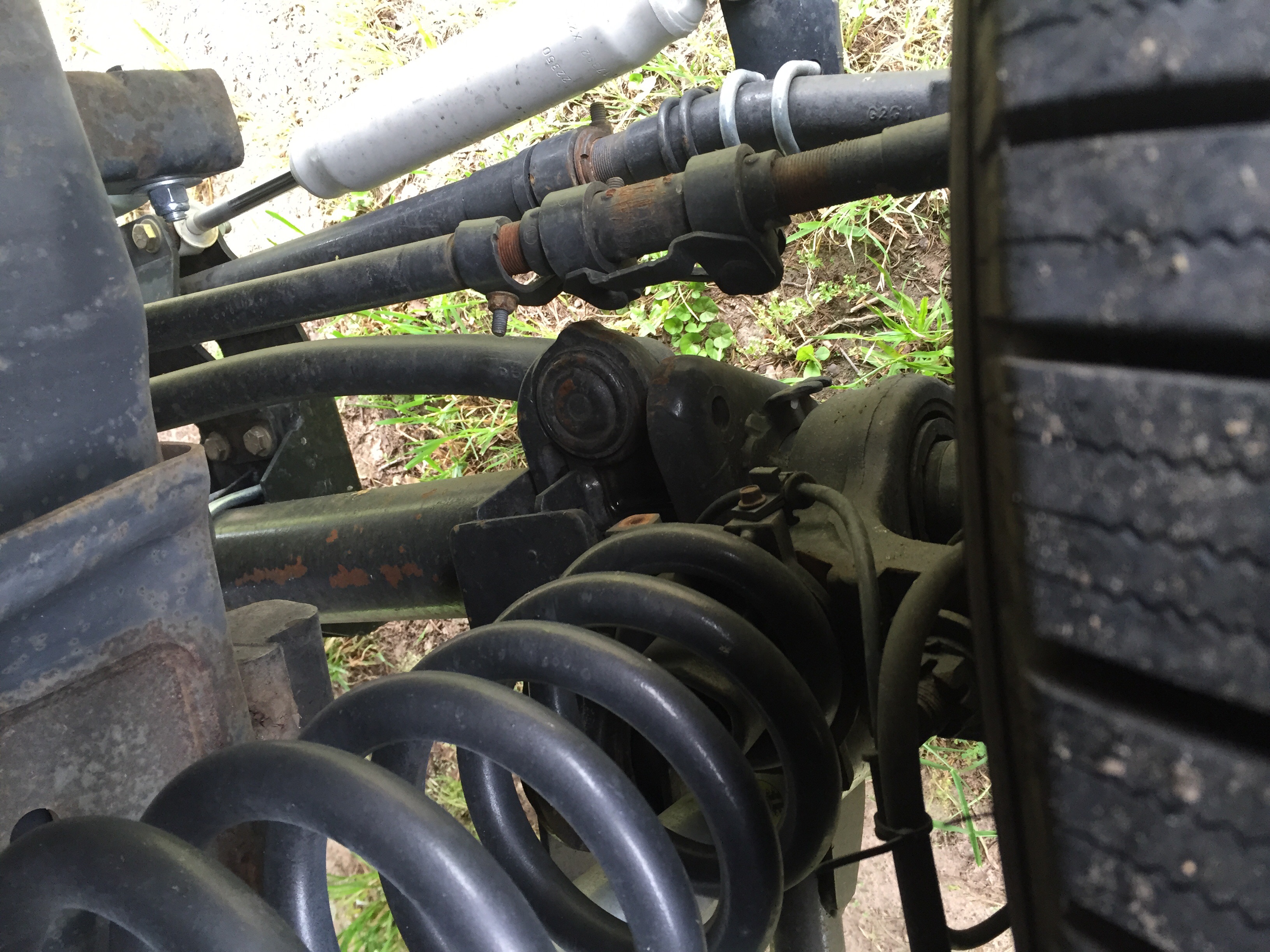

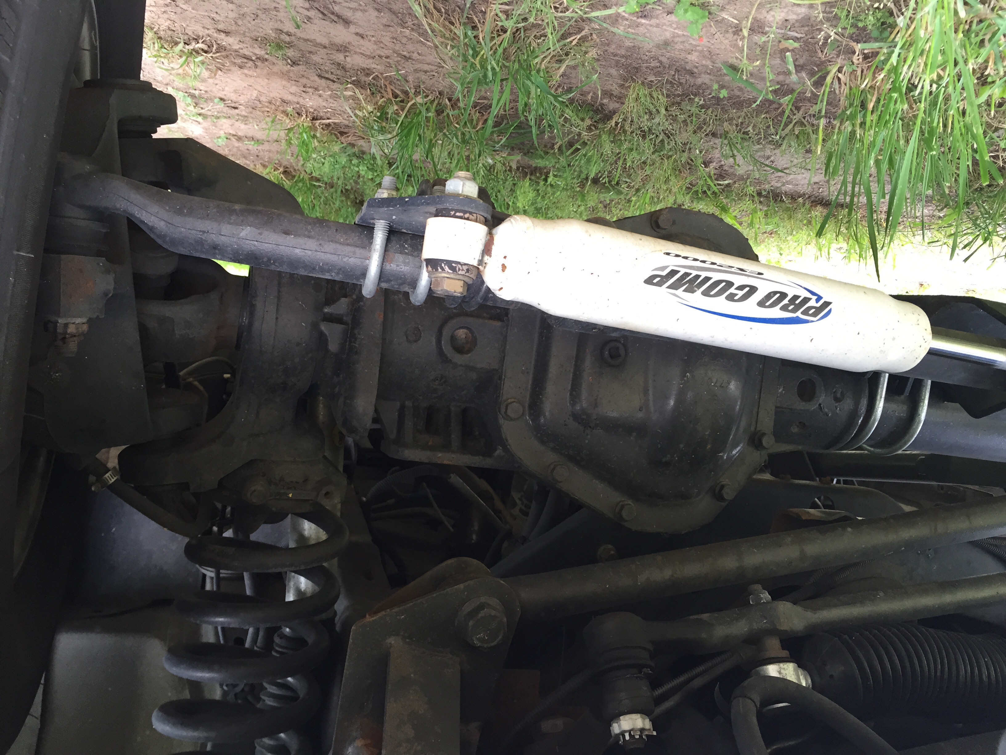

Couple more.

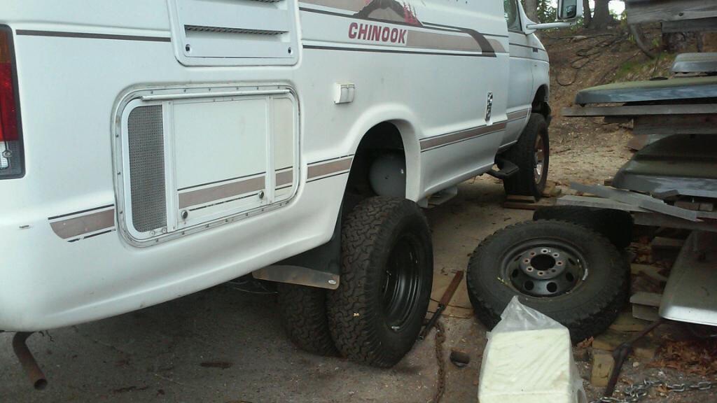

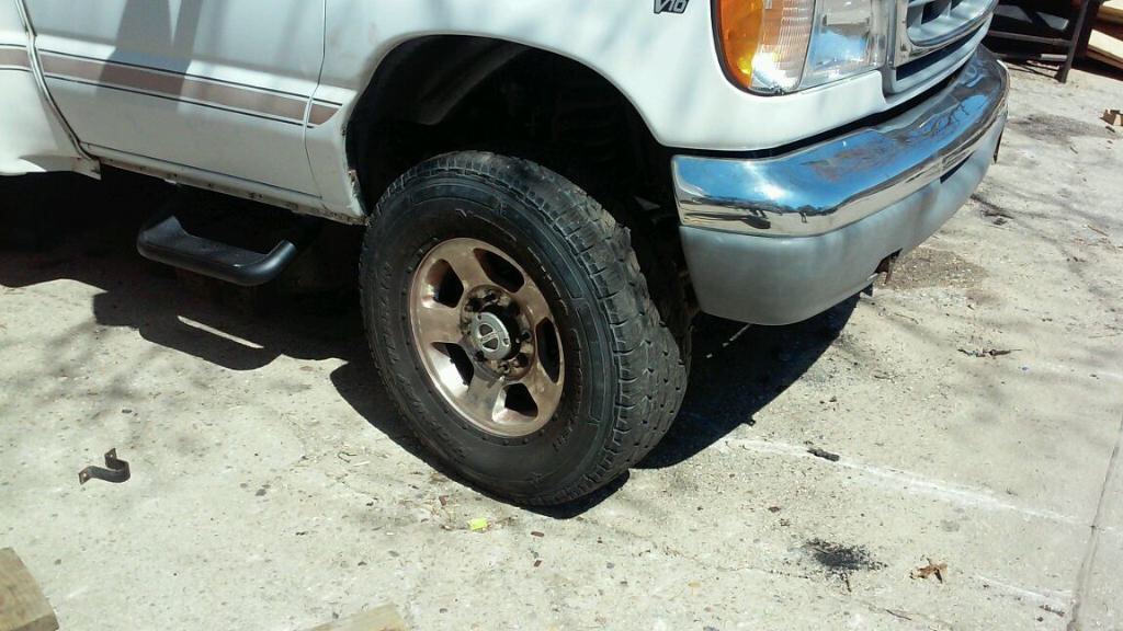

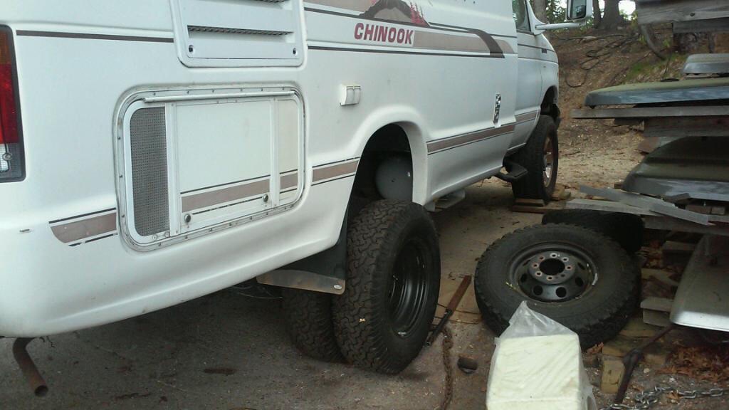

New front and rear axles are in. Any thoughts on the height of the rear? Is it too much?
Posts: 796
Re: Current pic (April 2015)
Mine has 3" blocks in the back and it's not enough. 4" would probably be about level. What did you use?

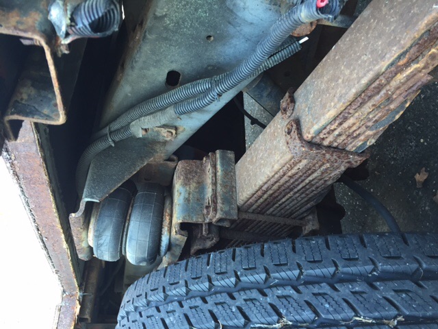

All of my parts came off an 08 motor home with a Quigley conversion. I think that motor home weighed much more than my chinook. Here is a photo of the rear leaf springs. Could you send me a pic of yours? Thanks

I count 12 leaves on my spring. What do you have on yours? Thanks
