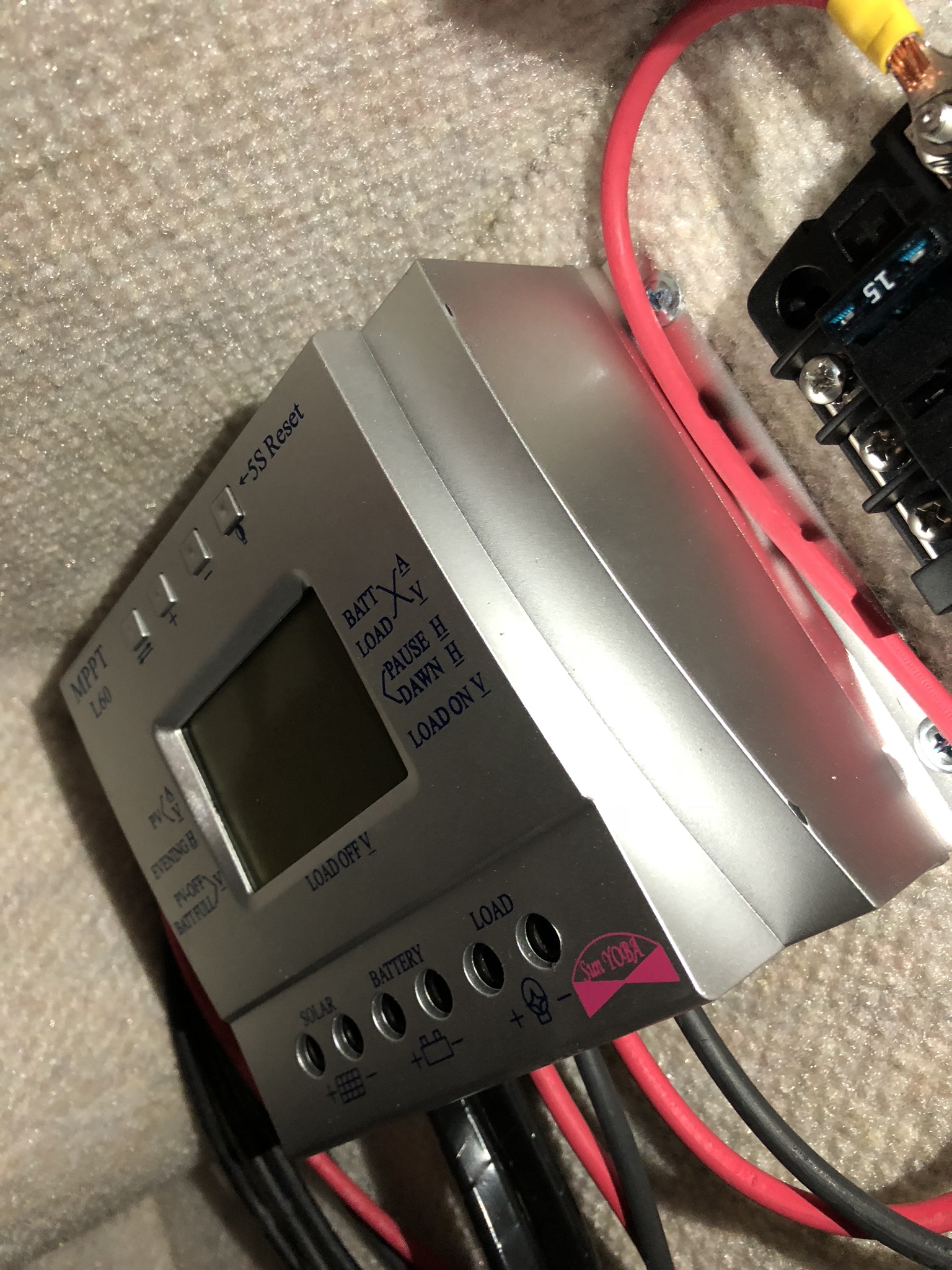

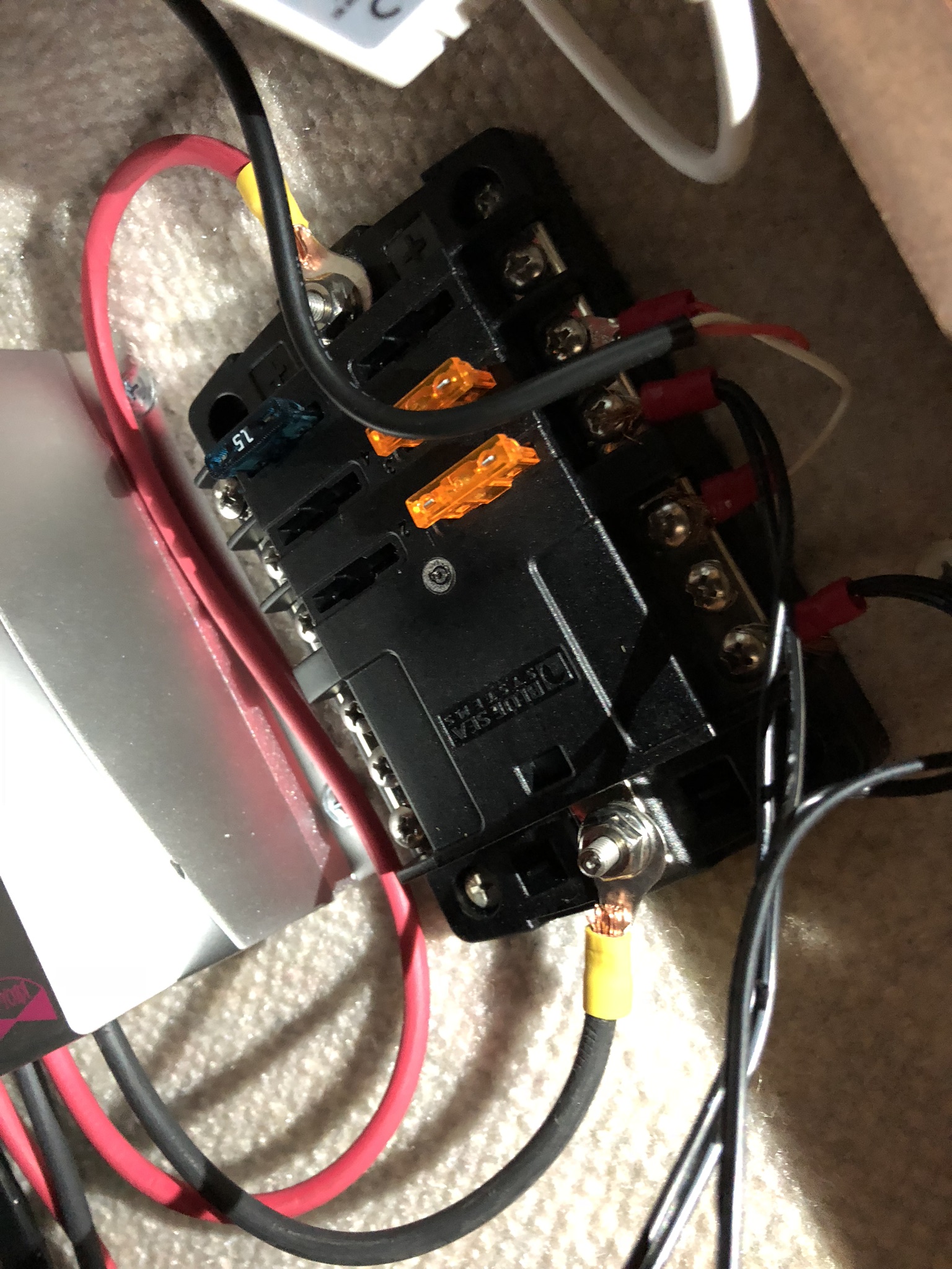

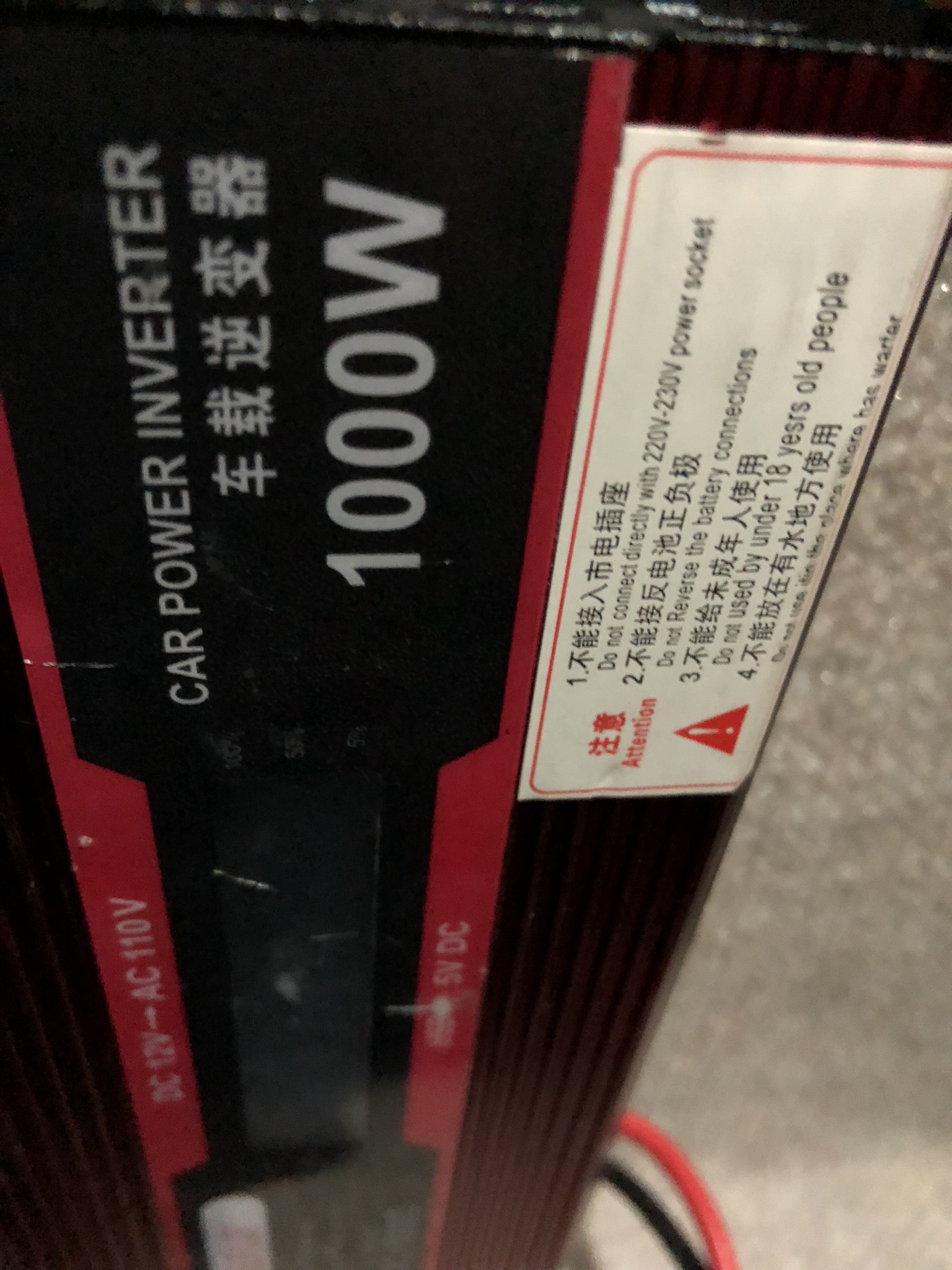

Honestly the solar set up sux. It’s cheap. I’m gonna replace most of it. Here’s some shots of the cheap janky crap the guy put into it. I’m looking to UPGRADE!

Thanks for the roof photo. I see two 100 watt "flexible" panels on the right, and then another rigid panel (can't tell wattage) and then... there must be a fourth one somewhere?
Just FYI, the flexible panels turned out to be a bit more fragile than initially expected. Two things can really cut down on their lifespan: One is bending them back and forth (which is why they typically no longer call them flexible, but something like "lightweight") and the other is heat. They are really vulnerable to excessive heat. Since they of course soak up heat through the black surface, it's best to have some ventilation on the backside vs. mounting them flush. That can be a challenge because you have to then support them well (see fragile above).
One thing you could consider is using them as ground panels and putting rigid panels on the roof (aluminum/glass panels are very sturdy and basically last forever). I have a set of the lightweight panels I use as ground panels and they are really handy no matter how much you have on the roof, IMO. I often put mine in the sun when I'm parked comfortably in the shade (ahhhh), and also they are super easy to tilt and align (which can be handy during times when you want to milk a sunny day during a cloudy period, or when the sun is at a low angle (winter). I keep mine standing up right behind the driver's sit where they fit pretty well.
As careful as I've been with the lightweight panels (ventilated, well supported, transported carefully), I've still managed to have two go belly up over a period of three years. One may simply have been defective as the diodes in the junction box burned up when it was only a couple months old. The other one lasted two coddled years and then evidently had a wire or connection break inside. I think it's just the nature of the beast (although they may improve in time).
Anyway, feel free to show us more. We love to see :D
Re: Hope to get Awesome Chinook side entry rear bed tomorrow
Oh I see you posted more while I was typing.
Erm yeah... solar/electrical might benefit from a few changes :shock: But hey, those lightweight panels would make great ground panels!
