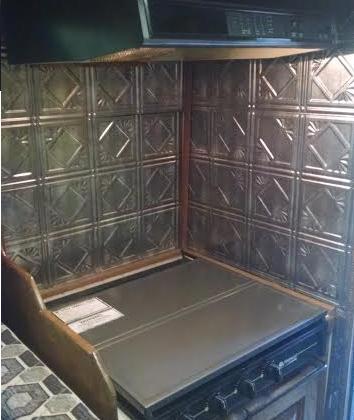

Skillet wrote:Anyone ever replace what's on the wall behind the stovetop with something like tile or wallpaper or something? I'm looking to get some kind of tin panels to put up there but didn't know how to work around the fabric wall that's there.
I put up fake resin tin tiles (from Home Depot - I think they're 18"x24" @$20 each - I needed four to make the seams match going all the way up.
Tin oven backsplash
Tin oven backsplash

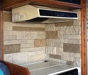

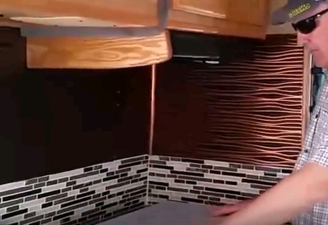

Other treatments I've seen on Yahoo and YouTube:
Stone backsplash
Stone backsplash
Glass backsplash
Glass backsplash

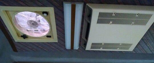

Our 1994 also had a cloth ceiling that matched the seating.
Cloth ceiling
Cloth ceiling
After I did the stove tin backsplash, my wife insisted upon the same for the ceiling.

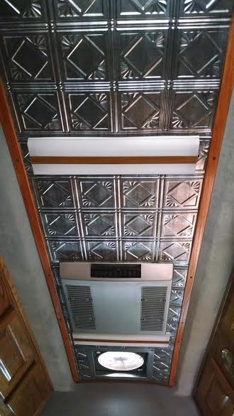

So I stained some wood edging, painted the faded cream color Fantastic Fan and A/C shrouds each a grey stainless steel color, and put a tin ceiling up as well:
Tin ceiling
Tin ceiling
It gets lots of compliments from visitors.

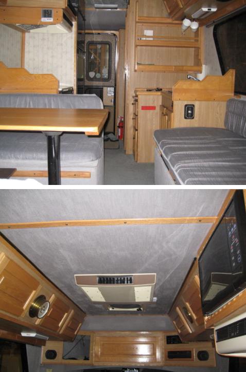

Here is a photo of one. This is a 1991 model. Grey fabric on walls and overhead, and no center hump.

Wow, that tin ceiling looks really sharp. It's no wonder you get compliments. How did you get it to adhere?
Re: Wall Tile or Wallpaper
Skillet wrote:Wow, that tin ceiling looks really sharp. It's no wonder you get compliments. How did you get it to adhere?
Thanks! I was hesitant to do it, but my wife insisted it would look good, and she was right.
Most of the 18"x24" resin panels are held up by the ~8' long rounded edge stop moulding on each side (stained with some pecan poly stain I had laying around) which are held on the ceiling with pre-drilled black screws.
Of course the fan, A/C and lights also help hold up most of it in the middle. Only the two large pieces towards the rear needed some slight help with some staples in their middle grooves (almost invisible due to being same color).

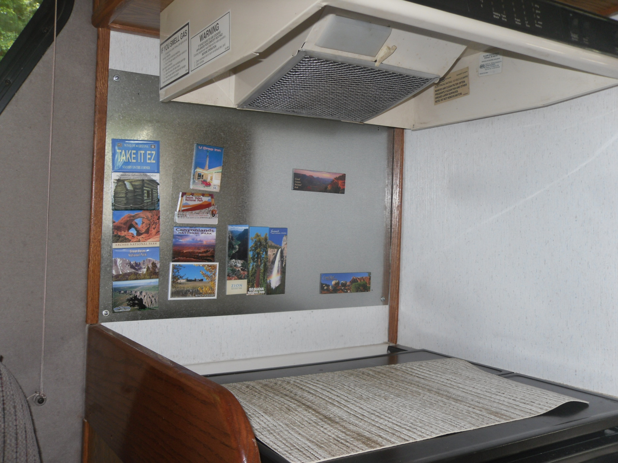

Purchased a piece of sheet metal from Home Depot (in the stove pipe section)- $5.00. Mounted in back of stove, gave my wife a place for the magnets from the places we visited.
