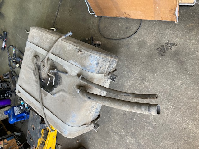

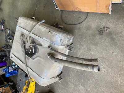

Post by noluck »

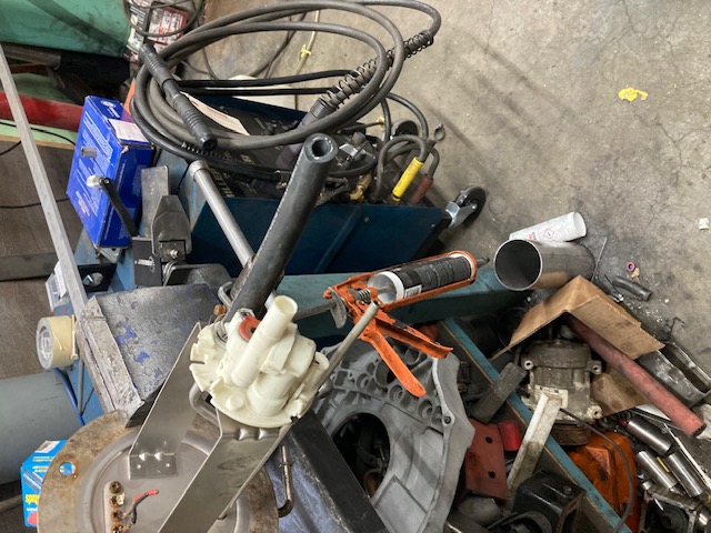

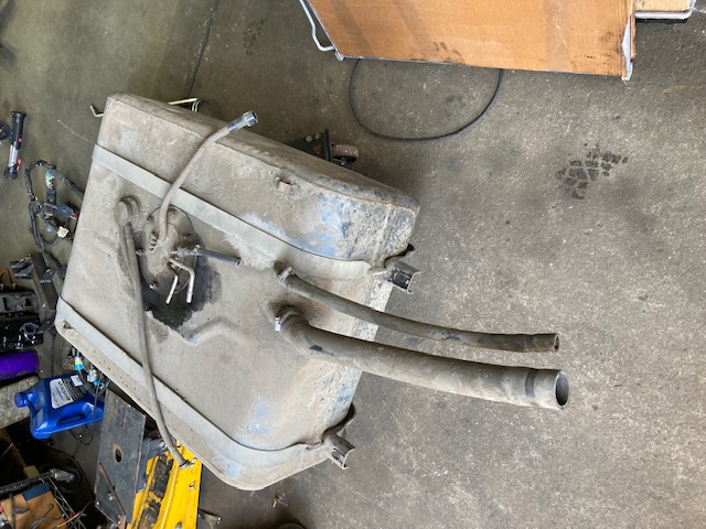

removed the fuel tank and removed the in tank pump, but kept the module so it will operate the same as when it was a gas tank not a diesel tank. also pinned out the fuel sender wires so i can connect to 2010 wiring, i will change the filler neck to a diesel one as well

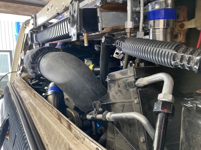

Post by noluck »

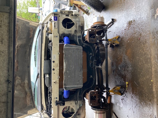

starting to button up the front end, going through and doing the finale assembly and looming everything. hopefully will be done that task tomorrow. down to days now before fire up :D

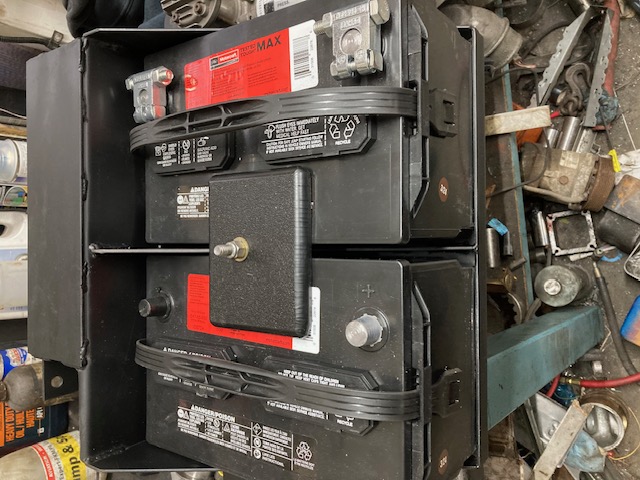

building battery box to hang both 1000cca batteries on the frame, i will probably move the coach batteries there as well, eventually

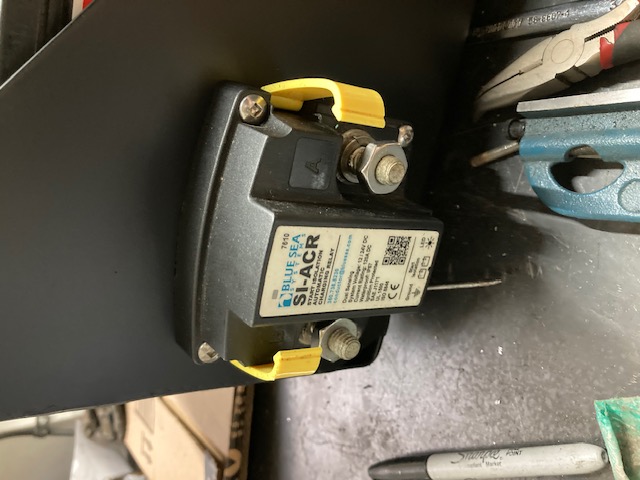

Post by noluck »

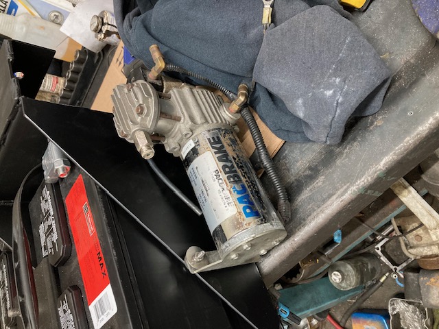

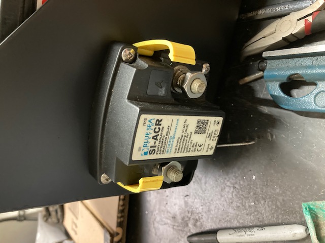

battery box with compressor for exhaust brake and a acr to isolate house and start batteries when engine is off ( same unit i run on all the boat i build)

Post by noluck »

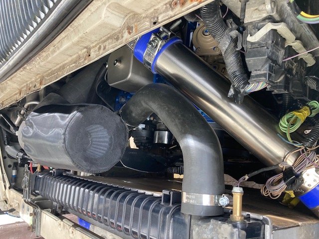

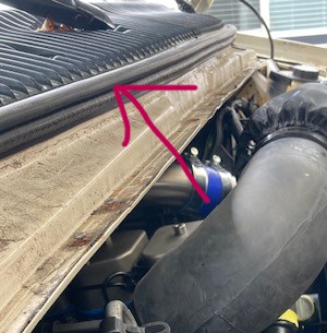

Looking sweet as usual. Pretty amazing how much you've done, and so quickly. Can't wait to hear/see it run!
Say, do you happen to have a part number or decent replacement suggestion for the cowl gasket in your pic? My van never had one. Thanks.
noluck
Posts: 246
Location: Abbotsford BC
Post by noluck »
it is just called a bulb seal
