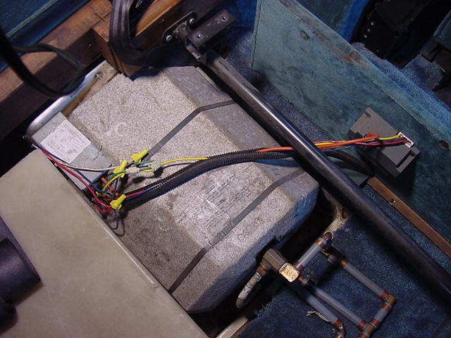

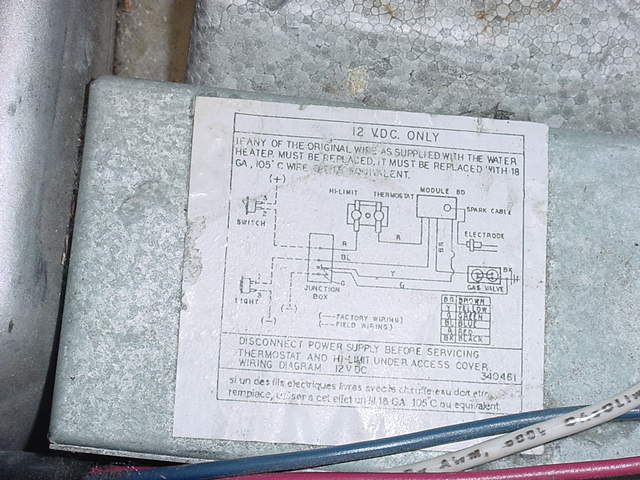

I think that I figured out what the mystery controls are. I'll bet that they have something to do with the ignition system for the water heater. I'm still attaching some pictures, but because of where its located it makes sense. I'm using this thread so that I can attach the pictures.
Alan
Alan

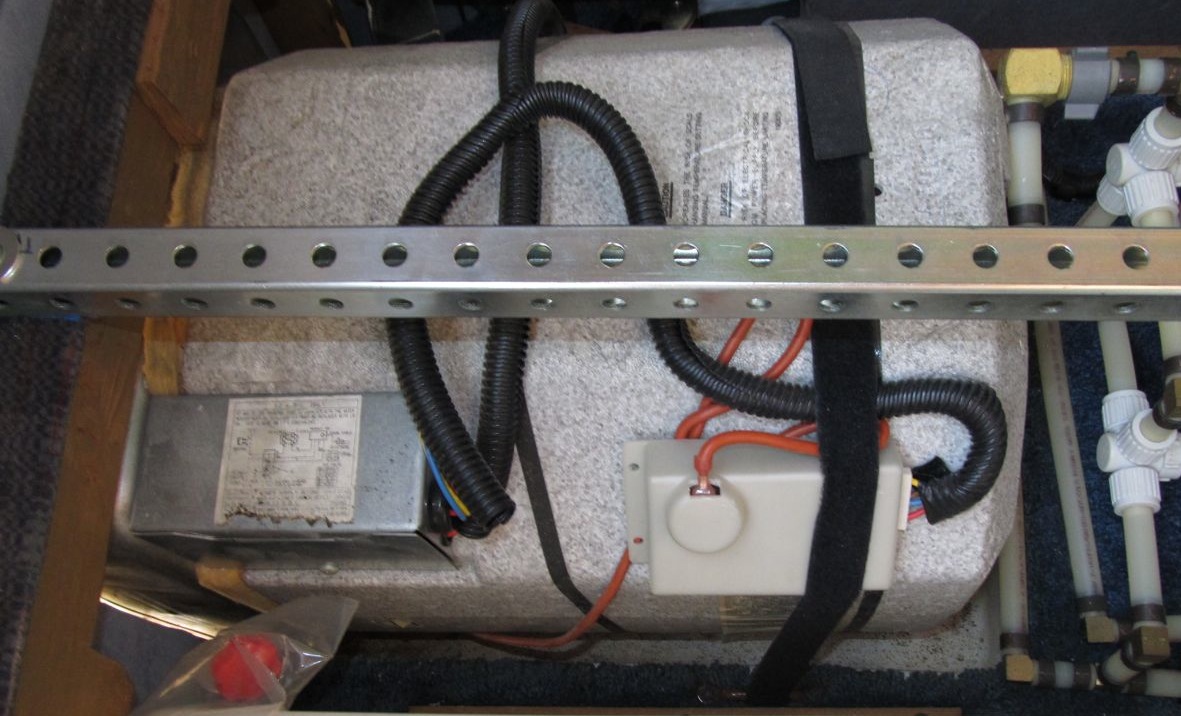

Aha! On mine a similar box was affixed to the top of the water heater (Suburban 6-gallon propane) which is in that same location under the forward end of the couch. I'll see if I have a photo just for comparison.
Okay, here is one of my original Suburban water heater. The silver "box" to the left in the photo is part of the water heater. The white plastic box on the lower right is also part of the water heater, but not "permanently" attached except by the wires and the Velcro strap (which strap also holds the water heater to footman loops fastened to the floor).
