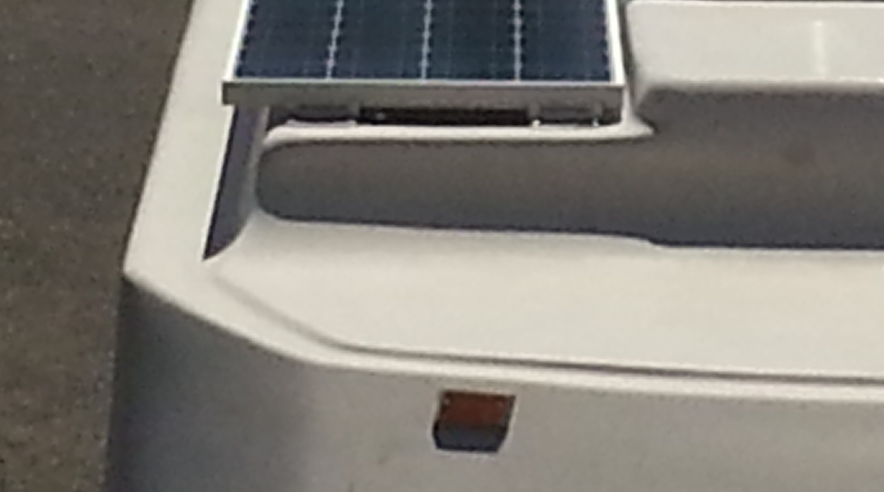

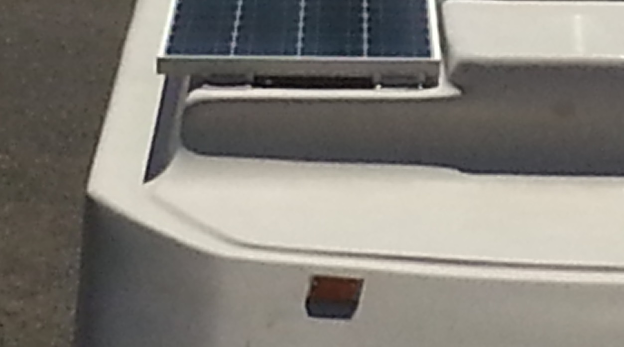

As usual, BG's comments/suggestions are sound. I'll second his view on that kit; it's too expensive. In selecting solar panels, I was looking for units that were 1) modern/efficient, 2) dimensionally workable, and 3) popular/available. If these requirements were met, a bit of overhang from the second tier wasn't going to bother me. However I can certainly understand how it would be an aesthetic issue for some. Popularity usually results in lower price, and more importantly, popularity makes it easier to source replacements. If you can get an identical replacement panel, then installation is a breeze with regard to mounting and wires, and there are no issues with setup or system compatibility. Blue already mentioned the replacement factor, but it's well worth restating since solar panels have a finite life. I rarely hear people discussing this. Panels gradually deteriorate, plus they're subject to damage especially when roof-mounted. Hail and tree branches come to mind for some odd reason. Some even get ripped off by erratic gusts. These are rare situations, but they happen.
I have a PWM controller which came in a run-of-the-mill kit (panels, controller, MC4 connectors). I added a temperature compensation probe for $10. The panels are wired parallel with a 13 foot long 8awg marine drop line going through the upper fridge vent into the coach then into the generator bay. There's a 15 amp in-line waterproof fuse just after the panel pairing. There's a 30 amp fuse between the controller and bank; this run is about 10 inches, and I think I used 10awg. My original plan was to use the PWM controller until I became acquainted with the system, then upgrade to something more efficient like an MPPT. But since it's installed and serves my needs just fine, I'm going to leave it until it fails. Achieving ultimate efficiency is a noble goal, but if I have what I need, then I don't lose sleep. I mounted my panels with the brackets on the panels' ends to get them as close to tier 2 as possible (slight gap to allow water and debris to pass through). I haven't measured the overhang, but to me it's trivial.
Edited to add a picture. This is out of focus since the picture was taken from a hilltop with my phone, then zoomed/cropped, but you probably get the idea.
