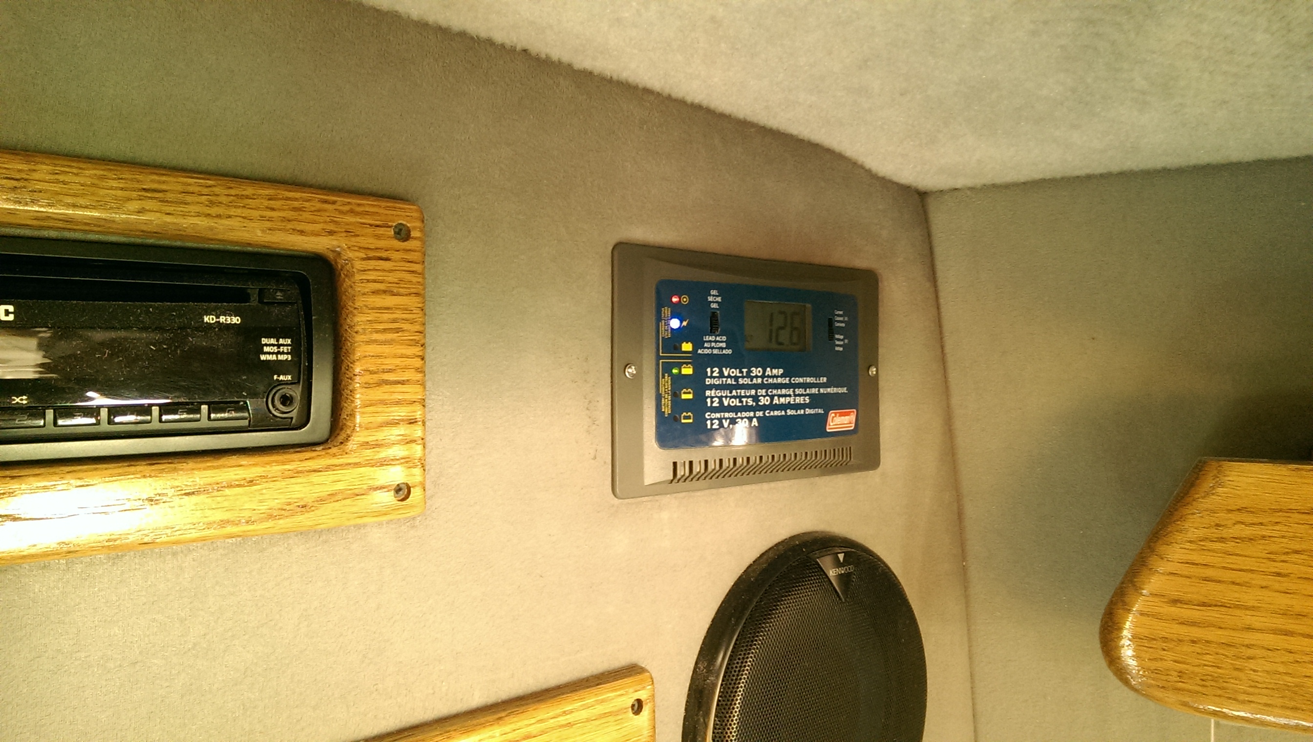

That's not the exact same solar controller I had in my rig, but it's very similar. Mine had just a red and a green light, as I remember (or maybe it was yellow and green?), and one of them would always be lit up during daylight (indicating things were happening). Geez, I'll have to go back and look at photos of it. At any rate, I should think that one of your lights should be lit during sunlight. The yellow most likely, or maybe just the green if the batteries are full (I'd think that would light up even if the batteries are full?).
Have you ever the rig out in the sun and not plugged in, so you can see what the solar is doing on its own? How about putting a voltmeter across your battery terminals when the sun is out and you are not plugged in, then covering up the panel (or I guess maybe removing that little fuse from the front of the controller would be easier) and seeing what happens. What if you use some juice so your battery needs charging.
One thing to know is that you won't ever "take in" any power from a solar panel if you don't need it. For example, on back to back days where I am in the same place, same sun, same everything - if my batteries are close to fully charged, I might only take in 14 amp hours (say) from the solar panels through the controller. OTOH, today I took in 56 amp hours (because my batteries were down and could use it). It's like if your batteries are one of those automatic dog water bowls, when the dish is full, no water will come down into it.
If it comes down to it, I can look up the manual for my controller (which I don't have installed any more but saved the manual).

Thanks Blue. Now that you mentioned it I do believe that some of the led lights were working on the controller when I didn't have the rig plugged in. I'm going to do as you suggested and unplug from shore power and draw the battery down a bit and see what the controller does. I'll let you know. I do believe that I;m going to install some kind of battery monitor though. Although not as expensive one as I'm sure that you have. Any suggestions anyone?

I replaced my solar controller with this Coleman 3-stage controller ($74), which has a voltage and amp display, so it serves as a battery monitor, as well as showing the solar charge current and providing a much improved charging algorithm. I picked it because it was the exact same size as the stock SCI controller (MK/15) on our 2001 Concourse. I think your controller has a slightly smaller footprint.kyidletime wrote: I do believe that I;m going to install some kind of battery monitor though. Although not as expensive one as I'm sure that you have. Any suggestions anyone?

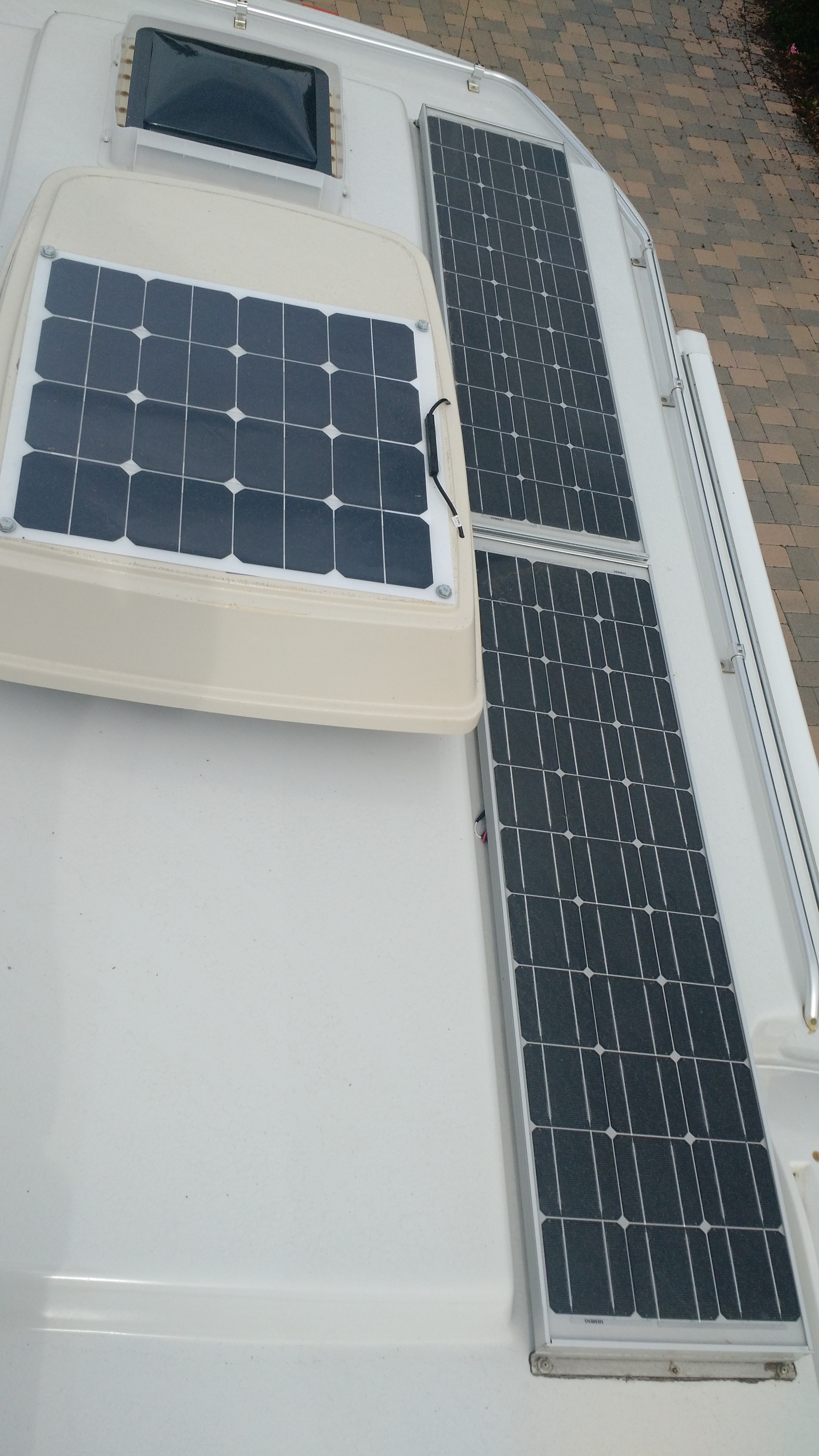

I added a second 50W panel behind the original (purchased from another owner) and added a third thin 50W panel bolted to the air conditioner cover, for a total of 150W. This configuration has kept the batteries topped off in our driveway for over a year (except when travelling of course) with no loss of fluid. As Dale pointed out, the solar controller will turn off the solar input current to the battery when the batteries are fully charged, so you will probably not see any solar charging going on while you are plugged into shore power.

2 extra panels with no increase in cable to the battery size? What about that inline fuse at the battery? (I'm not picking a fight, I really want to know what I can do as a little budget based bump in solar safely)caconcourse wrote:I replaced my solar controller with this Coleman 3-stage controller ($74), which has a voltage and amp display, so it serves as a battery monitor, as well as showing the solar charge current and providing a much improved charging algorithm. I picked it because it was the exact same size as the stock SCI controller (MK/15) on our 2001 Concourse. I think your controller has a slightly smaller footprint.kyidletime wrote: I do believe that I;m going to install some kind of battery monitor though. Although not as expensive one as I'm sure that you have. Any suggestions anyone?

Not that you don't have to keep safety/over-current protection/wire size etc. in mind, but the primary issue with having a lot of solar power and thin wires is that you will just never see a lot of your power. In other words, you are "giving power away." Since solar panels really make precious little, I hate to give any away!
It's not too hard to figure out what the optimum wire size will be (or, conversely, how much you are losing with a smaller wire size). What you need to know are three things:
1) Panel(s) amperage and voltage (and are they wired in series or in parallel if you have more than one).
2) Length of wire(s) run from solar panel(s) to solar controller.
3) Length of wire run from solar controller to battery (or positive bus).
From these numbers you can calculate either how much you are losing with an existing wire size; or how much you could "not lose" with a larger wire size. Having a long run from the panels to the controller, and then from the controller to the batteries is tough. You can work with it, but not with small wires. The reason Chinook was able to use such small wire is that the panel is very small and really only meant to maintain the battery in storage, and, well..... that was then and it's not the best setup. Controllers and solar planning has come miles. I guess you could compare it to what would your cell phone look like if you were using one from 1998 or even 2003...?
One issue with the original Siemens panel (at least the one on my rig) is that it is very low voltage compared to modern panels. That makes it hard to pair effectively with any newer panel (you can pair it with a newer one, but they will both be dragged down to the lower voltage).
None of this is to say the original panel is bad (Siemens made good panels), but just that it was designed for maintenance charging in a "bygone era" in terms of solar tech.
I have to run now, but later I could post a couple of scenarios, if one added say, a 100 watt Renogy panel to the Siemens. (I think a much better idea is to just forget the Siemens panel if you are going to get "serious" about solar.) Alternatively, Clay's way of getting a matching panel is next best for a smallish system on the cheap (nothing wrong with that).

When it comes to solar, your "actual mileage may vary" from specs, and the amps in real life seem more like half of the rated specs. The original wiring is rated for at least 7.5A, which is the value of the in-line fuse, so I feel safe expanding to that capacity without worrying about upgrading the wires. The 50 watt panels were rated at about 3.5A, but I never saw that even with the original panel, 1.5 was more typical, 2.5 was the highest I observed. So the three panels theoretically could exceed 7.5, but I've never seen them come close to 7.5 even. This is probably due to geometry and inefficiency, with shading effects, etc. My Chinook is in the open driveway facing north, so it does get the full noon sun, but gets more in the morning and less in the afternoon. The controller also throttles the output to the batteries according to need, so even at noon, if the batteries are full, there is low current. In the summer, I left the fantastic fan on via thermostat control, and the solar covered that easily while keeping the batteries up.Manitou wrote: 2 extra panels with no increase in cable to the battery size? What about that inline fuse at the battery? (I'm not picking a fight, I really want to know what I can do as a little budget based bump in solar safely)
As Dale pointed out, I was looking for a significant improvement for a small investment. When the Chinook was new, the 50W solar panel was a pretty nice feature, so I think of my upgrade as three times better than original, rather than an optimal performance solution, and it was inexpensive, with practically no impact on usable roof space. (I had seen a factory unit that had two panels instead of one, which is where I got the idea of getting a second Siemens panel.) As long as there is "enough" power for our needs, I don't mind giving some away to inefficiency. One panel was marginal, two was sufficient, and three is reliable, at this point, but our need is modest.
