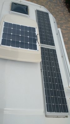

When it comes to solar, your "actual mileage may vary" from specs, and the amps in real life seem more like half of the rated specs. The original wiring is rated for at least 7.5A, which is the value of the in-line fuse, so I feel safe expanding to that capacity without worrying about upgrading the wires. The 50 watt panels were rated at about 3.5A, but I never saw that even with the original panel, 1.5 was more typical, 2.5 was the highest I observed. So the three panels theoretically could exceed 7.5, but I've never seen them come close to 7.5 even. This is probably due to geometry and inefficiency, with shading effects, etc. My Chinook is in the open driveway facing north, so it does get the full noon sun, but gets more in the morning and less in the afternoon. The controller also throttles the output to the batteries according to need, so even at noon, if the batteries are full, there is low current. In the summer, I left the fantastic fan on via thermostat control, and the solar covered that easily while keeping the batteries up.
As Dale pointed out, I was looking for a significant improvement for a small investment. When the Chinook was new, the 50W solar panel was a pretty nice feature, so I think of my upgrade as three times better than original, rather than an optimal performance solution, and it was inexpensive, with practically no impact on usable roof space. (I had seen a factory unit that had two panels instead of one, which is where I got the idea of getting a second Siemens panel.) As long as there is "enough" power for our needs, I don't mind giving some away to inefficiency. One panel was marginal, two was sufficient, and three is reliable, at this point, but our need is modest.
Here's a picture.  Also shows my homemade Fantastic fan shroud from the back.
