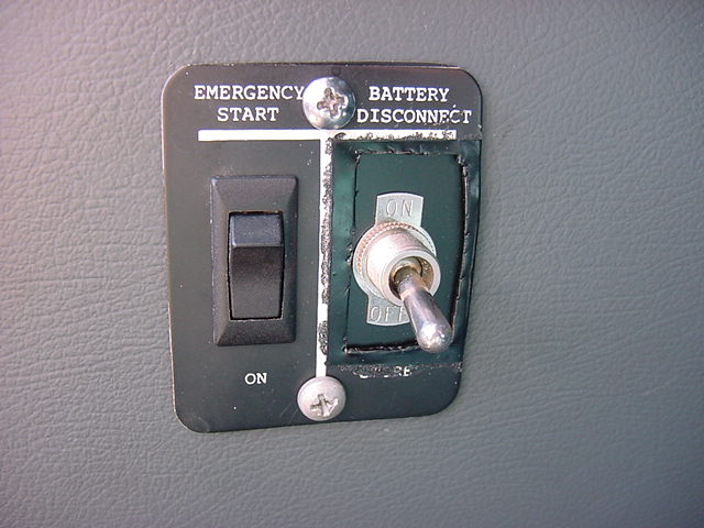

To be honest with you I don't have any idea if my system is working as it should, or not. I have had it hooked in to my house every since I brought it home. My whole concern started with finding the wires connected from the two switches (refer to attached picture).
The pair of jumpered solenoids or coils have the following information on them (both the same): W-R/RBM, also
70902-coil 12VDC cont., and 70-111224-5A, I can't read any brand name. The coil on the left has a white 12ga ground wire and a purple 12ga wire attached. The one on the right has a white 12ga ground wire and a blue 12ga wire attached. They are in a loop connecting the two batteries. That seems to be what the sure power 1315 would be doing, right?
Last edited by kyidletime on September 27th, 2015, 3:13 pm, edited 1 time in total.

Maybe we'll whip this problem. I figure that I might have to replace that toggle switch with something else though.

What I'd like to accomplish (I think) is to eliminate that battery kill switch under the hood, and get the two switches on the dash operational. I am attaching a link to a place that has similar looking switches and the switch plates to mount them. Would you mind taking a look at them and tell me which switches (I'm thinking that I probably should just replace the switch plate and both switches), I would need? Here is the link http://tweetys.com/momentary-switches.aspx
What do you think of that plan, is it feasible?

But now you have the "battery disconnect" switch. The one with the replaced toggle. So what is that doing? I was at first thinking it was disconnecting house loads from house battery, but the manual calls that function "Power Off" and says it is on the seat base. "Battery disconnect" can mean various things. It could be as I thought, disconnecting house loads; or maybe it's a manual way to stop the batteries from combining via the solenoid (although that's not a typical Chinook function that I know of).
To help figure this out, can you remind me what color wire(s) go to the back of that "battery disconnect" switch? Is it grey/red stripe? Can you tell me, if you "flip" that switch, do all your coach functions still work? (do this when not plugged in).
There is no "Power off" switch on the side of the seat, right?
