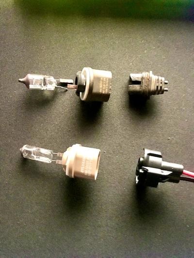

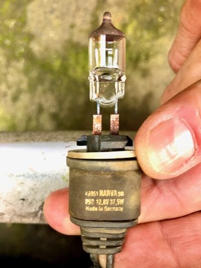

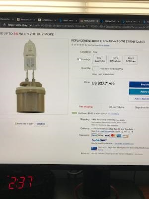

My driver side fog light is burned out. The passenger side still works.
I'd like to keep it stock, so I found a replacement bulb that I'm ordering and will see if the housing it comes with will work. If not, I will take the bulb
off and solder it to the OEM mount.
I prefer this to the fog lights online at Amazon or Autozone that are linked above that have the blue plastic face.
Has anyone done this before?

Re: Fog Lights/Driving Lights

It looks like the OEM ones are soldered in, so why would it not work, because of the metal type?
I'm not a great solderer, but it looked like an easy enough job.
What would you recommend then?
I hope I can use the bulb as is when it comes in.
Oh, if they use solder, then maybe it is fine. For some high temperature bulb, they only use crimp due to the high heat. It is very likely that it is not the case for your application.

Post by Astrodokk »
I checked the bulb again and it looks like it may have been spot welded rather than soldered.
So I may have to re-think this.
Perhaps replacing both fog lights is the best way after all.
If they are not that expensive, you may try to solder it.... it may work. As long as there is nothing that can be damaged if the solder drip down, you can just turn the lamp on for a few minutes and inspect. You can also do that externally if you do not want to go thru the hassle of installing it.

Post by Astrodokk »
Found the bulb and the male connector at Autozone.
The original connector metal elements had corroded and dissolved.
I'm just glad that the lens is intact, otherwise that definitely would have to be replaced with a different design!
