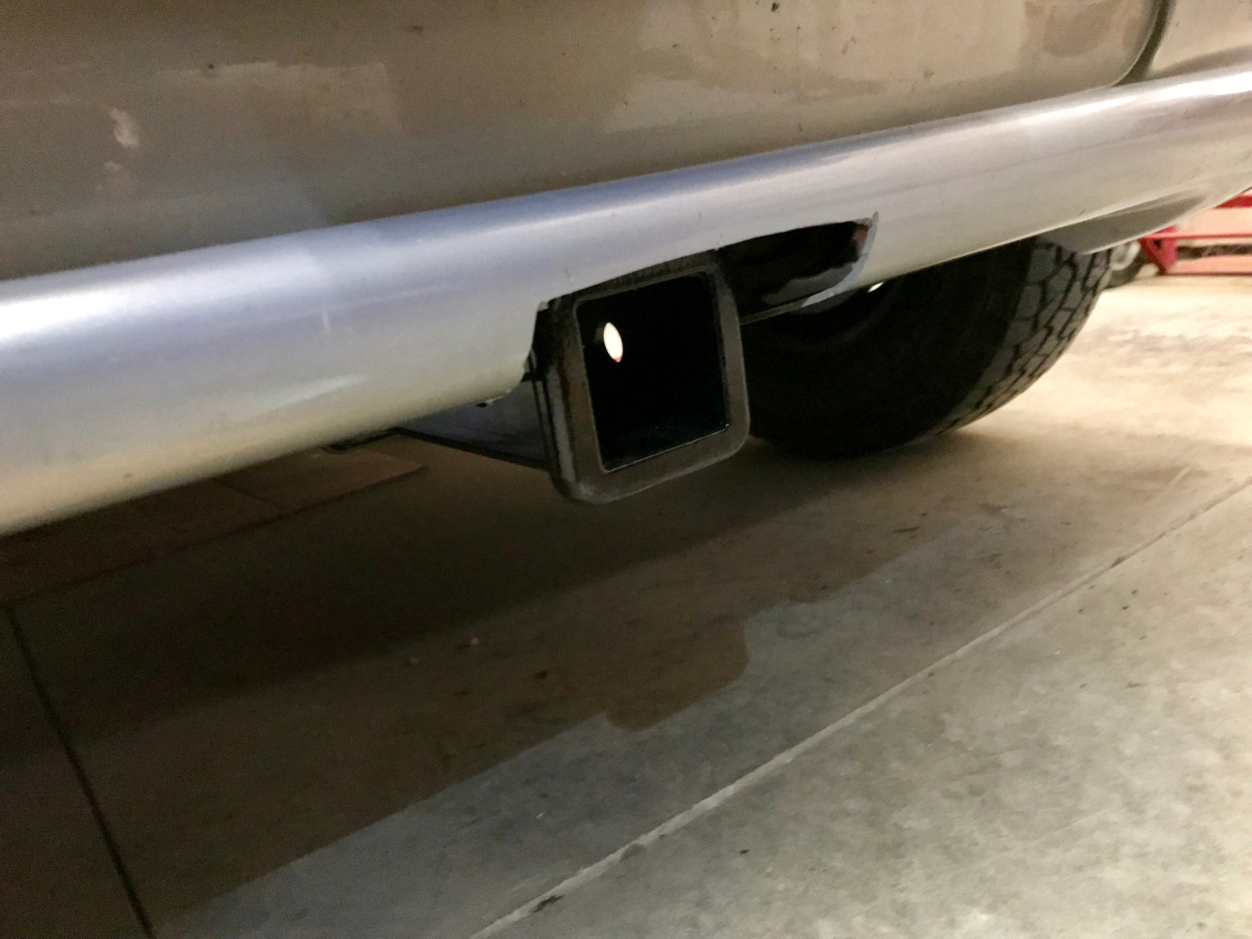

- I installed the Curt front receiver, part # 33055. This required that I drill larger holes in the chassis, extend existing holes, and cut though the bottom of the plastic bumper to make room for the 2 inch hitch.

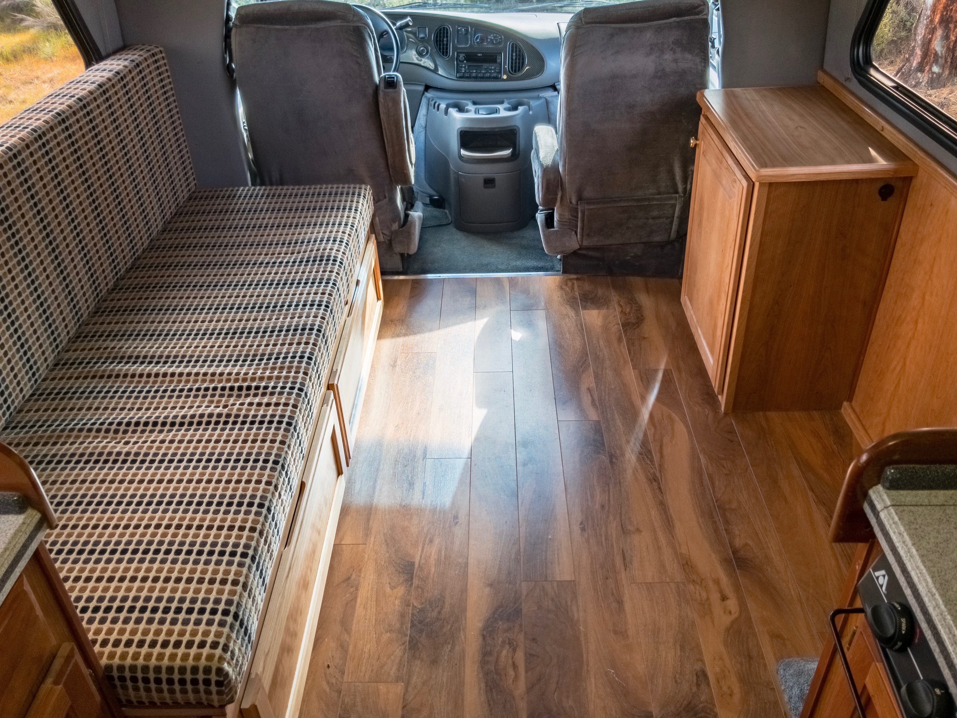

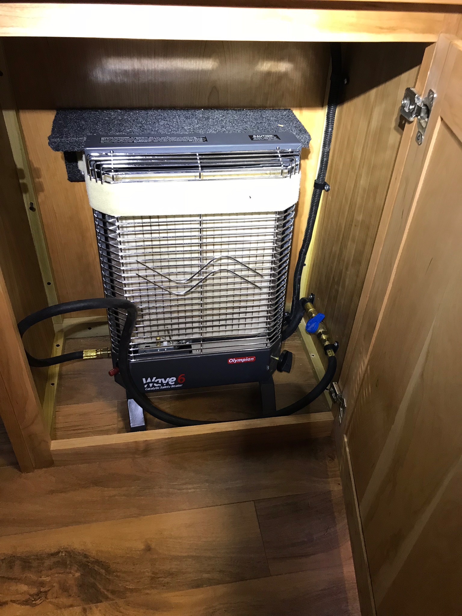

Update:
- New slat sofa/bed and cushions

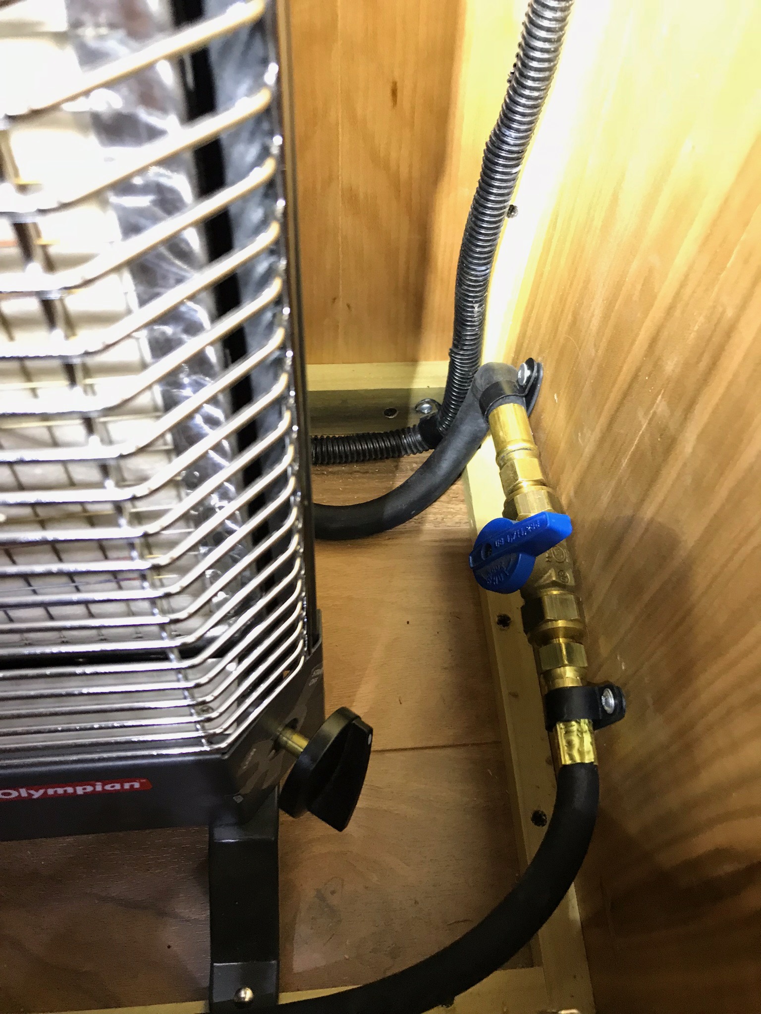

- New cabinet with Wave 6 catalytic heater and USB ports
- New wood flooring

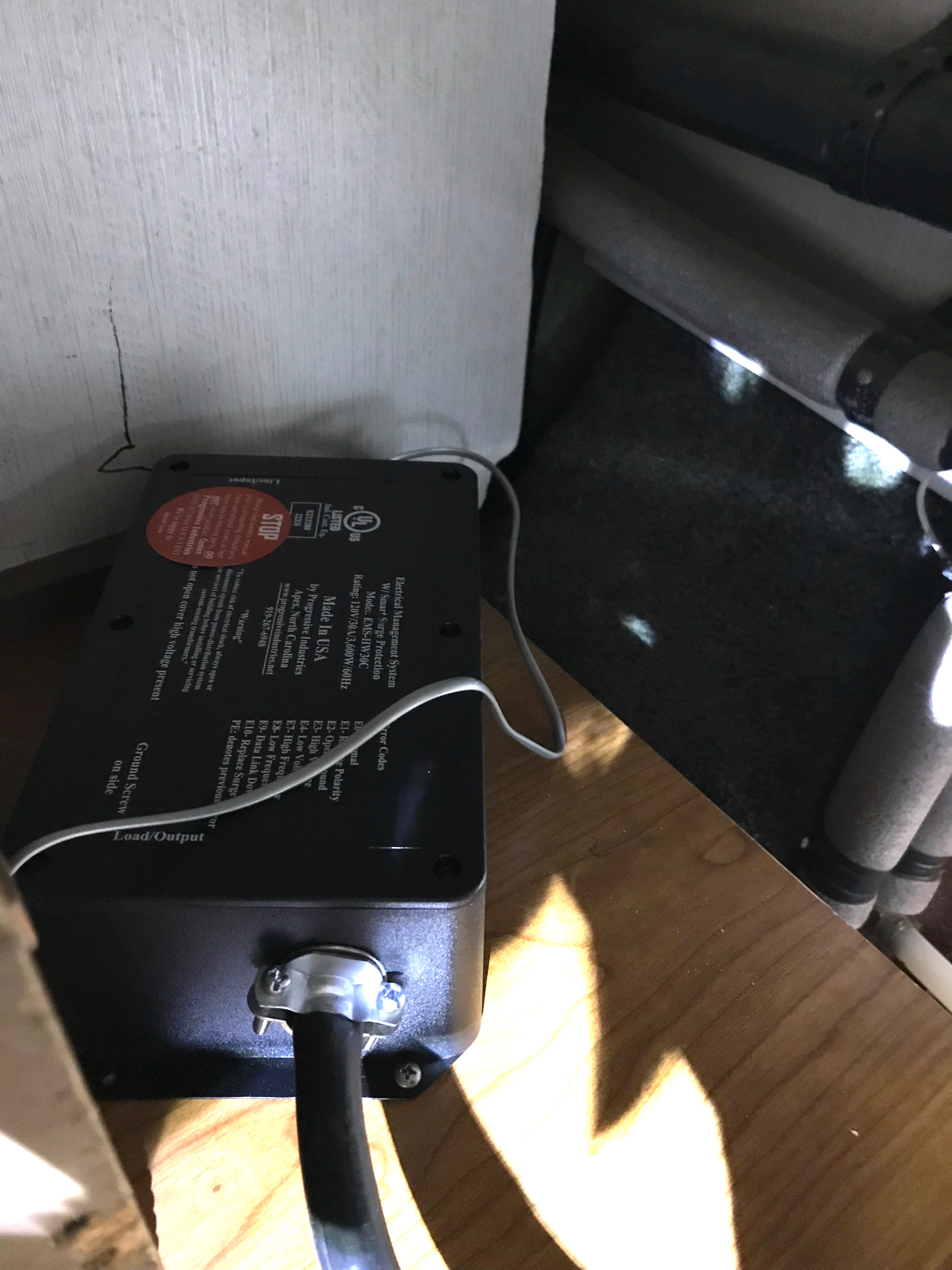

- Installed a Progressive Industries EMS-HW30C Hard-Wired Portable Electrical Management System - 30 Amp

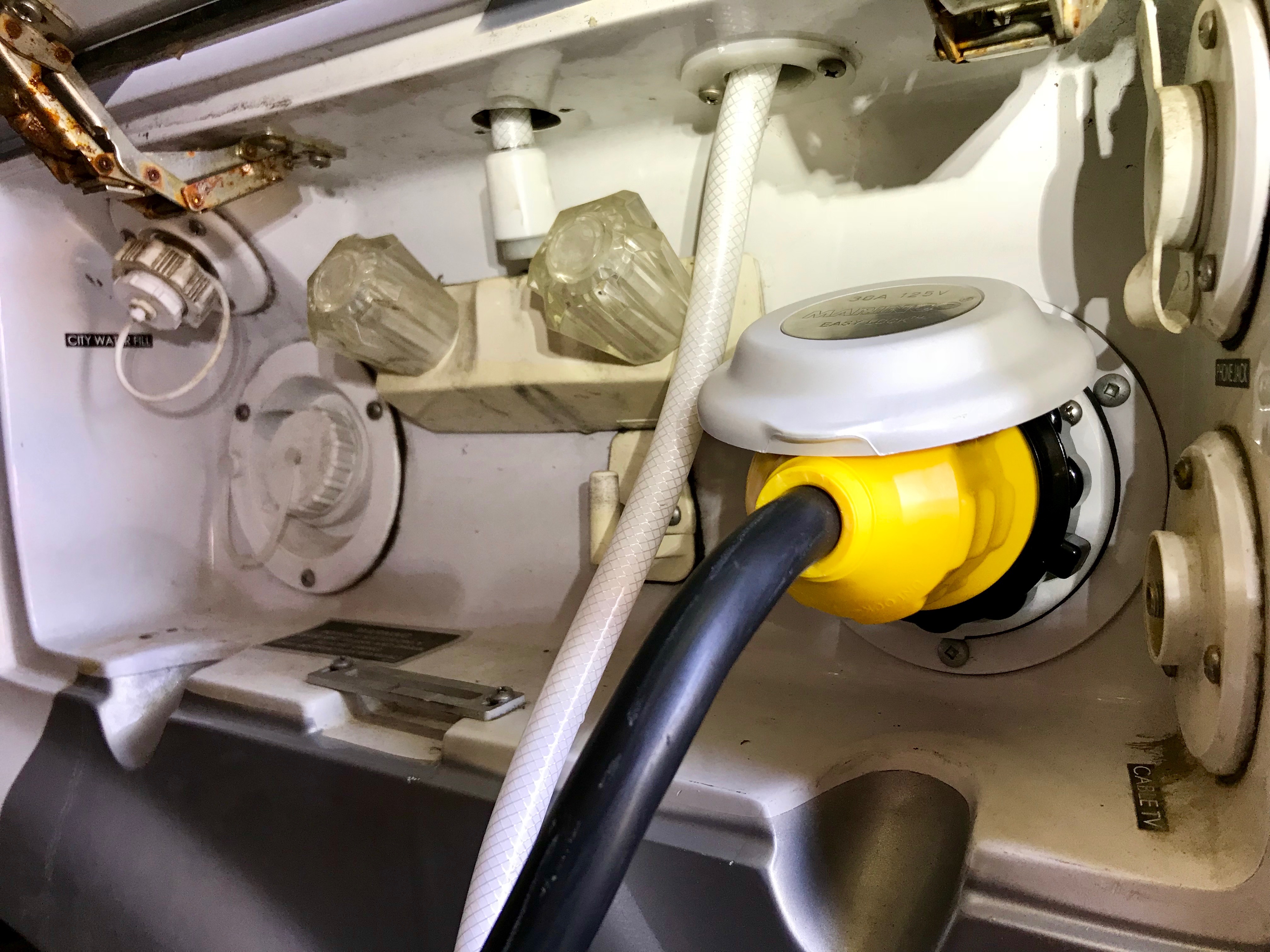

- Installed Marinco (30ARVKIT) 30 Amp Detachable Power Conversion Kit. This is a terrific solution for creating a detachable power hookup.
- New wood flooring

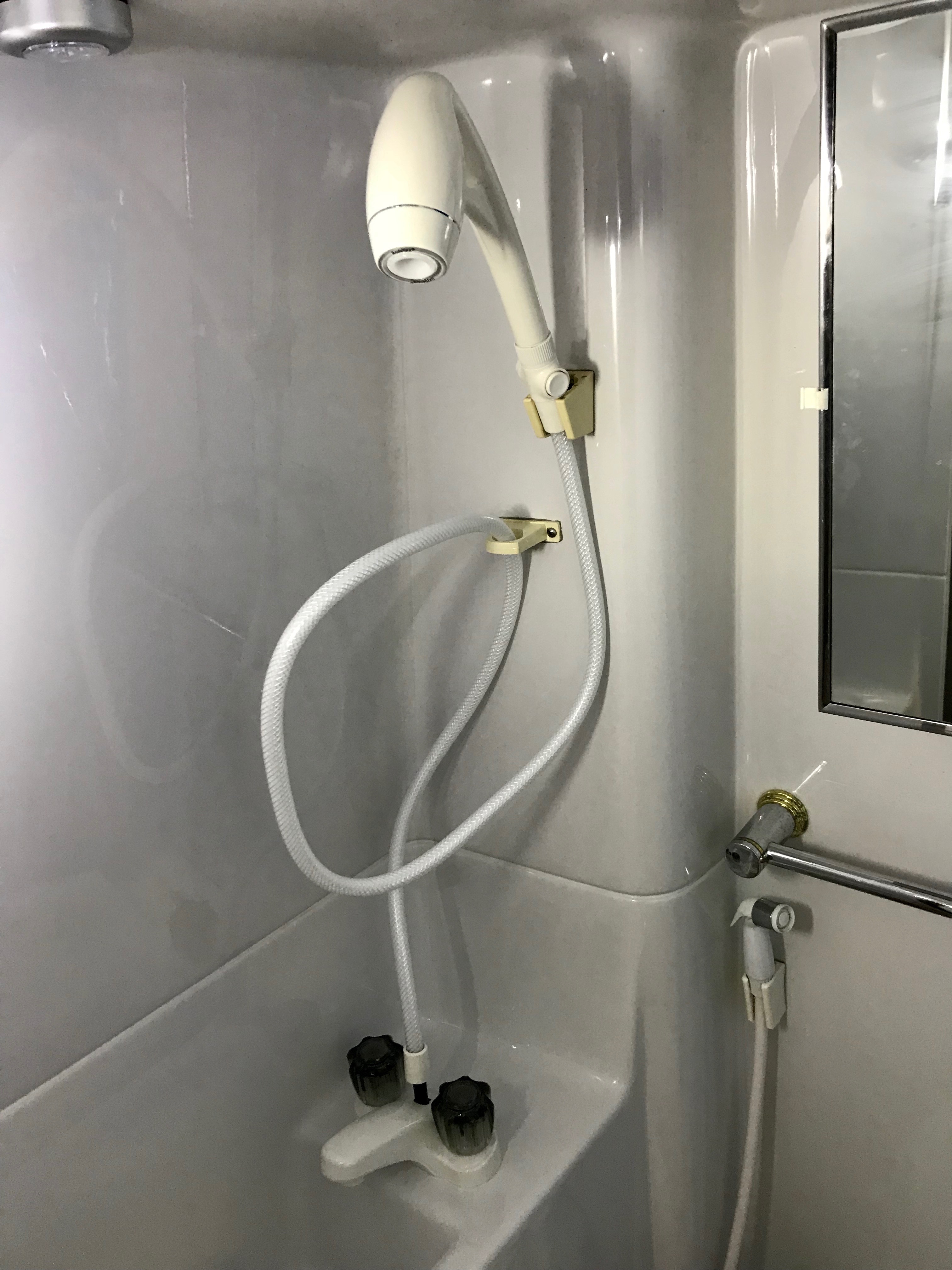

Re: Chinook Concourse 2003 Renovation
Here's a look inside the cabinet and upgrading the shower to the ETL 26781 White Body Spa Oxygenics Shower with 60" Hose
