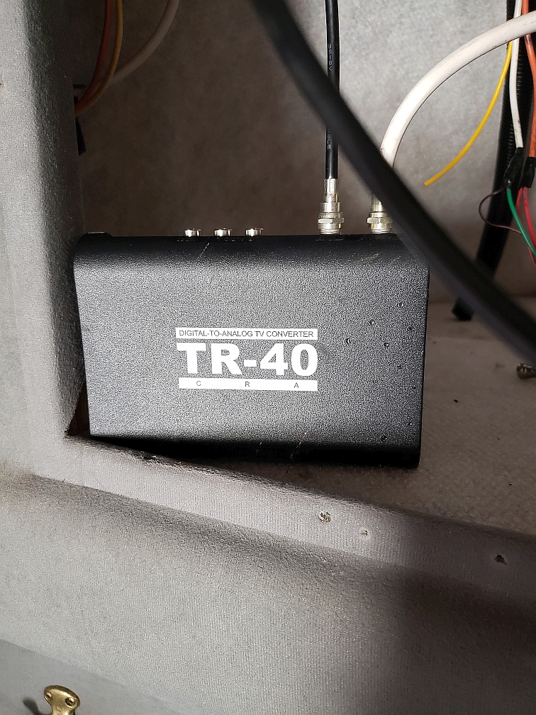

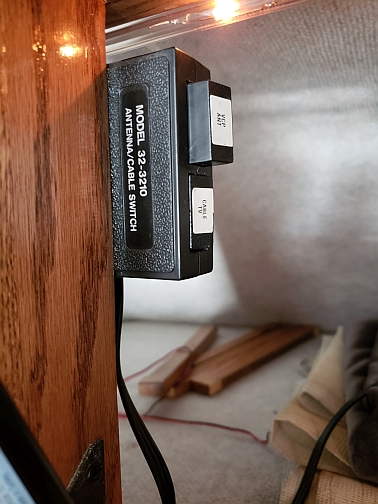

I'm so glad to find this thread! I'm in the process of upgrading the electronics in my 1998 Concourse, and the discussion and pictures are very helpful. I have removed the old TV, and I'll be replacing the stereo head, VCR, and an after-market DVD player next week. There are two items installed that I'm not sure about. (See pictures.) One is a digital-to-analog converter box, TR-40CRA, apparently from DISH. The other is an Antenna-Cable Switch Model 32-3210; this seems to have something to do with the Winegard antenna on the roof. I am guessing the DTA converter box is no longer needed, as I am installing an LED TV. Any suggestions or cautions about removing it altogether? The Antenna-Cable switch is probably still useful, since I have both the roof antenna and the option to hook up to cable in an RV park. What are your thoughts about that?
Thanks again for all your help!

I would do exactly what you do if I need to upgrade, ngpaski.

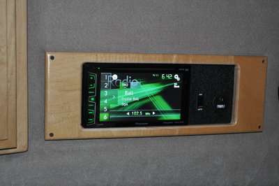

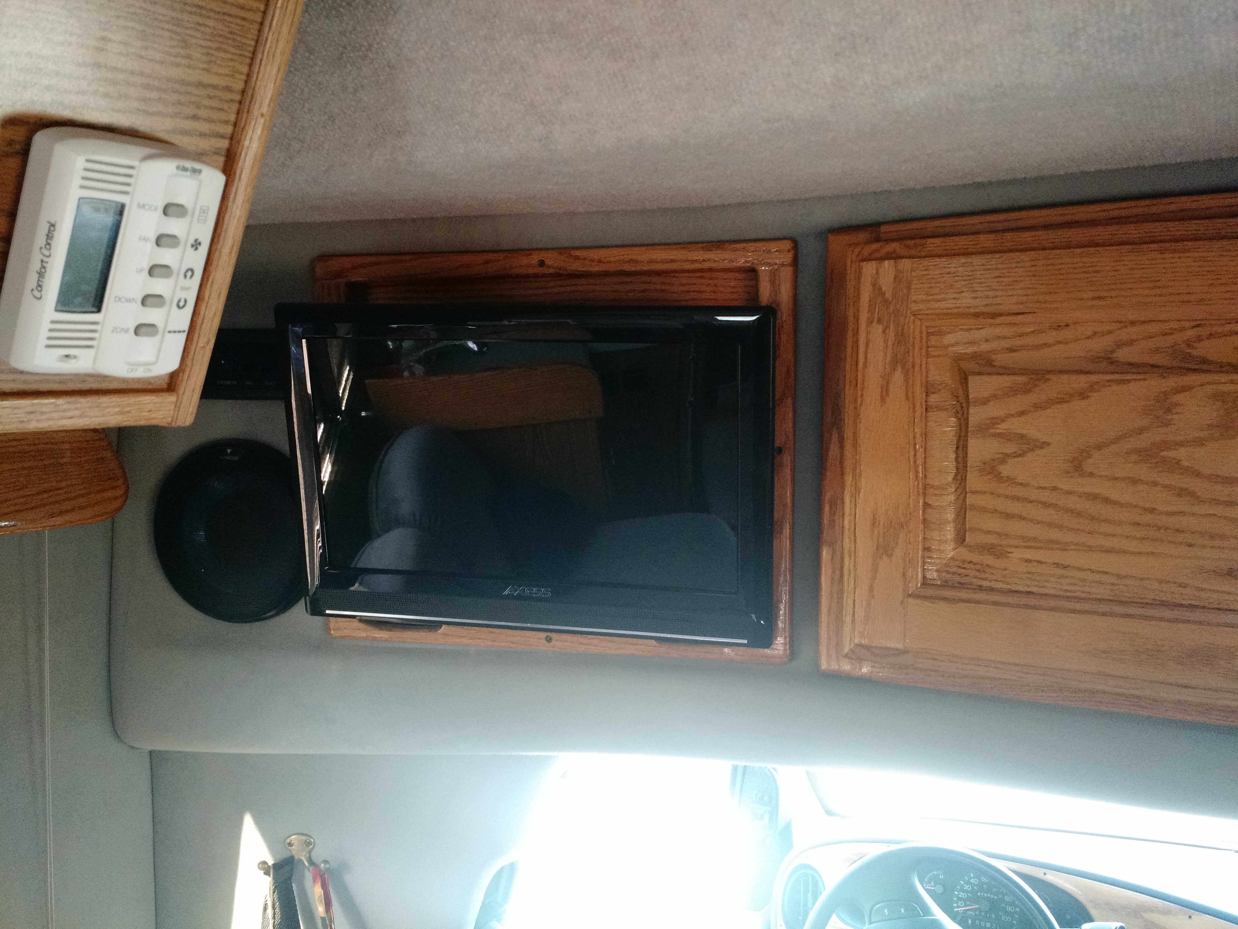

I installed an Axess 12V LED flat screen. I used the existing power wire from the old TV and installed a 12v outlet in the overhead. I also installed a Pioneer AM/FM/DVD w/touchscreen (Double Din) in the spot where the VCR was. I use the original cable/Antenna switch like shown in your picture. I rarely am where I can receive cable but like the capability. I hooked up the DVD to the TV and it utilizes the two speakers in the front overhead for nice audio quality. (The flat screen audio is tinny) I still have the old batwing antenna that works fine. (The term "HD antenna" is just marketing. OTA antenna's work as the always have with VHF/UHF)
Note: Even though the TV has a built in DVD player I use the DVD in the Pioneer unit instead as it has better sound.
A very simple setup that works well for us.

My setup is similar to SMan, except I replaced the house stereo with a unit that had a rear auxiliary input. The I ran the TV headphone signal to the aux input of the stereo so the TV sound plays on the stereo house speakers. I have SMan's old tape player (ours had some problems), and we use the DVD player in the TV for DVDs. We also kept the original cable switch and antenna, but we have never watched live TV on the road.
The TV is light enough that we don't need to strap it in, but I do need to tighten the mount hinges occasionally.
This is the TV we used (later model). I started with the 16" but it was too small. The 19" was much better, and still small enough to not get in the way or requiring strapping in. https://www.amazon.com/gp/product/B00G6 ... UTF8&psc=1
This is the mount: https://www.amazon.com/gp/product/B000I ... UTF8&psc=1
