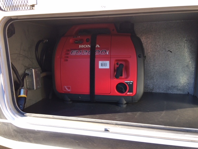

Taking out the old Gen was fun,fortunately our door frame unscrewed and was removed,I tried without taking it out and the Gen wouldn't fit through the opening,had to cut the 120v wires also, thanks for the tips!!
I put down a plywood overlay and screwed it in then undercoated all the openings underneath with a spray rubberized flexible coating and silicon-ed all around the inside.I used a cut fatigue mat over the inside bay floor to keep things from sliding around and strapped the Honda secure.
I then but a valve on the 1/4" gas line and connected it to a marine bulb pump with a 2' line that I can use to fill the Honda gen if needed, like having a 39 gallon gas can and no need to have one stored.
Then I put in a handy box and connected the 120v Onan gen feed to a pig tail that I connect to the Honda 2000i away from the coach, much more quite and not smelling up the inside when the door or windows are open.
Now I have room for camp chairs and table and a small BBQ..

Did you run into any issue with the grounding? I cannot quite remember all the details now, but there is something about Honda generators vs. shore power or "internal" generators that is different vis-a-vis the ground/neutral/bonding. Gah, I hate it when I knew something but now I can't remember it but only a vague half-gist. So irritating!
Edited to add: Okay, I haven't re-read this and thought about it again (since a few years ago), but there might be something in here of interest. Or maybe not because the ATS is taking care of it....
Anyway, I'll be re-reading it just to get my mind around it again.
http://noshockzone.org/generator-ground ... l-bonding/
Re: Generator replacement
Posted: December 6th, 2017, 6:37 am
by autox
Thanks, great article on this, I hadn't really thought about that but I think all is ok..
Apparently the Honda 2000i is a "floating" G-N and since I'm using the old Onan input to the ATS it automatically does the G-N bonding, If I was using the shore power cord that could be a problem. I'll check it with a 3 prong tester next time I hook it up. I'm sure other folks have hooked up a portable Gen to shore power cord, wonder if they have had problems. I guess it depends on if their Gen is floating or bonded....
