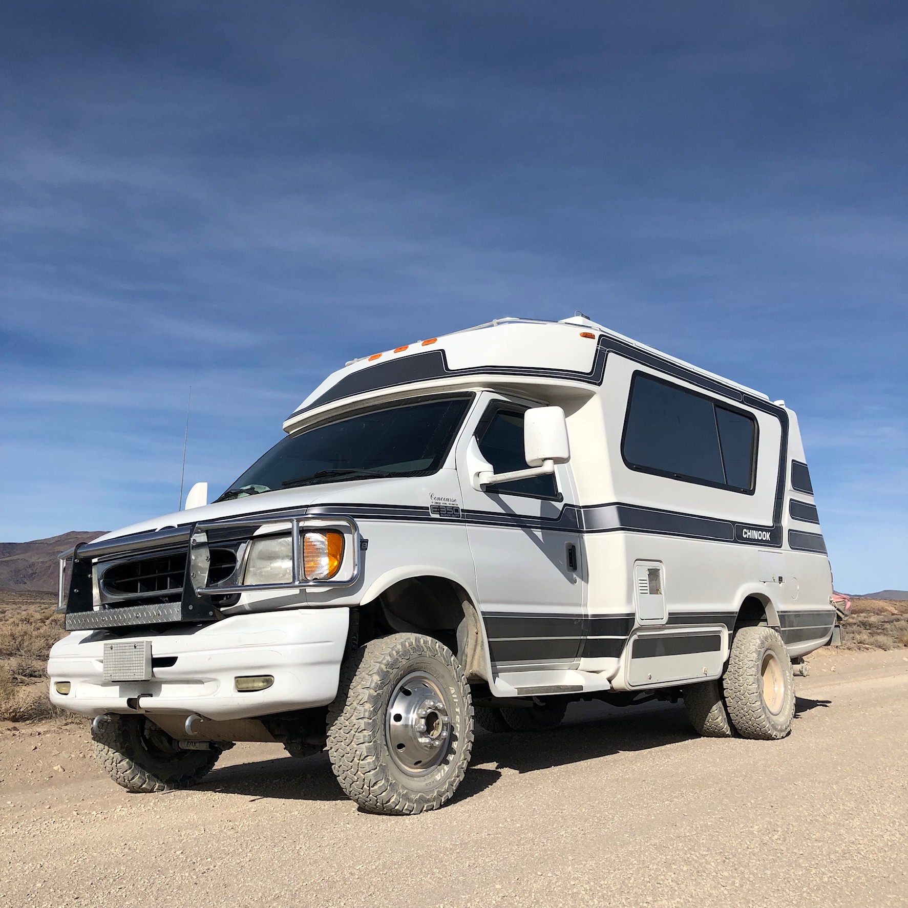

Hey, I've been busy going thru my Rigs getting it set up. I was able to get the Refrigerator straightened out by replacing the board with a new one by Dinasour .The Fridge really works Great and I'm making Ice on the Mid#3 setting.

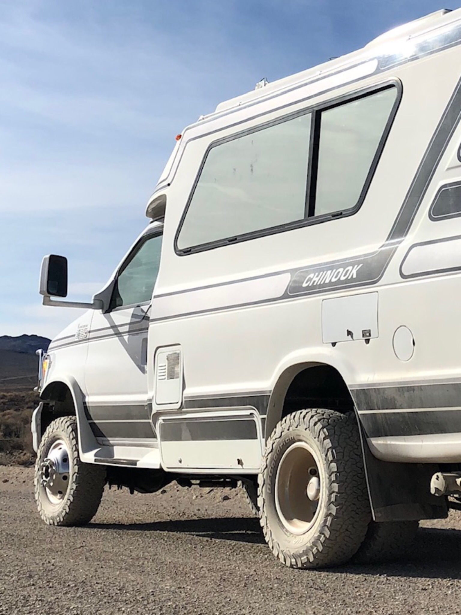

I wasn't Completly confident with the Grabber AT2s that came on my rig. I could feel the side walls Flex and the ride felt soft all around . I went with some new 265/70/16 BFG AT2's. I've Never have regretted running BFG's on any of my Jeeps or Trucks.
I also contacted Agile Off-road and picked up a set of their 2.0 Agile Offroad Tuned Shocks to replace the Rancho shocks that it came with.
While I was under it I realized that I had a Fox 2.0 steering stabilized left over from my Rubicon. So I bolted that in as well.
Now I can Honestly say "My Chinook is The Sports Car of Rv's let alone a 4x6 Powerstroke Beast !

Great pics! Good to hear the BFGs are working well. That's a good option for a E-rated tire, I put 4 on my old ambo and it drove great. I've been thinking about them again for the Chinook. Were your Grabbers E rated?
Re: Chinook 4x4 7.3 Diesel
I think that the Grabbers had a load rating of 2400lbs at 44lbs air . The BFG's are a 10 ply LT tire rated at 3400 lbs at 70lbs of air(Approx) .
The Grabbbers felt "Soft " when going thru winding roads or entering driveways ect . The RV felt like it was wallowing around .
I did both the BFG's and the Agile offRoad Tuned FOX Shocks at basically the same time . So I'm not sure what upgrade gave me the Best results ? But I can say" The Combination Really made a Huge Difference in the Handling of my Rig" !
Its Super Tight now and I don't have to worry about my Dogs getting tossed around in back just pulling into a parking lot !
