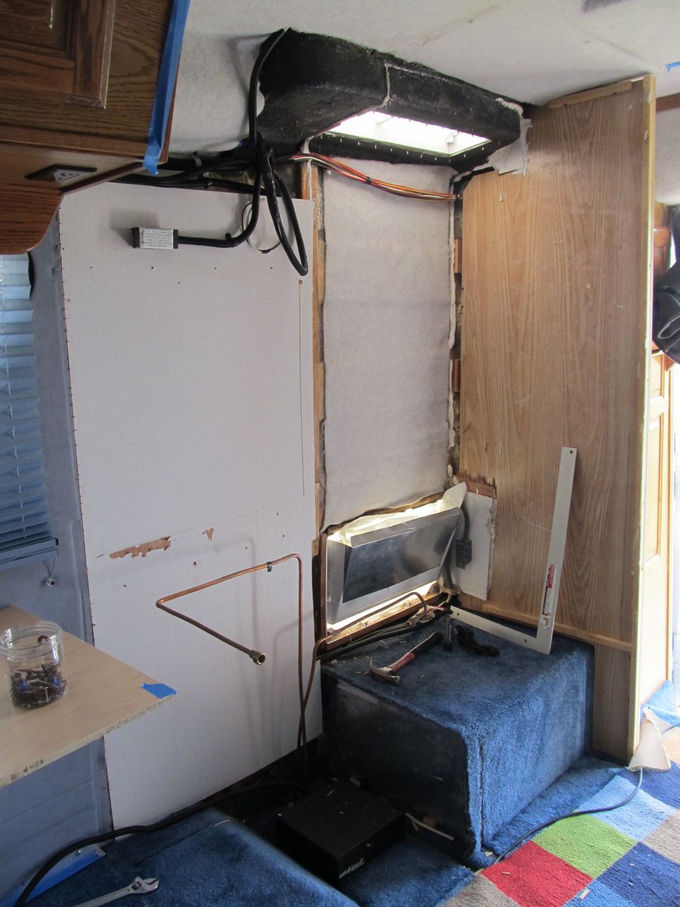

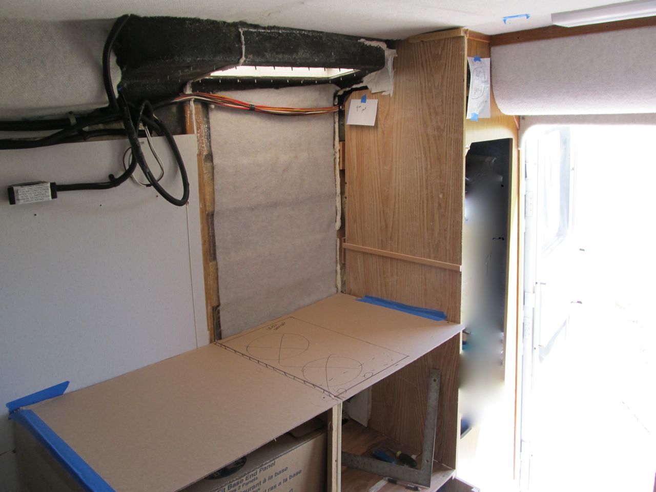

Backing up a bit, here is a shot with pretty much all if the stove/fridge stuff out - I would have loved to see a photo like this before starting in:
Here is a crude mockup of an extended "counter height" counter:
And here is another ridiculously crude mockup of the option with the taller fridge and "bar height" counter to the right, and regular stove counter to the left.

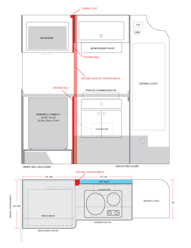

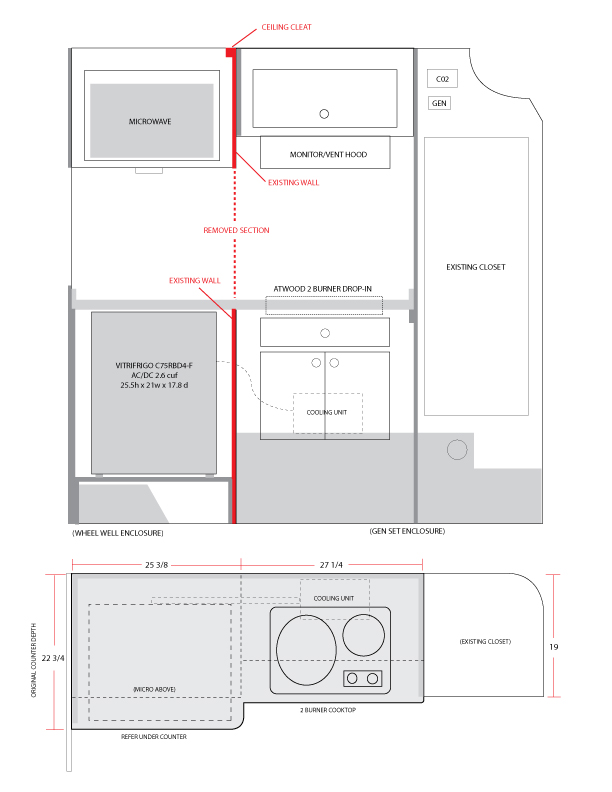

Blue-Go... need your take on the ceiling attachment points for the microwave cabinet and forward wall of the old fridge. My micro cab has been reduced in depth to 19". Width and height are original dimensions.
My concern is, by cutting away the center of the old fridge wall to allow for the straight countertop conversion, I would be relying on the one wood ceiling cleat to support the aft side panel of the microwave cab when it's reinstalled. There are several existing attachment points to the dinette overhead cab section and the back wall. If need be, will the ceiling accommodate new cleats for the front and that side panel? I don't want screws popping out the exterior of the roof :o . I've heard (not verified) that the Chinook roof is a "sandwich" of two fiberglass layers (ceiling and outside roof) with foam in between. ?
Any thoughts/info would be appreciated.

Thinking: How would I do it if I were doing the continuous countertop and wanted to keep it rigid?
Well, first of all, I would make the countertop be a structural member, by having something like ledgers just under the top and connected to the horizontal wood strips that are now behind the stove. I would also connect it to the vertical strip that is behind the existing fridge/stove bulkhead. Then I would tie to the closet wall, but the closet wall is not really tied to the coach by much. Then the upper cabinets would be anchored to the ceiling wood strips, and to the vertical piece that is now at the fridge/stove joint. There is also the back edge of the ply that surrounds the window.
But this all still leaves you with an unsupported "middle area" (i.e. the wall between top of counters and upper cabinets). Plus a slight stress riser at the top of the counter. I think I would still leave a slight bit of the plywood bulkhead, connected to the vertical strip firmly.. That's just me. One could go all out with tabbing and stringers etc. and eliminate that, but if you don't mind having it (the slight plywood divider) it is simple and sturdy. You'll see in my "functional mockups" that I left a "C shape" in that bulkhead, and I am very happy with how firm things are. I think that's a good way if you can be happy with that slight "septum" in your countertop. (You'll see in the photos.)
Let's keep discussing - it's fun :D

Blue_go,
Thanks for the schematics! When I get my rig back, I'll take a close look.
Yes, I was planning on using horizontal supports to tie the countertop/cabinets/closet together.
I like the idea of a vertical "septum" support. It solves the need for a continuous structural brace, it's not obtrusive... and, it made me realize the need for vertical "VENT SHAFT" space for the remote cooling unit at the cooktop back wall. The little bump-out at the back wall could also serve as a side attachment point for an additional "galley rail" spice rack under the microwave. My original plan had that wall up against the interior of the outside shell (duh). Proves that doing actual mockups is a better way to getting a clear picture. Here's a revised drawing. Take a look and see if this is what you were suggesting.

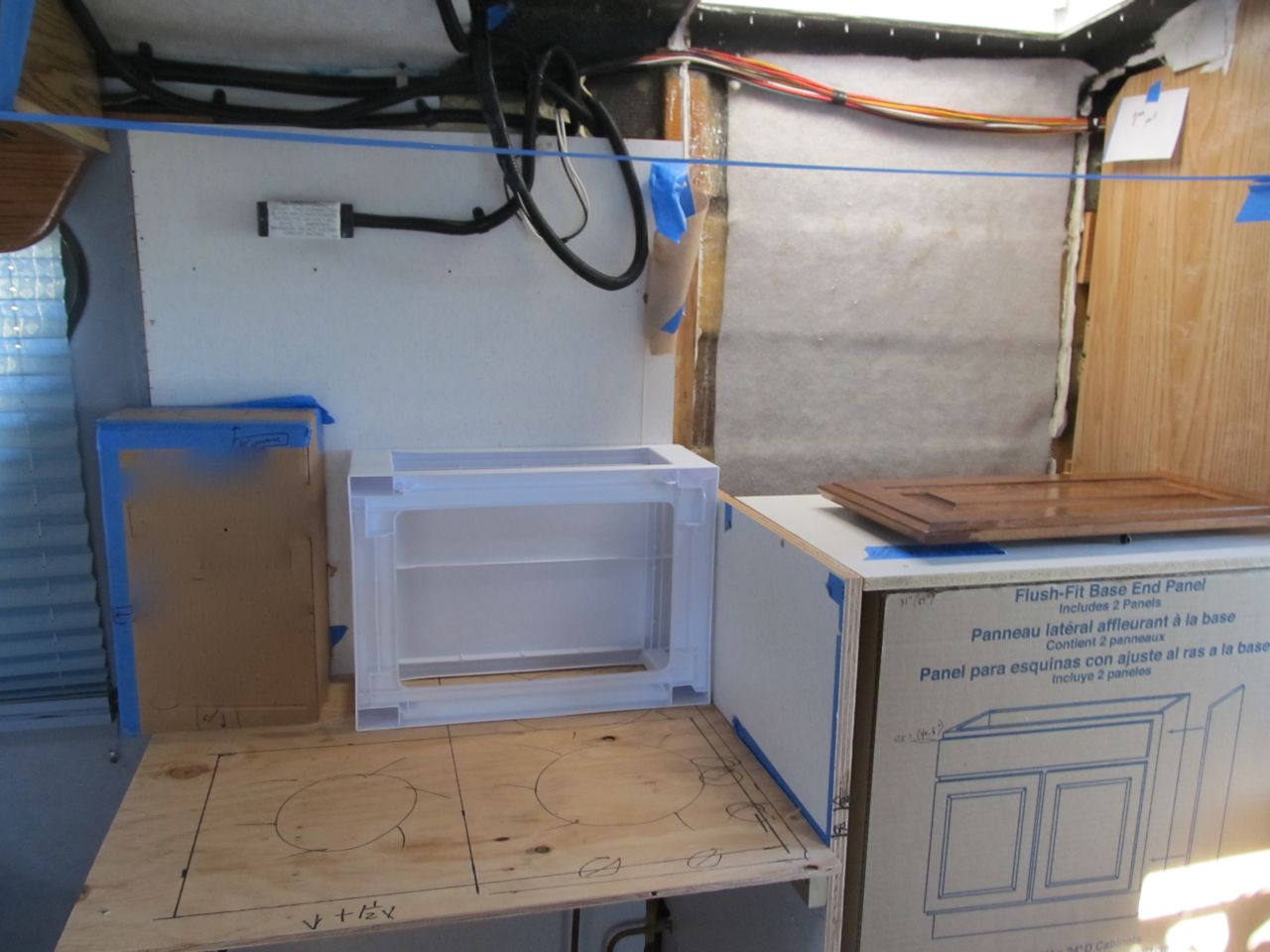

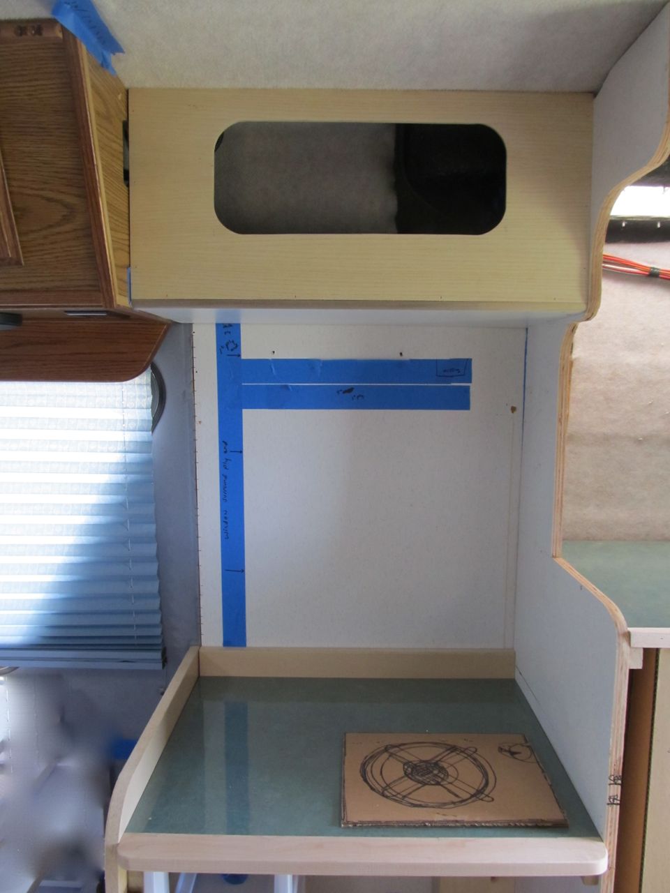

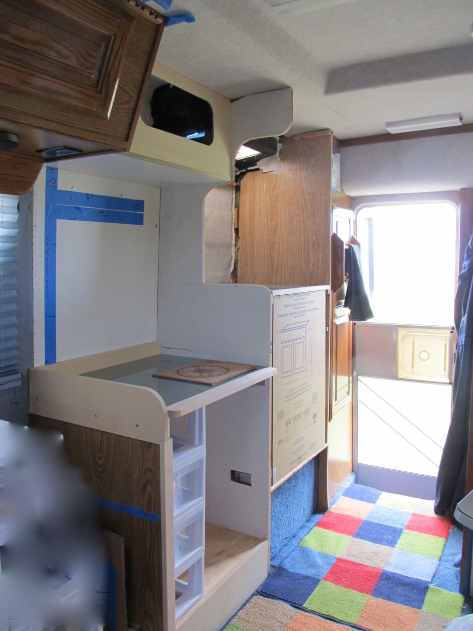

Okay, back with photos. Keep in mind that these are "functional mockups," and they are not even finished yet. But I think they will be helpful to the discussion at this point, so I'm posting them. I also re-named the thread to better reflect what's being discussed (and this makes sense, as switching to a compressor based refrigerator naturally leads one to consider the entire configuration of this side of the kitchen).
So, here we go. First an overview, and then some details about the "structural tie points" in the walls of my rig (which closely match the Chinook diagrams).
Here we have the mockups as they stand now. The cardboard box represents a Vitrifrigo 4.7 cubic foot refrigerator/freezer with separate compressor. The upper cabinets above the refrigerator are not in yet, even in mockup form.
So, as you can see, I have removed the oven (at least for now), and raised the stove counter to 34" (from 31-7/8"). The microwave cabinet and range hood are gone. I will end up with some sort of range hood, possibly vented (for real!) out the former refrigerator roof vent (where the Vitrifrigo compressor will also vent). There will be some more cabinetry over the "fridge counter." Under the stove is undecided pending a decision on the stove, and do I want huge bulk storage (folding bicycle, dive gear) or more usual things such as drawers, or maybe the oven back. Ultimately I will also replace the face wall of the closet (which is crooked now), but it will likely just be a better/lighter/straighter version of the original. Hence, no need to mock up anything.
I wanted the bigger fridge, and I also wanted an "entryway staging and landing area," more than I wanted more kitchen counter height counter space. I'm used to boats, so even the original counter area was fine, and if I go with the smaller cooktop, the counter space will be tripled even without using that over-fridge counter (of course it CAN also function as kitchen space, but I mean if I had really wanted it to be "always kitchen," I would perhaps have made it all at counter height.
I planned the fridge compartment so I can add some additional foamboard insulation around the fridge, plus it ties into the "wall wood" strip. It's basically around 1" aft of where it was, and I may move it another 1/2" or so aft in the final iteration (once I have fridge in hand).

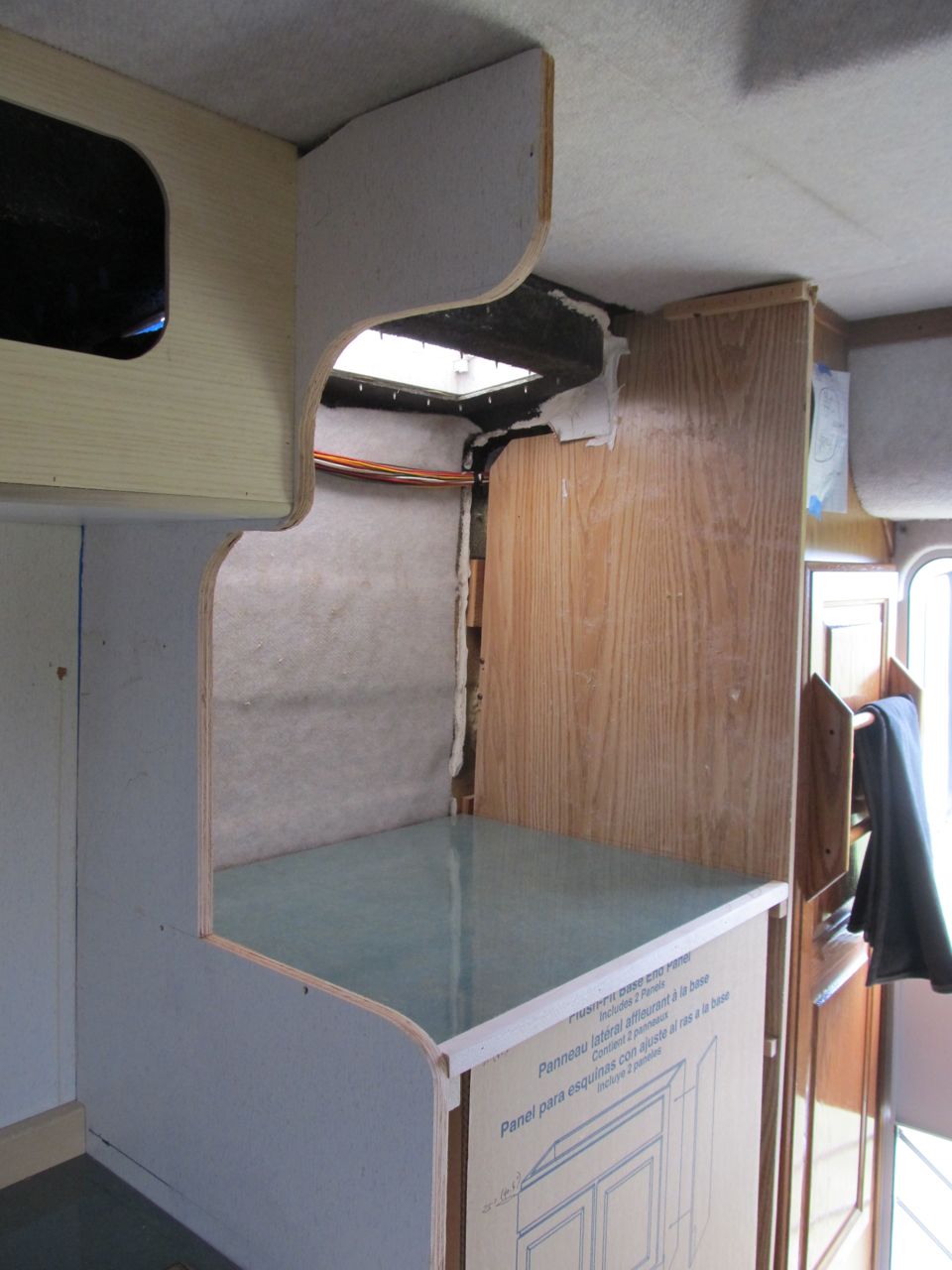

Here is a face-on view of the stove area:
This is with a mockup one-burner cooktop; a two-burner will also fit fine, but with less counter space. I am going to use a one-burner portable stove I have for now to test out how I like that, and how much I miss a second burner. Also, if I do go with the single burner, I'd keep the portable for a second burner in a pinch, and (more useful) to be able to take it out to a picnic table for hot days, just because I feel like it, to cook fish, etc. The upper cabinet is higher and shallower - may bring it back out a bit but I was so sick of that microwave box/hood in my face that I went "plenty clear" for now.
Similar view of fridge area. Yet to be designed is the stuff above this. This countertop is around 45" high. I may be able to bring it down an inch or so once I remove the 1" of carpet/padding on the generator and use actual soundproofing material.
The "septum" piece may change - this was just roughly cut out of the original board. I may continue the above-stove counter top right aft - not sure yet.
