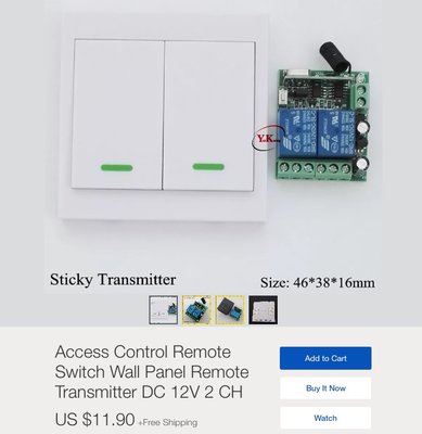

Re: adding light switches. Instead of fishing wires and adding wall switch holes, two other possible options:
1. Use an inexpensive overhead person detector to turn on/off the lights automatically. I still count this as my favorite bathroom mod. Open door, lights come on. Exit, and the lights time out.
viewtopic.php?f=4&t=299
2. Use a 12v wireless switch set. The wall switch runs off a battery just like a key fob, and can be stuck anywhere. The wireless receiver and relay(s) runs off the light wiring.
Here's one on eBay with two switches and two relays, perfect for the bath light and fan, or two sets of lights.
wireless switch
wireless switch
There are also lots of variations with key fobs and dimmers. Fobs can also be wall mounted. My main cabin overhead lights are each on a wireless dimmer receiver, all programmed to respond to the same fob.
Some come with two fobs, which allows you to use the extra fob as a second remote control at the other end of the cabin, just like having a set of threeway switches in your house.
Just throwing these out as food for thought. As the saying goes, if you want to find the easiest way to do something, hire a lazy man :D
Cheers, Kev

A friend thought I should be concerned about potential electrical shock issues if wiring a wall switch to the new puck lights. It is after all a "wet bath" (something about water and electricity together... :shock: ). Kev's ideas for the motion detector or even the wireless remote may be the way to go (?)...
Blue-Go, curious to know what boaters do?
