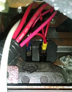

Bingo! That's the reason that I couldn't find the smart solenoid and the LVD on my rig, they didn't come out until 1997 as I was told by Kevin, a 1994 Chinook owner. He also had the two switches like mine, of which he sent me pictures of the front and back of the switches. Only problem was that it looked like someone had replaced the wiring and used all red wires.
Now that I know about the smart solenoid and LVD, I can quit trying to find them. Kevin thought that my loose blue wire should be connected, along with a red wire to the emergency start switch. Do you agree with that. Then until I can find out where the other loose wires go, I'll just tape them up out of harms way. I still plan to follow your procedures for testing out my dc charging system.

Actually, until I saw your post on the Yahoo! forum, I didn't realize you were still looking for the smart solenoid/LVD. I should have been more clear earlier that with your two "simple" solenoids, you pretty obviously weren't going to have those other things.
Disregarding the fact that the wires might change color as they come through the firewall (which you can see if you can trace), then yes, the blue wire from the right-hand solenoid would go to the "emergency start" switch. I'm not sure from the diagram which color would go to the "use/store" switch, but the function of that is to connect or disconnect your DC loads (or most of them anyway) from the house battery when the rig is in storage.
The combine-when-driving/separate-when-camping function is the left solenoid and the orange purple wire, but that wouldn't go to either of those switches, I wouldn't think (because it's supposed to be automatic).
So in other words you are talking about three functions here, and two switches.
Function one is "emergency start," which combines the batteries when you want them both for starting. This is right solenoid/blue wire and the left switch. This is not likely something you'd use often (and there are always jumper cables) so to me it would not be a super high priority (not saying not to have it working, but it's not "necessary" to use rig). You are more likely to run down the house batteries when camping, and the function of this is for when the START battery is not working and you want to jump it with the house battery. Jumper cables would do this no problem (and could also be used so another person's battery could help you).
Function two is combine batteries when engine running (for charging house battery from alternator) and separate them when camping (so you can't run down the start battery and then be stuck). This is the orange/purple wire and likely no switch at all (it probably just wires to ignition and combines when ignition on and separates when ignition off). You want this to work, but you can test for that and there is likely no operator switch to make it happen. If the solenoids are broken, you can wire in a manual switch for now, if you want to keep the costs down.
Function three is separating house loads from house batteries (like when you want to store the rig and don't want any phantom loads running batteries down). This is the right hand switch and then not sure what under the hood. This function (at least in later Chinooks) never really cut off ALL loads. The manual cut off switch your PO put under the hood probably does cut off all loads, so in that way may be preferable to the right hand dash switch anyway. So if it were me I wouldn't worry too much about the right hand dash switch.
