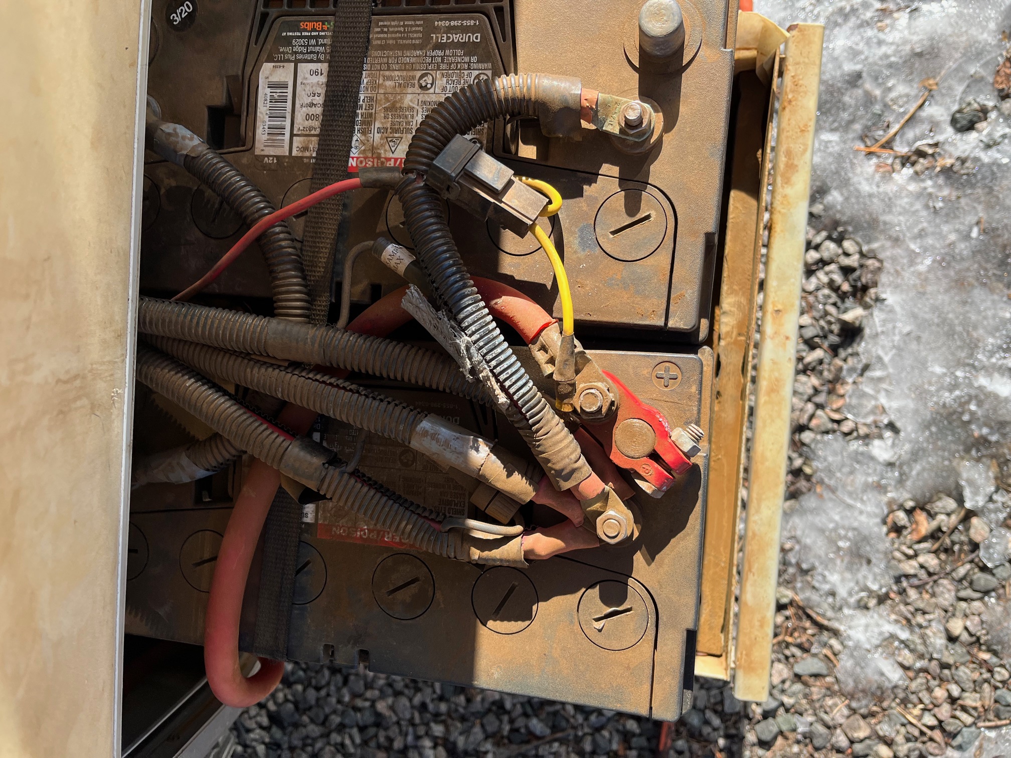

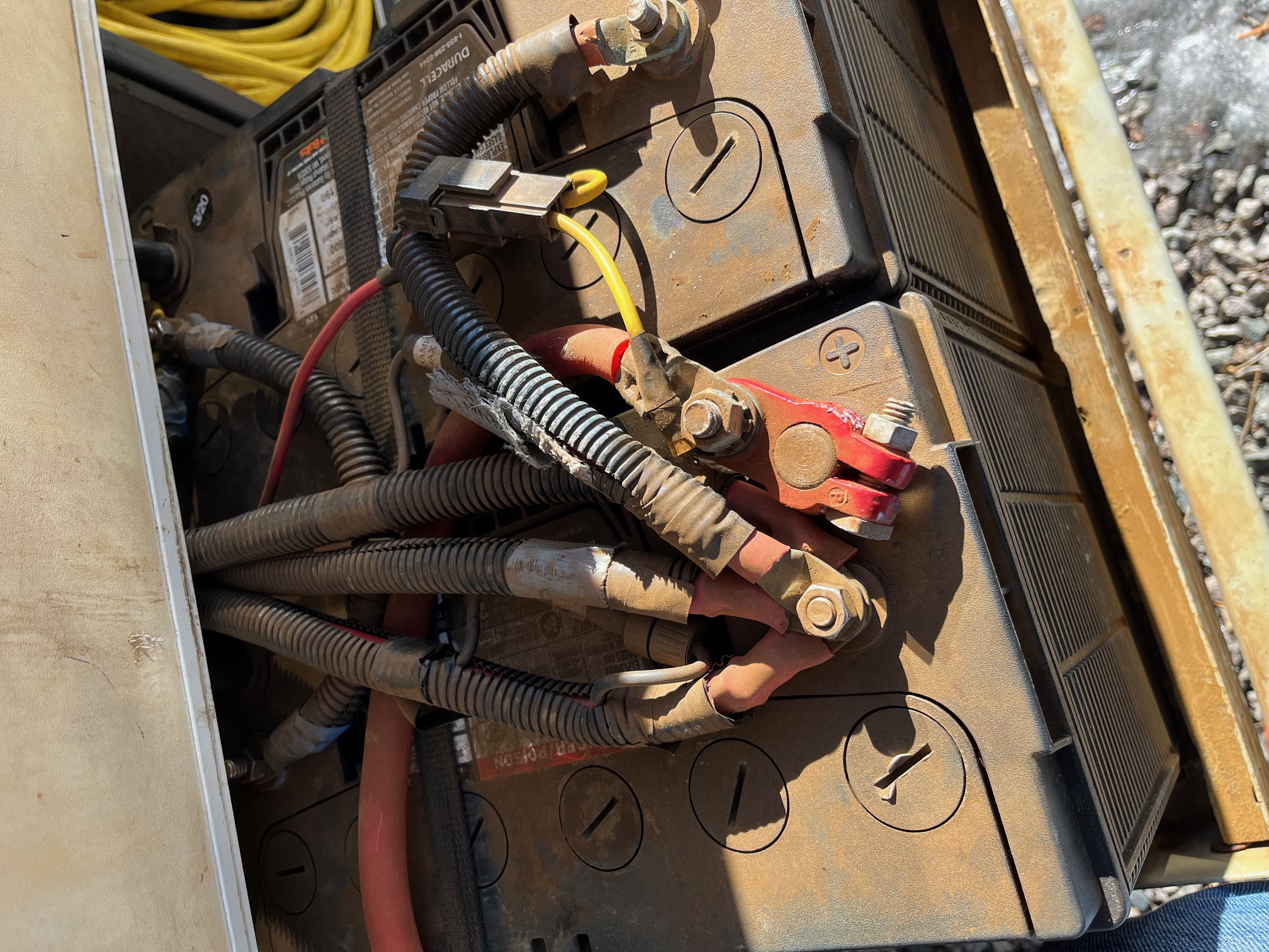

Picking up where we left off, I'll attach some pics of the "Spider Web" currently on my House Batteries. Clearly speaks to the need to clean things up in terms of connections and fusing. I had a talk yesterday with Eddie (the Custom Van Guy doing the install)...he is "on board' with all we have discussed regarding the IP22, Orion XS, dual 4 awg from Start to House, Smart Shunt with temp sensor...And he had a suggestion as to how best to address the wire clutter. He thinks I should run all of these wires through a Lynx Distributor. Neat, clean, and works fine with the rest of the system (Chargers, Smart Shunt IP21). So, I looked at it...makes sense to me. Thoughts?
But now those "Spider Webs" have me nervous about cutting things out of the system. I mean, how the hell can I tell whether those little lines (red with yellow in line fuse) from Pos, and small black from Neg are the "long skinny" or solar direct connect that I had installed...and which one of these wires from the pos go to the Blue Sea? The only one I can identify for sure is the 1/0 inverter line!
So (going against your "SO CLOSE" urging, and LVD removal begging), I am actually reconsidering leaving the LVD and Blue Sea "as is." I understand that there would be issues of interference between the Blue Sea and Orion XS IF Blue Sea was operating. BUT, if I were to use the manual shut off and keep it off, those things would all go away. And I could effectively combine a few things--like Solar and Blue Sea loads, and Orion XS and IP22 loads on a single lug on the Positive bus of the Lynx Distributor (Orion and IP22 won't ever run at same time) to have everything fit onto the Lynx.
I know this would be stopping short of perfection...but...
To do the full Blue Sea and LVD elimination, I need more encouragement and specific advice as to how to go about it without screwing it up.

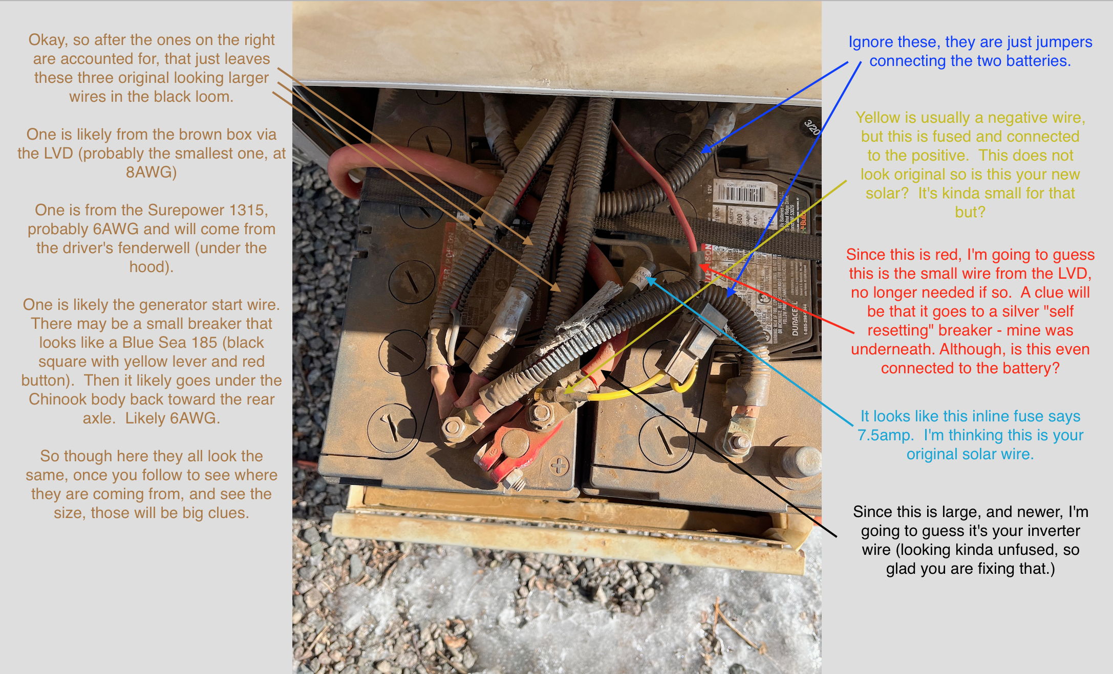

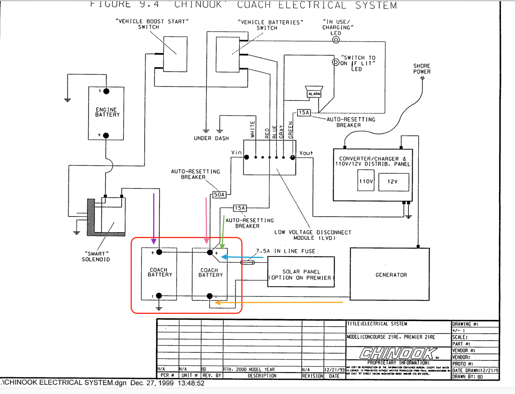

Where I would start this is at the batteries. You aren't living in the Chinook right now, I presume? So rather than approach this from the angle of adapting all the old stuff slavishly to the new setup, I would pull everything off the batteries, while identifying things as you know what they are and labeling them (hint: Look at the Chinook wiring diagram). As I remember it there was not that much. So you pull everything off the house batteries and then organize/replace them. Ignore the LVD - that's going away so you don't really care. I can give you a start, just based on the original Chinook wiring. Here is the diagram from the 2000 Manual. I'm sure yours is very similar (tho as I type I can't see the year of your Premourse).
We are talking about the positive wires for the most part here:
1) Look at the Purple arrow on the diagram above. This is a red wire, IIRC 6AWG, that comes from the Surepower 1315. You will be discarding this. Buh-bye. (Extra points if you pull it out and toss it.)
2) Now look at the pink arrow on the diagram. This is an 8AWG red wire that comes from the brown box (through the LVD and a crusty, crappy self resetting breaker mounted below, which you will be FORGETTING ABOUT. You'll be tossing this wire out and replacing it with a single wire from the brown box (either by extending the wire that is on the LVD now, or MUCH better, by running a new, 8AWG red wire behind the water tank straight from the brown box to the new fuse that will be protecting it (from there a main wire goes to the battery).
3) Now look at the green arrow on the diagram. This is going to be a smallish wire that comes from the LVD. It also goes through a crappy self-resetting 15a breaker. So, you can tell this apart from the (also small) original solar wire because the solar wire has a 7.5 amp inline fuse on it right near the batteries. This wire can be taken out and discarded. Buh-bye. I'm feeling cleaner and tidier already ;)
4) Now look at the teal arrow on the diagram. If you still have it, this is the incoming wire from the original roof solar panel (via the original solar controller). This has an inline 15a fuse, so that's a clue. There is a corresponding negative wire that comes with it. Feel free to eliminate this and it's solar controller if you like. Or put it back, using a small fuse on your Safety Hub 150 (or a separate small fuse block if you use the Lynx). No need for a bunch of inline fuses floating all over the place.
5) Now look at the orange arrow on the diagram. This would be a 6AWG red wire that comes from your generator starter. That you no longer have.... I can't say how they fuse this on yours because in my era it went up to the start battery. But they used a small breaker that looks like a Blue Sea 285 on mine right near the start battery, so maybe you have one of these near your house battery.
Although I don't love the heavily stranded wire they used for this (certainly don't put it into a Victron terminal), if it's long enough you could re-purpose it as the wire that goes from the house battery to the brown box (since you no longer have a built in generator) if you wanted to.
That's basically it. Anything else is a new added thing and if you like, we can suss it out. Like maybe your new solar. I'll stick with you. I just finished helping a friend with a job where we had to identify like 75 completely inexplicable wires. We got them all figured out. Process of elimination. In this case we have the Chinook diagram, plus knowledge of many Chinooks. Yay. But so how about you find and remove all of the wires listed above? Label them (blue tape or whatever, just for now). Plus your 1/0 inverter wires. Now is there anything left? Show it to us here and we will figure out what it does and if you need it anymore or not.
(You don't need any of these in place to drive the Chinook, as we are not changing the Ford system here.)

deppstein wrote: January 30th, 2025, 11:26 amBut now those "Spider Webs" have me nervous about cutting things out of the system. I mean, how the hell can I tell whether those little lines (red with yellow in line fuse) from Pos, and small black from Neg are the "long skinny" or solar direct connect that I had installed...and which one of these wires from the pos go to the Blue Sea? The only one I can identify for sure is the 1/0 inverter line!
Again, you're not living in the Chinook right now, right? So just remove the wires from the house batteries as described above. Whatever is left after that, if anything... show us. Forget the LVD - that and its spiderwebs are going in the bin (I hope!). You and your guy (and us if needed) will have no problem at all building it back up. But what if you somehow missed something? Say an invisible, transparent wire :) That thing won't work. That's all. We'll figure it out and make an adjustment. This system is a bit messy, but it is very simple compared to a big boat or something with 10,000 systems.
Another thing we have going in our favor is that Chinook made only very slight incremental changes. And their diagrams are good! I bet your system is sooo similar to mine, from 1999. After I removed my LVD the list of things that unexpetedly no longer worked was.... zero. None. The system just doesn't have any hidden weird things. I mean the LVD is weird (and these days, horrible) but.... it's all shown on the wiring diagram. I found nothing that didn't match.

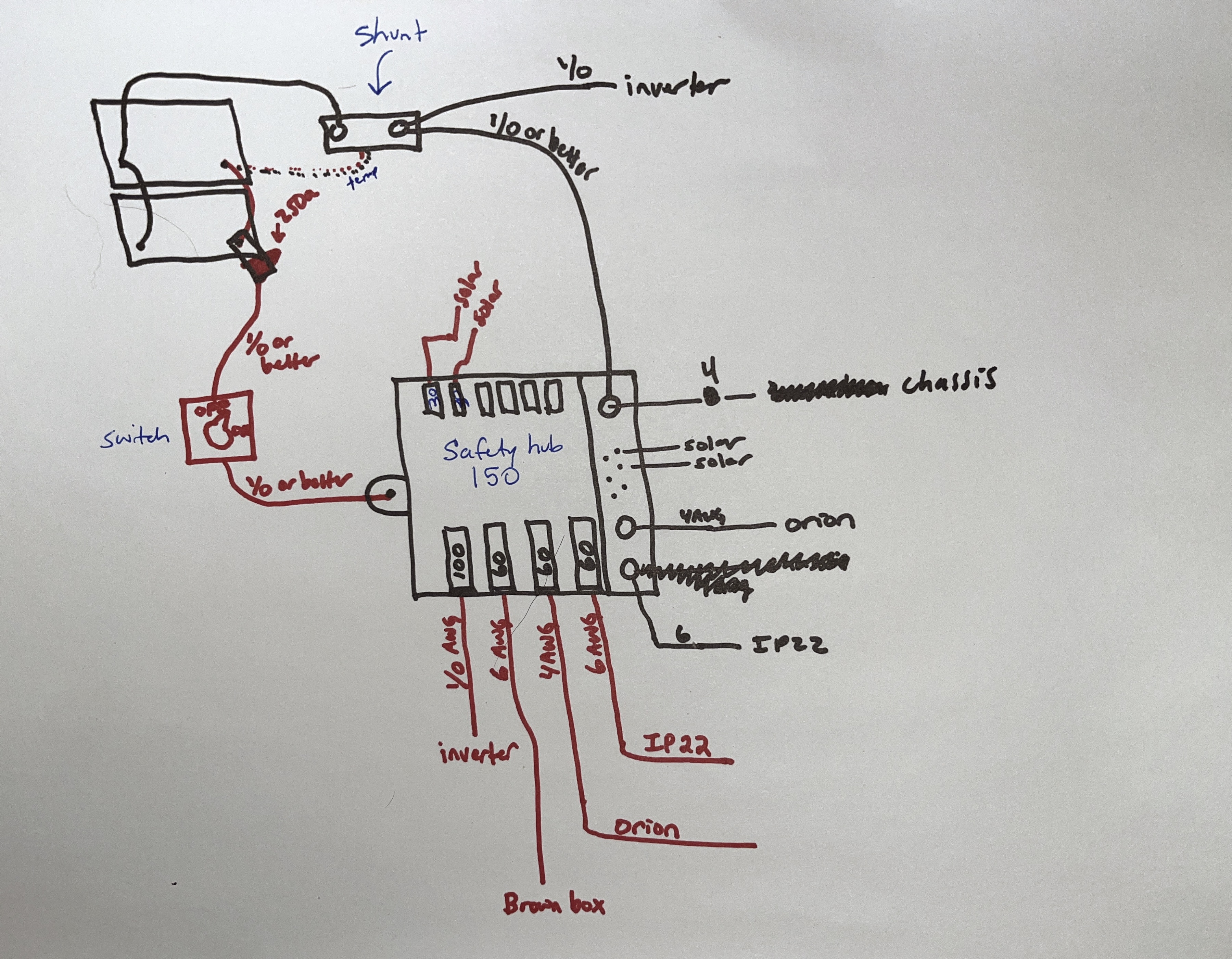

Re: Batteries and Charging
Pardon my drawing skills and lack of fancy software, but I drew out one example of how your new DC distribution could go. In case it helps you to visualize.
More text below.

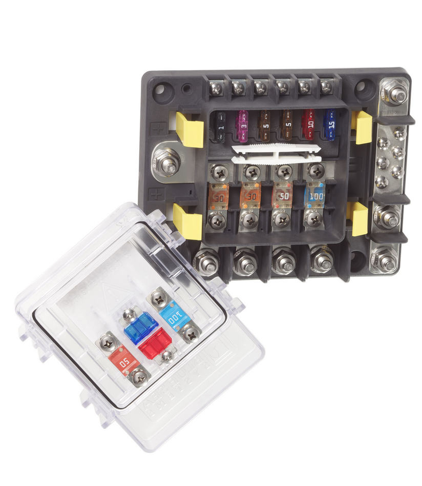

BTW, here is a real Safety Hub 150, vs. my crude drawing:
Cover off:
Cover on (the posts outside the cover are the negative bus):
To spell it out.
House bank is in upper left.
--Starting with the positive take-off, there is a Blue Sea 5191 MRBF holder and Blue Sea 5189 250amp MRBF fuse.
--Then 1/0 or larger positive cable to a Blue Sea 6004 Battery Switch
--Then 1/0 or larger positive cable to a Blue Sea Safety Hub 150 (7748)
-- From the four larger Midi fuse posts:
a) 100 amp Midi fuse (BS 5256) and 1/0AWG red wire to Inverter
b) 60 amp Midi fuse (BS 5253) and 6AWG red wire to Brown Box
c) 60 amp Midi fuse (BS 5253) and 4AWG red wire to Orion "out" terminal
d) 60 amp Midi fuse (BS 5253) and 6AWG red wire to IP22 Charger
--From the ATC blade fuse section of the Safety Hub:
e) 30 amp fuse to orig solar controller, if keeping (I think that's 12 AWG wire)
f) 30 amp fuse to new solar controller (looks like 10AWG?)
-- The temp sensor lug from the BMV 712 shunt goes to a positive battery post (has inline fuse included). This also powers the shunt.
-- Now starting from the Negative house battery take-off
-- 1/0 or better yellow or black wire to the Shunt "battery" post
-- 1/0 or better yellow or black wire from the Shunt "load" post to the Negative bus that is part of the Safety Hub 150
-- 1/0 yellow or black wire from the shunt "load" post to the inverter (or could be any other negative wire - just taking one wire off the Safety hub negative bus to keep any post from being too cluttered)
-- Now we are on the negative bus of the Safety Hub 150:
a) 4AWG yellow or black wire to chassis (frame - bolt lug using existing hole in frame)
b) 12AWG yellow or black to orig solar controller
c) 10 AWG (?) yellow or black to new solar
d) 4AWG yellow or black to Orion
e) 6AWG yellow or black to IP22 Charger
Side note: From Orion "in" terminal, a red 4AWG wire toward the start battery positive post to a Blue Sea 5191 MRBF holder and a Blue Sea 5178 60 amp MRBF fuse.
That's it I think. Now every wire is fused, and all organized. There is a main battery switch. And a shunt for keeping track of things, plus allowing a Smart Network for the Orion, the IP22, and maybe a future Victron solar controller.
Note: It's 5 a.m. here so this is just an example and it's possible I missed something.

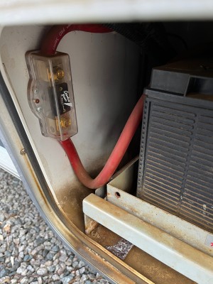

PS: I see you mention a 150a fuse for the inverter. A couple of notes:
1) 1/0 wire can handle 150a, so you are ok there.
2) OTOH, at least with my Xantrex 1500, they recommended a 150a fuse; so they may recommend a 100a fuse for the 1,000 watt. That said, you are typically protecting the wire, not the device, so you can also ignore that recommendation if you choose to. But there are 150a Midi fuses, so you could still use a spot on the Safety Hub with a 150a fuse if desired. I of course am curious what you are using now and maybe keeping.

Blue...again, amazinng info here. Thank you.
After doing a quick study of your hand-drawn diagram of the Hub 150, looking at the real deal, and reading your line descriptions, you do indeed having me thinking again as to whether or not I need the separate bus bar-to-Smart Shunt set up I mentioned for the Negative side, or whether or not I can get it all comfortably on the Hub 150. Looks like your scheme has me doubling on one of the negatives for chassis ground and the 1/0 out (assuming you don't think that's a problem?). Also wondered when I didn't see any mention of an existing ground I currently have running from my battery--which, I had assumed should be carried to the new set-up. This makes me think I am wrong about that and it is not needed. Is that correct?
Of course I'll be sure and keep you posted as to which way it goes.
Also, thanks for the all the leads and additional info on "link bars." I love it!
I leave on Sunday for a week...Memphis to help a friend build a new greenhouse. So, I will likely be slower than usual in posting or responding.
deppstein wrote: January 31st, 2025, 3:12 pm
Technically yes, you can have more than one lug on a larger terminal. Of course it can be nice to only have one -- and 3-4 results in an untidy "spider" shape. But two can usually be handled. On the negative side there is no worry about it being on a specific fuse or etc. like there is on the positive side so whatever makes sense is good. It's basically just a return path, that's kind of all in one bucket.
Really the entire negative system on a setup like this is all "common." So any wire could go to any post, and the one post that ends up with two could be any of them -- whatever works best physically.
Couple of things though:
---In principle, it's good to put larger loads closer to the "root" (so you wouldn't put the inverter negative way out at one end of a bus bar if you could help it).
--You do need to make sure that any circuit has a logical path through negative wires that is as large or larger (wire size) than the positive. I'll give you an example:
I used the chassis ground for the negative for my 1/0 positive wire that goes from my start battery to the house battery (today I might run a pair of wires - certainly if they were 4AWG I would because that's easier). But so anyway, let's look at that whole individual circuit, if that is ALL I had done.
1) Positive house to positive start - that's all 1/0 cable.
2) Negative running through frame (chassis) - that's ostensibly 1/0 worthy.
3) 8AWG negative jumper from battery to frame: Bzzzzzzt
4) Small (forget what size it was) negative jumper from Ford start battery to body sheet metal, thence to frame: Bzzzt
So I had to upgrade those two jumpers: A 1/0 wire leading from "load" side of shunt to frame (and at least that large from "battery" side of shunt to battery). And an upgraded jumper from Ford start negative to fender (pain!).
This is just one example but the point is you have to make sure every "circuit" has a path that is the size you think it is.
Of course for this precise example, I'd say (and I think you agreed) that just running full 4AWG positive and negative cables all the way from the Orion to both ends (start battery to house neg bus, with 4AWG jumper from Orion to Neg bus) will be easier.
Typically the battery jumpers and the first wires to the switch/bus bars/shunt will be larger. So say since your inverter cable is 1/0 you might make them 2/0 or larger. In this case I think you'd be okay with 1/0 as you can comfortably fuse it to 250a, and the main reason you have such large cable to the inverter is voltage drop.
-- And of course only one wire can be on the "battery" side of the shunt - which is the one going to the battery post.
deppstein wrote: January 31st, 2025, 3:12 pmAlso wondered when I didn't see any mention of an existing ground I currently have running from my battery--which, I had assumed should be carried to the new set-up. This makes me think I am wrong about that and it is not needed. Is that correct?
Have a look at the Safety Hub negative bus - the top post. See it shows a 4AWG wire to chassis ground? That's it. That is essentially going "from your negative battery post" (except for one thing, don't load up battery posts, and for two it needs to be on the "load" side of the shunt or it will be a "sneaker load" that gets past the shunt -- so DON'T put a wire back going right from the battery negative terminal to the frame/chassis. You might choose to make that larger, just for margin. But since your inverter does not pass through the chassis ground, and your Orion also will not use it, it's really only covering the brown box loads. That's why I typed it in as a 4AWG (you will have some of that spare, no doubt). Guessing anything new you add later on will have both positive and negative wires to the SH and will not use a chassis ground, so it will never become "more loaded" with larger loads.
(That's what I do. I don't add any new items using the chassis ground; instead I run both positive and negative wires to my main DC distribution - so the loads on the chassis ground don't ever get any larger but just stay as the original Chinook ones - make sense? Well actually I have reduced them slightly, as, eg I have changed the refrigerator wiring to a larger positive/negative wire pair - so that no longer uses the chassis ground.)

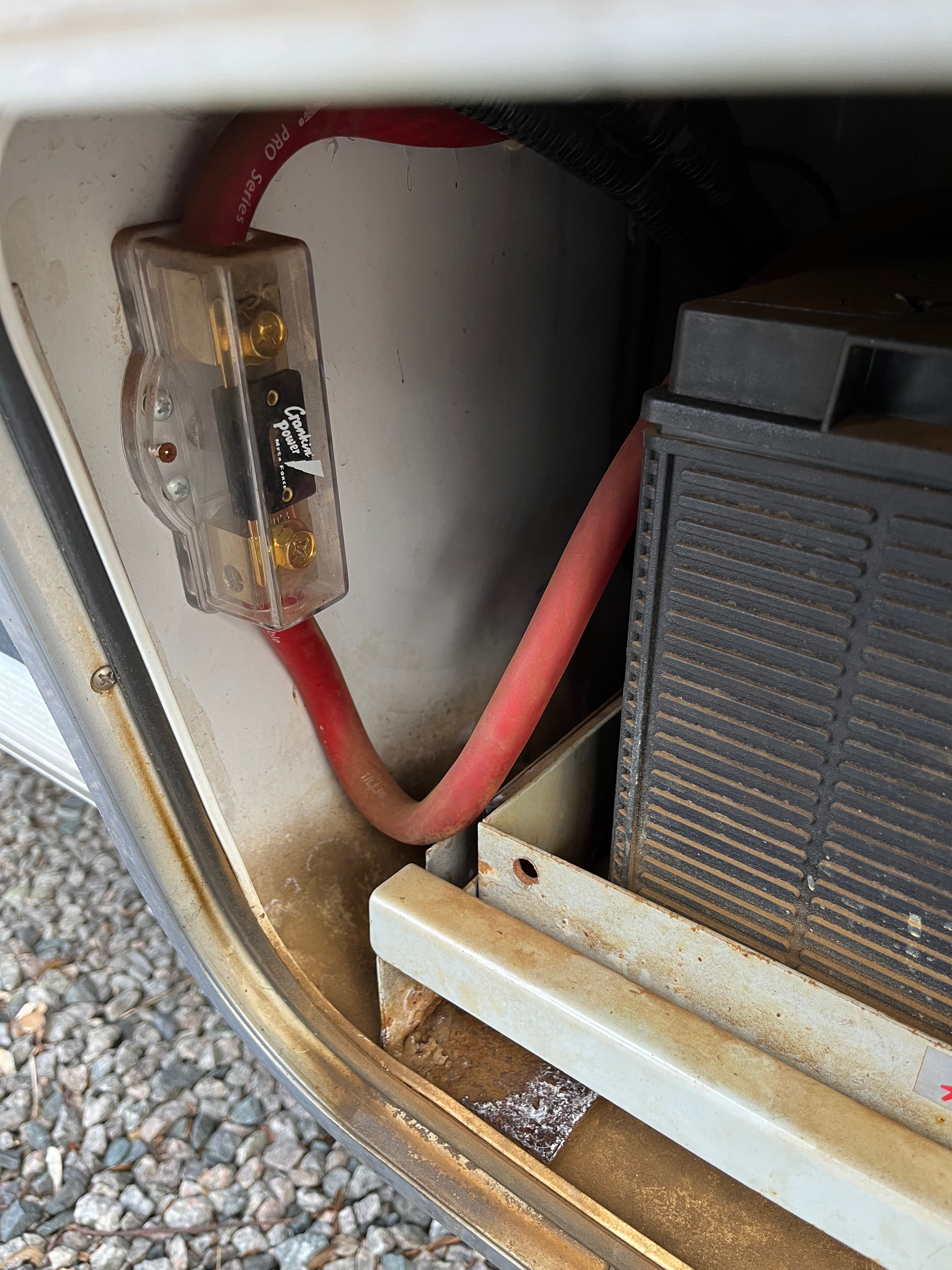

And, I was able to dig up a picture of the Inverter Breaker!...had sent one to Eddie to show him that I had enough room on that wall to mount the Orion XS. As you can see, its a big honkin, legit looking thing! And close to the battery for sure, so I'm thinking I can easily keep it and mount that POS Inverter 1/0 right on the inboard end of the Hub, right?
