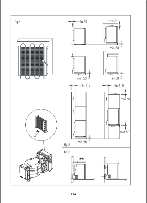

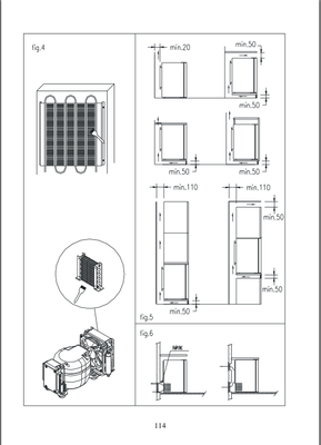

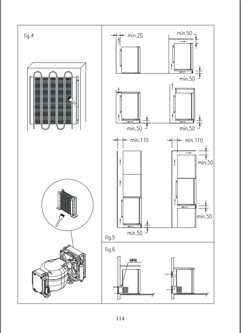

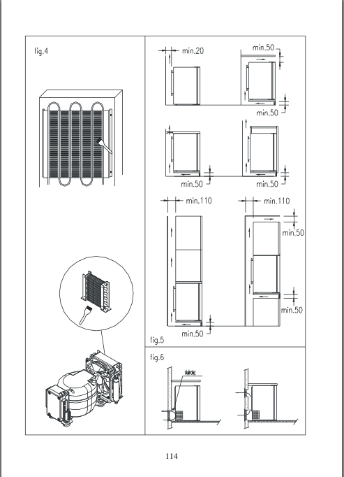

So you absolutely do need ventilation for a compressor refrigerator, BUT you don't need the exact same thing. After all, you are no longer burning a fire back there, and the byproducts of combustion aren't being vented. Instead you are just supply cool air for intake and then exhausting heat. For the BD35, according to Danfoss, I believe they are looking for 25 square inches on both the in and out side (if you are using screening or a louvered vent there is a subtraction factor; in other words, a 5" x 5" hole with screening over it is not 25 square inches of ventilation). I think the DP2600 has the larger BD50 compressor, and that will have a spec for ventilation area in/out (the compressor is made by Danfoss).
The Vitrifrigo manual does give some guidance and specs. Most of these are for interior venting, since more of these go in boats (and you can't have a vent along the side of a boat in the same way that you can on an RV). They do essentially say that exterior venting is great if you can get it. In case you don't have this document, here is the page, copied. The dimensions are metric (since they are made in Italy).
Reviewing the DP2600, I see that the compressor is at the very bottom. So in some ways the original Chinook venting scheme is perfect. Air in at the bottom, chimney effect, air out at the top. It looks like they want about 4" of depth to the vent plenum, and I think the original one is deeper, so you might be able to make a "false wall" at the back and fit both some insulation (against the fridge back) plus the plenum. I don't have a measurement to hand, but the original one must have been deeper than that (for all the "pachinko machine" guts of the cooling unit). I think we put around 5-6" of insulation in my buddy's rig where the original propane fridge was (he elected to eliminate the vent chimney).
On the other hand, that lower vent on our Chinooks can sometimes have issues. There is no way to positively keep all water out, and at least on my generation of Chinook, there wasn't a good outcome when water would get in. Basically the bottom of the compartment was lower than the lowest drain-to-the-outside area. Boo. When I still had the propane fridge, I used flashing to make a sort of self-draining vent door, but knew that I would want to eliminate that vent when I went compressor. On the other hand, I've never had any water come in the roof vent. So I felt that keeping that was an option.
You'll want to decide about that for your own rig, of course.
For my smaller unit (Vitrifrigo C130, BD 35 remote compressor), I need to provide at least 25 square inches of intake and exhaust. That's after taking off any deductions for screening, slats or whatever. I haven't decided for sure whether to go for all inside venting, or all outside venting. The "easiest" thing would be inside intake and roof exhaust, but I'm not super keen on mixing the two. I am not enough of an expert to know for sure whether or not it would be a problem, but I can imagine possible bad scenarios and just don't feel totally comfortable with a "mixed" venting scenario. I'm more comfortable with all out or all in. Considering that I have had a BD 35 running inside all the time now for two years (small "cooler shaped" refrigerator with BD 35 compressor which is a pre-cursor to the "real" refrigerator), I'm less worried about the potential heat gain with all-inside venting than I was at first (thinking it might heat up the rig in summer). But on the other hand if I go with all exterior venting then I should be able to hear the compressor/fan less (it's pretty quiet, but I like sensory deprivation levels of silence :D). With all exterior venting, I should be able to isolate the sound more (vs. having 50 square inches of "sound ventilation" into the interior).
