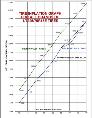

Hey Scott - I know you've noted this someplace on here before but what pressure do you run your tires at normally? I aired my rears down to 50 psi and the front tires at 55 psi and the ride is really improved, especially in the rear, but I want to make sure I'm not running them too soft.
Re: Deflating Tires for Unimproved Roads

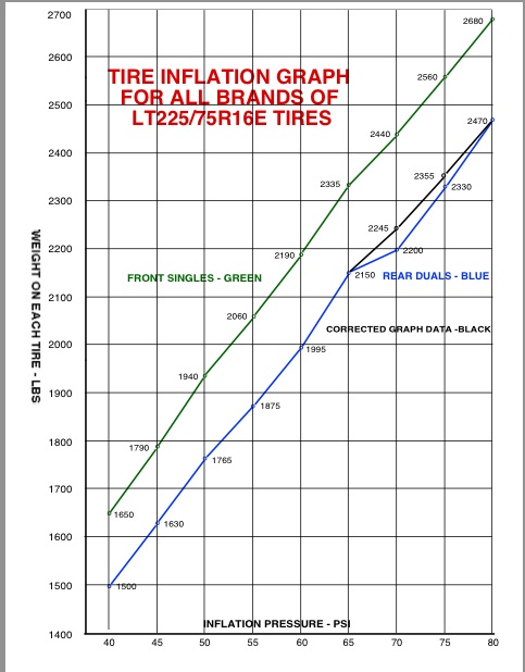

I'm not Scott, but what are your weights for front and rear axle when loaded for travel? And what size tires are you running?
If you were running the stock tire size of LT225/75R16 E, then your pressures would be as follows:
55psi front would correspond to a front axle weight of 4,120#
50psi rear would correspond to a rear axle weight of 7,060#
Here is the chart (click to enlarge), which will allow to to select pressures based on weight. If you are running a different tire size then there should be a chart for that somewhere. You of course don't have to run these exact pressures, but they are what is recommended.

Hey Blue - I don't know what my front and rear axle weights are - never had it on a truck scale. I am running the stock tire size. I've had to run around town with my rig since I went to 55 in the front and 50 in the rears and I haven't noticed much difference in terms of handling/sway. I know I won't get as many miles out of the tires by running them at lower psi but I figure the tires will need to be replaced long before the tread is gone.

I'm not sure I see that though. Because why is 65/60 "usual"? I mean, unless you weigh really (really) high or have completely different tires. But what I'm saying is that I would assume that inflating according to the chart for one's tire size and one's scale weight, you'd get the best situation for tire wear/heat/traction under typical driving scenarios.
So lower psi than recommended for weight would have the tires run hotter and tend to wear down the edges (I'd think); and higher than recommended would have them run bouncier and wear down the middle (plus perhaps less traction if you want a certain amount of tire on the road).
If 65/60 is the recommended pressure for your weight and tire size, then I'd agree. But for the stock tire size you'd have to weigh 4,500# front axle and about 8,000# rear axle. That'd be considerably over the weigh rating for both axles and the GVWR as well (and I'm presuming you're not at those weights?). If you have different size tires, then there is probably a different chart. But I'd still think that running in the vicinity of the chart's recommendation for your tire size and actual weight would be best for the tires is what I'm saying.
