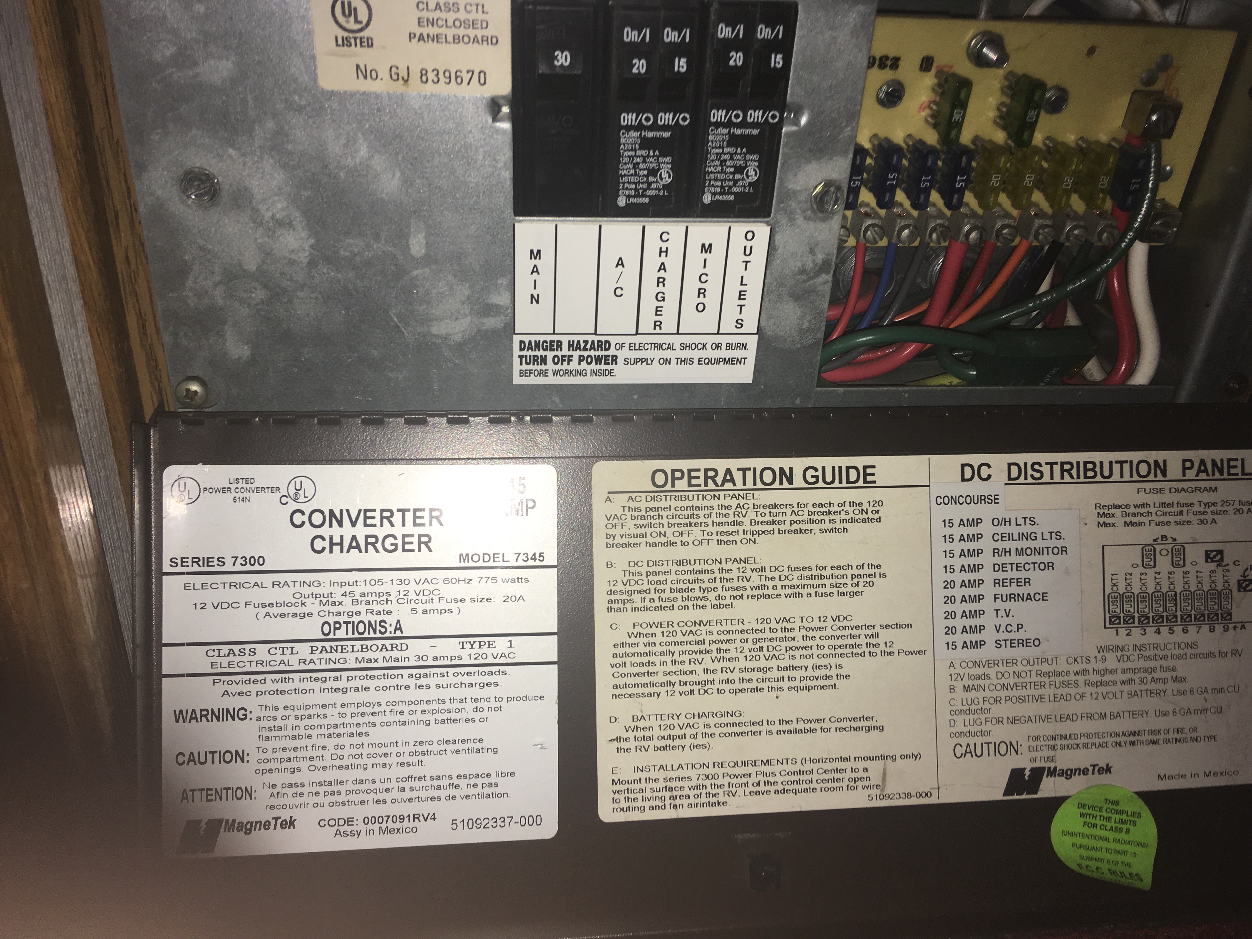

Excellent info on blog, exactly what I was looking for. as I have your issues you fixed. Below is pic of the 7345, it seems still in-place.
What solar charger did you replace? I have the Mark 15 from Speciality Concepts and wasn't sure if this needed to be upgraded as well.
Isn't the Freedom inverter different than the Controller/charger? If so, I must have inverter tucked away somewhere, I cannot find it.

The Freedom unit looks like an inverter/charger, so it could have been a replacement for the Magnatek. It sounds like the previous owner did not install or removed and did not pass on that item.

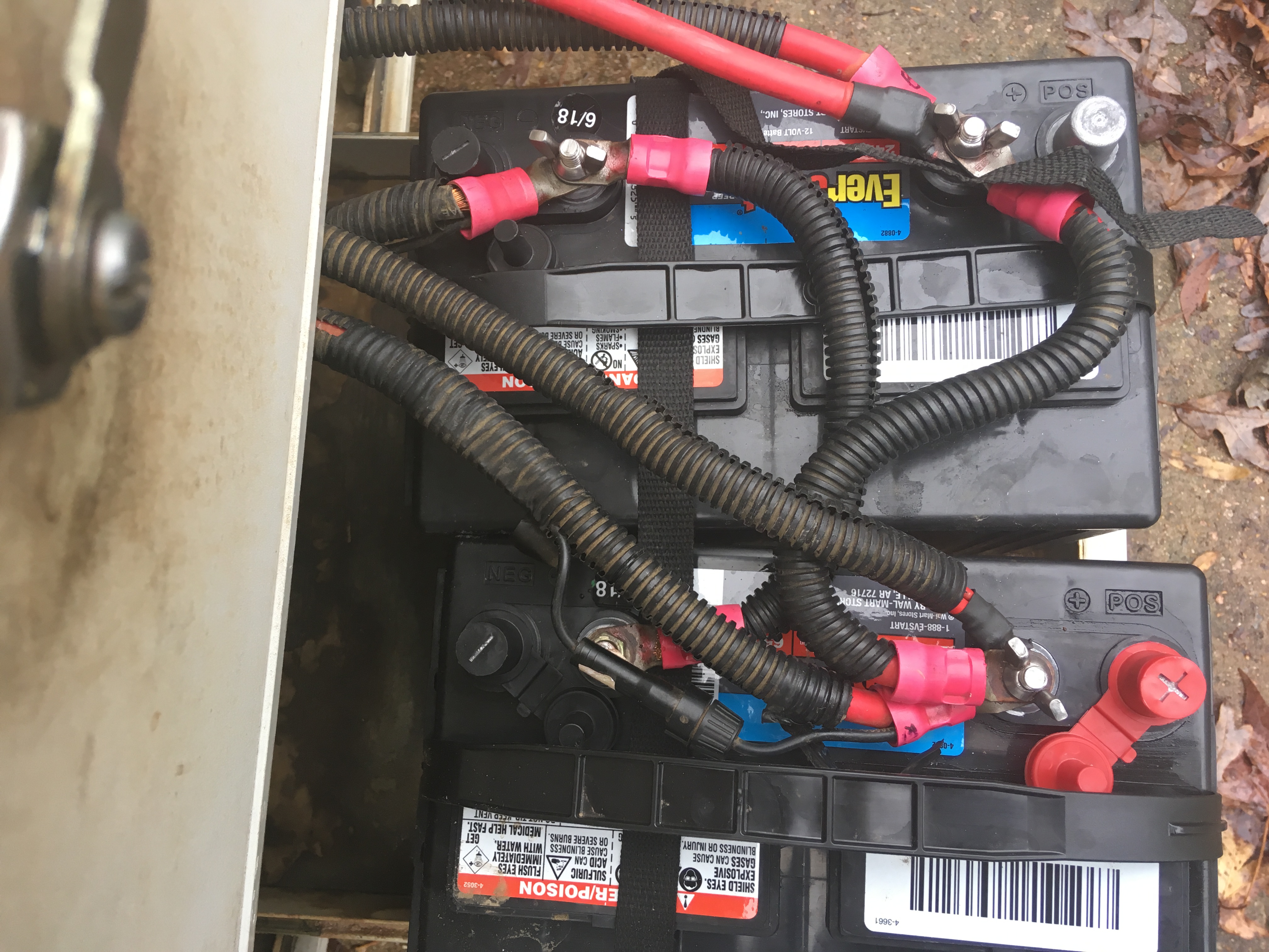

Here is pic of battery cables, not sure if this goves clue to how things are set up...
