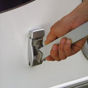

What should happen when you close it is it clicks up into place, and two little red tabs suck in (right at each end where the part of the tube you are closing meets the part that stays up by the roof). I have found that some awnings need a little push (on the bottom of the movable tube) as you are cranking right at the end in order to "hop up" onto the part that makes the thing close and the red tab move. There is an adjustment you can make --- it's not supposed to require that push or the "hop up." I wonder if yours needs the push as it sits now in order to close correctly.
I'll go dig up some photos of my foot brackets. BTW, of the original white plastic ones on mine, one was broken. They don't make that style anymore so I replaced them both with the newer style (fit same holes).
A last tip: When I first used my awning, the little metal feet at the bottom of the legs were bent. Well hmmph, I thought, and carefully straightened them (it did seem odd, as I could tell the awning had basically never been used). It only took about five minutes for me to figure out that Chinook had bent them slightly on purpose: After straightening the bottom part could touch the fiberglass body curve when in the bracket. I re-bent them :oops:

Anyway, these are pics of another Chinook (better pics than I have of mine) but the awning is mounted just like mine. Then a stock photo of the new brackets (from the web). No need for those if yours are not broken though.
new bracket from web.jpg (9.03 KiB) Viewed 7502 times
