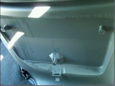

Luckily, the underlying doghouse on the 1997-2008 (and I believe 2009-present but not 100% positive), has standard console attachment points, so any of the various consoles that have been supplied can be substituted (if someone loves the Beverage Mate, they can even put one in on purpose :D). This is not my rig (so those spills and dirt ... not mine!), but his photo shows a generic 1997+ Ford van doghouse. This is what is under the console. Note the three "knobs" in an upside-down triangle shape -- the console hangs on those. The clippy thing you see just below the lower knob locks them in place (so they can't lift up).
Before removing the Beverage Mate, I read the installation instructions just to get an idea of the procedure. I noted that one of the instructions was something like, "Drill out rivet, remove console hold down clip from doghouse, and throw it away. Then use plain old screws to affix Beverage Mate to doghouse." Oh great! I popped into a Ford dealer to try to buy one of the hold down clips, but it turns out they are not something you can buy separately. I figured I could get one from a junkyard or etc. at some point (I was in a small town so nothing there), and proceeded anyway. Removing the Beverage Mate was a matter of taking out the fuse for the power wires (it was in the extra added Chinook fuse block that is ahead of the driver's left shin. In my case it was the third one down on the right-hand row, but yours may be different. Easy enough to remove those fuses one at a time and see if the Beverage Mate turns on or not.
I can't remember if mine actually had the screws they said to put in or not. If it did, they were so simple to remove that I can't even remember it. Buh-bye Beverage Mate.

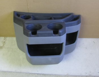

I decided I wanted the "big" console I had seen on 2003 (maybe up to 2006 or so?) E-Series vehicles. This one comes all the way down to the floor (covers up part of the floor just behind the doghouse), and has plenty of cup holders and cubbies, plus a lower open cubby, and a good-sized "glove box" drawer below that. I wondered if it would get in my way when I wanted to shift from the cab to the coach, but it hasn't bothered me at all and I am very happy with the function of the console itself. Here it is in place. Note that it does not really look like a scary, over-enthusiastic clown face in actual use :D
