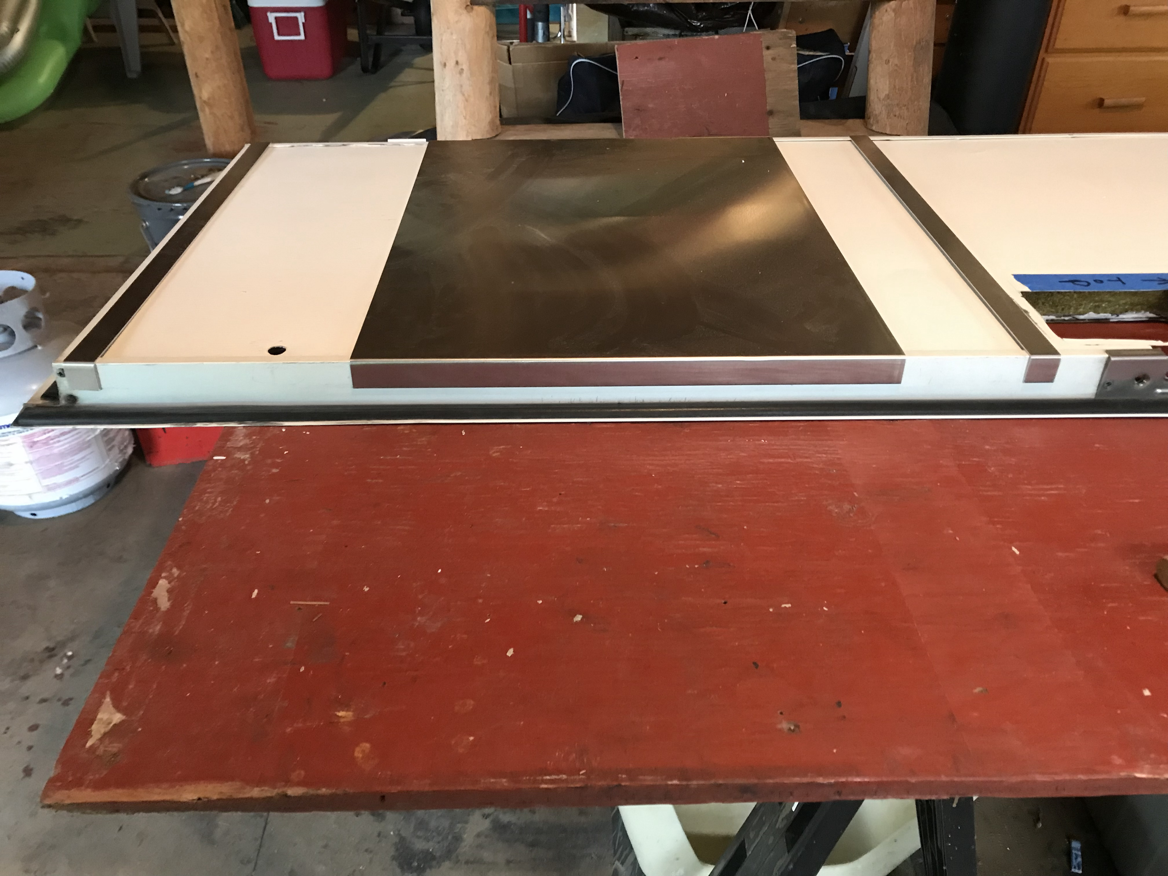

Just finished a similar repair on the entry door to our 1998 Concourse. The lower hinge-side had begun to pull apart and water had infiltrated the core. Essentially, de-constructed the door so everything could dry. Had braces manufactured at a sheet metal shop and attached these to add additional support. Re-caulked/re-sealed everything. Bigger project than anticipated and time-consuming. But we should be good to go now.

The braces look pretty good, but I wondering why you did not do the entire low section with one larger panel, but with a thin brace with a smaller panel.
