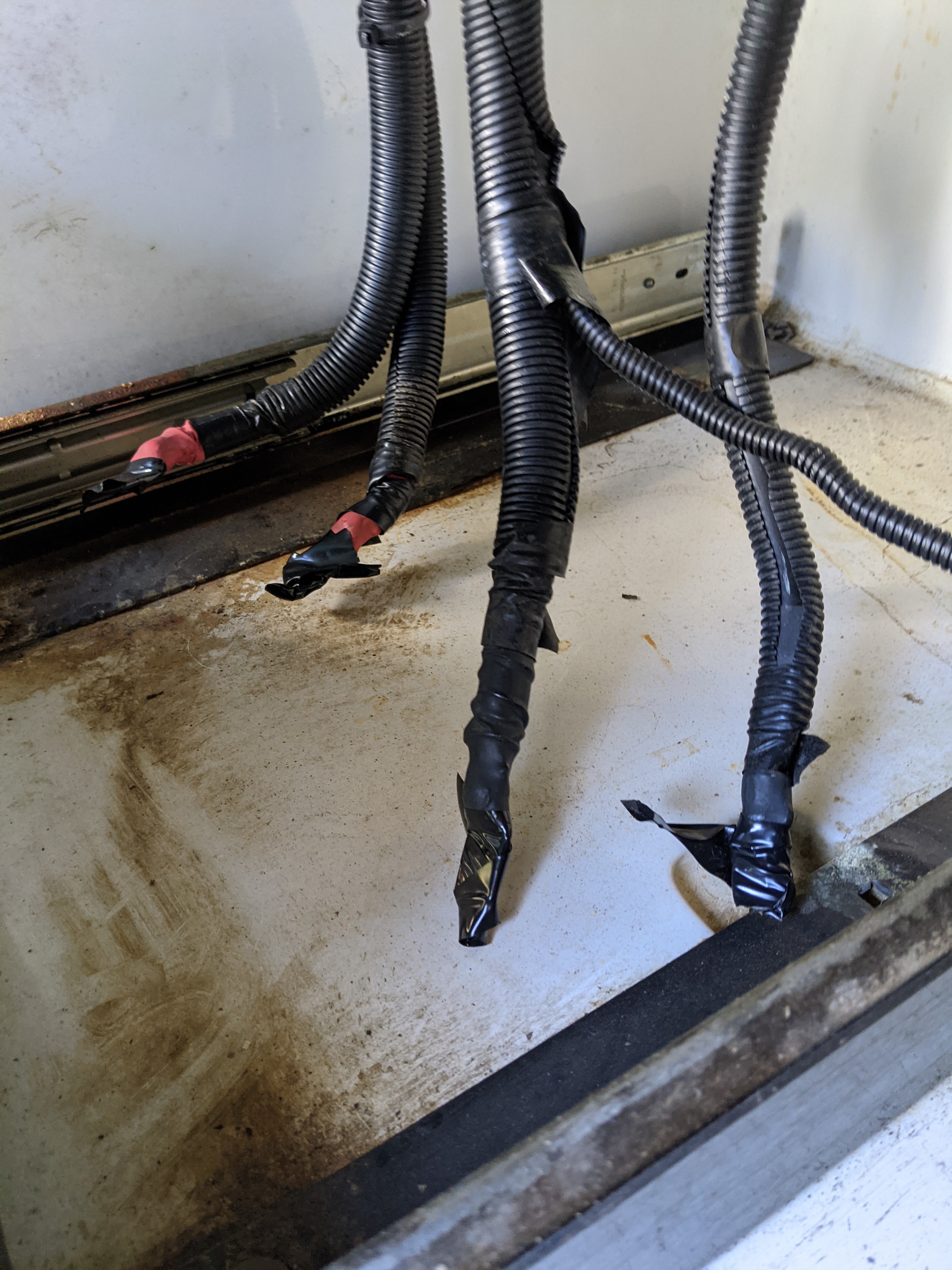

Wires hanging down into battery drawer.

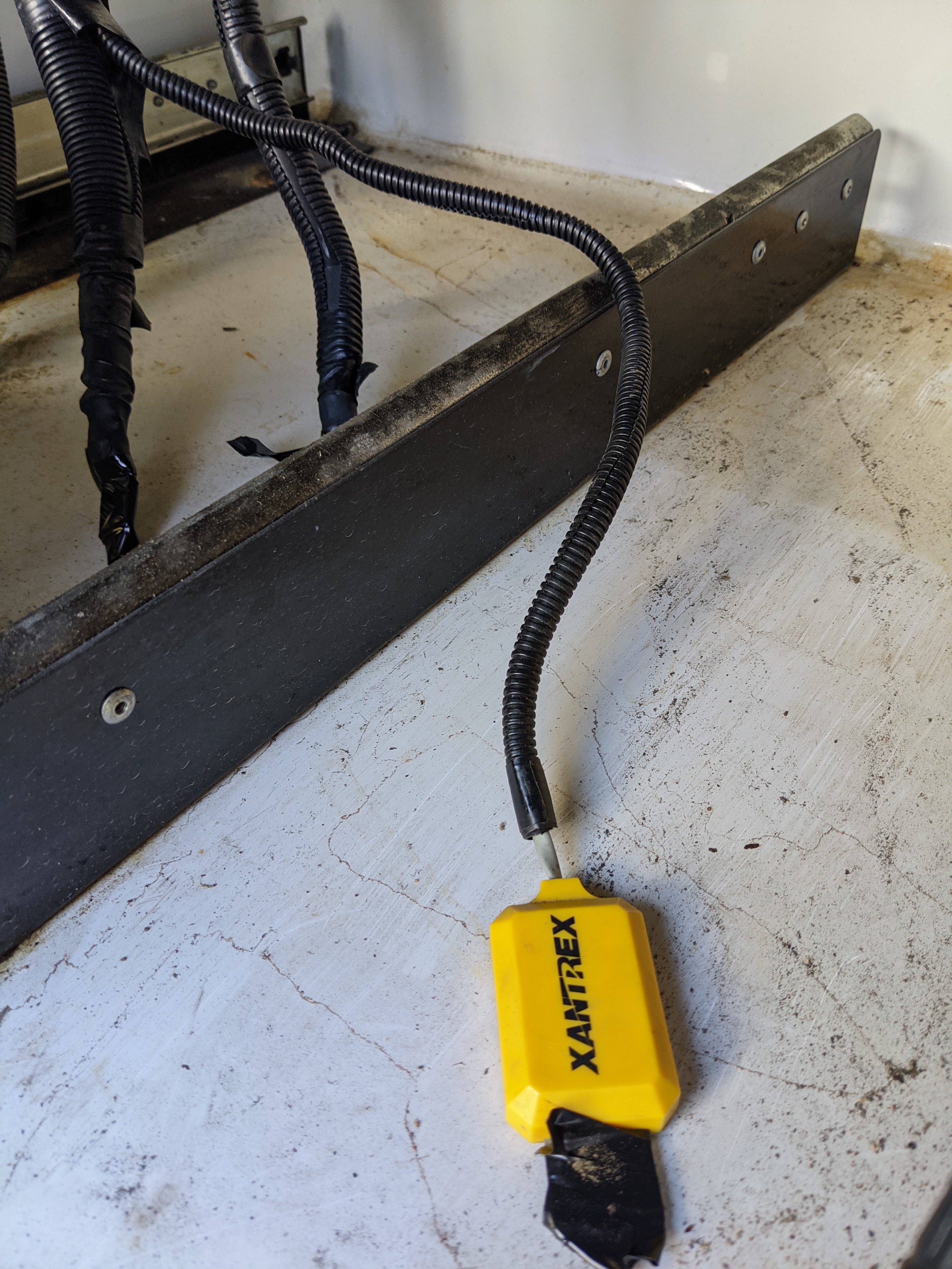

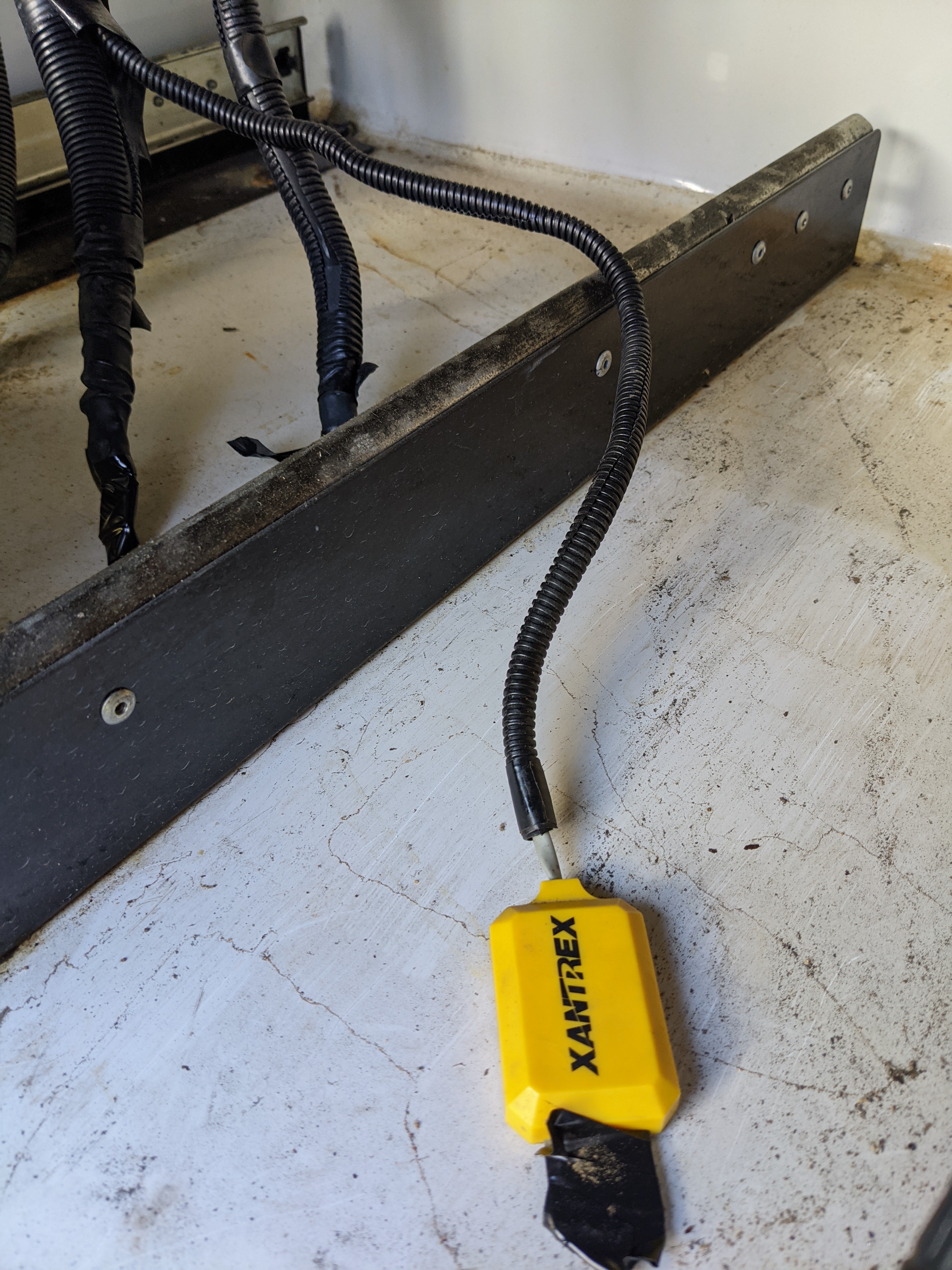

The yellow box on thinner wire

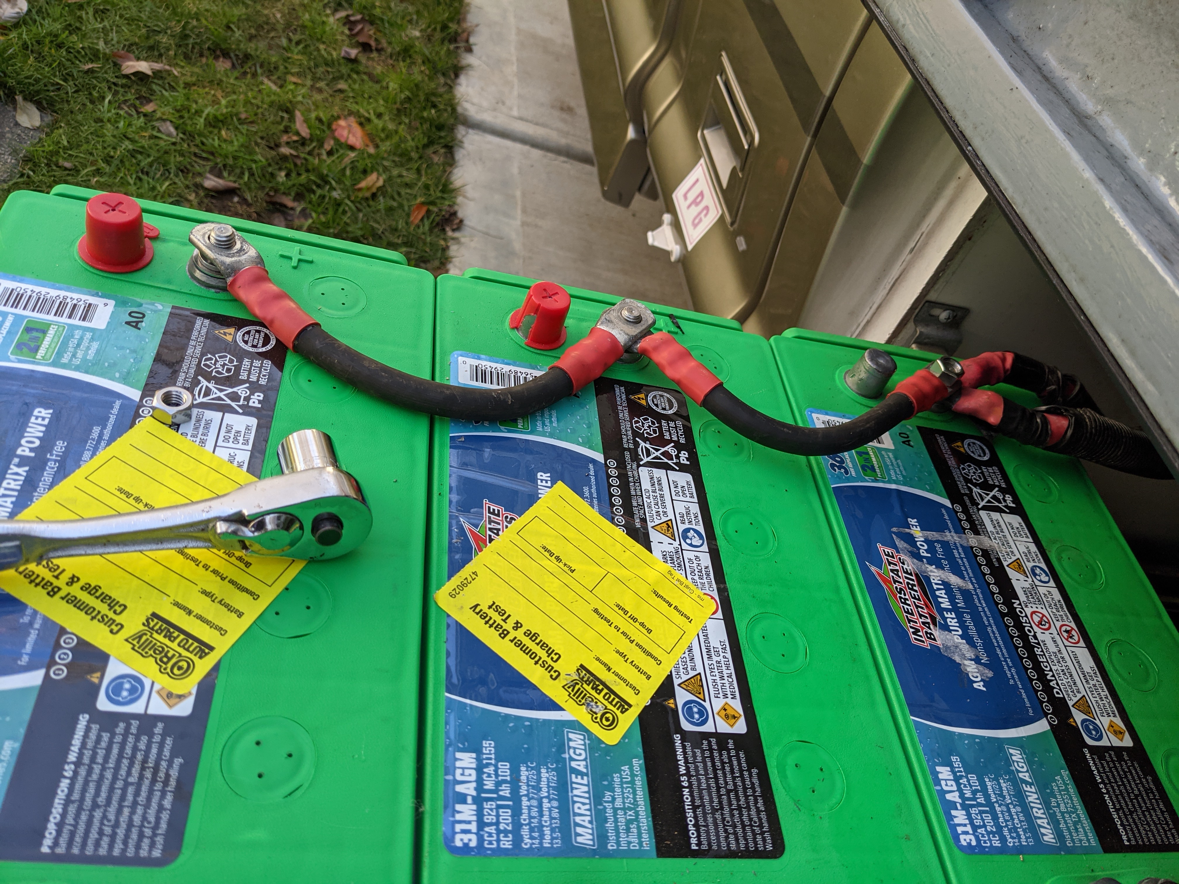

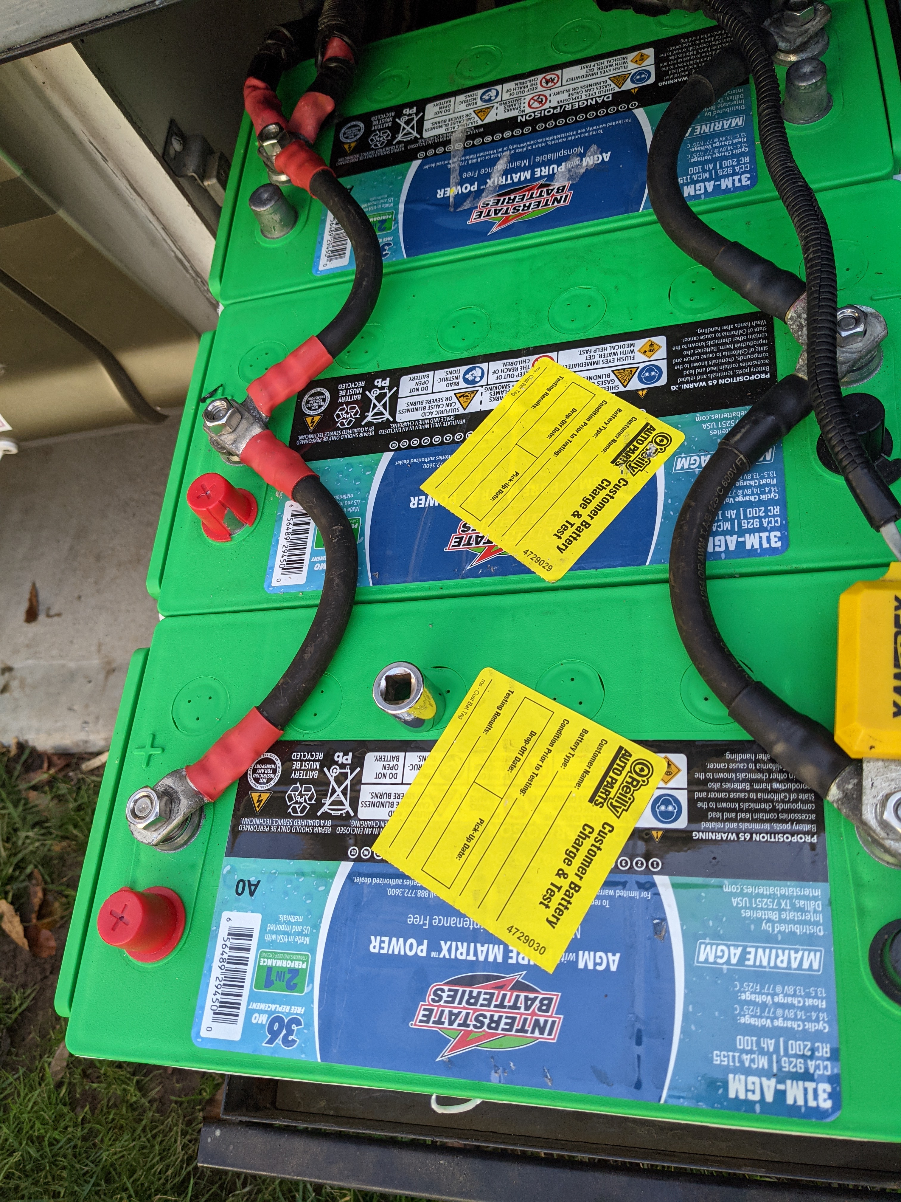

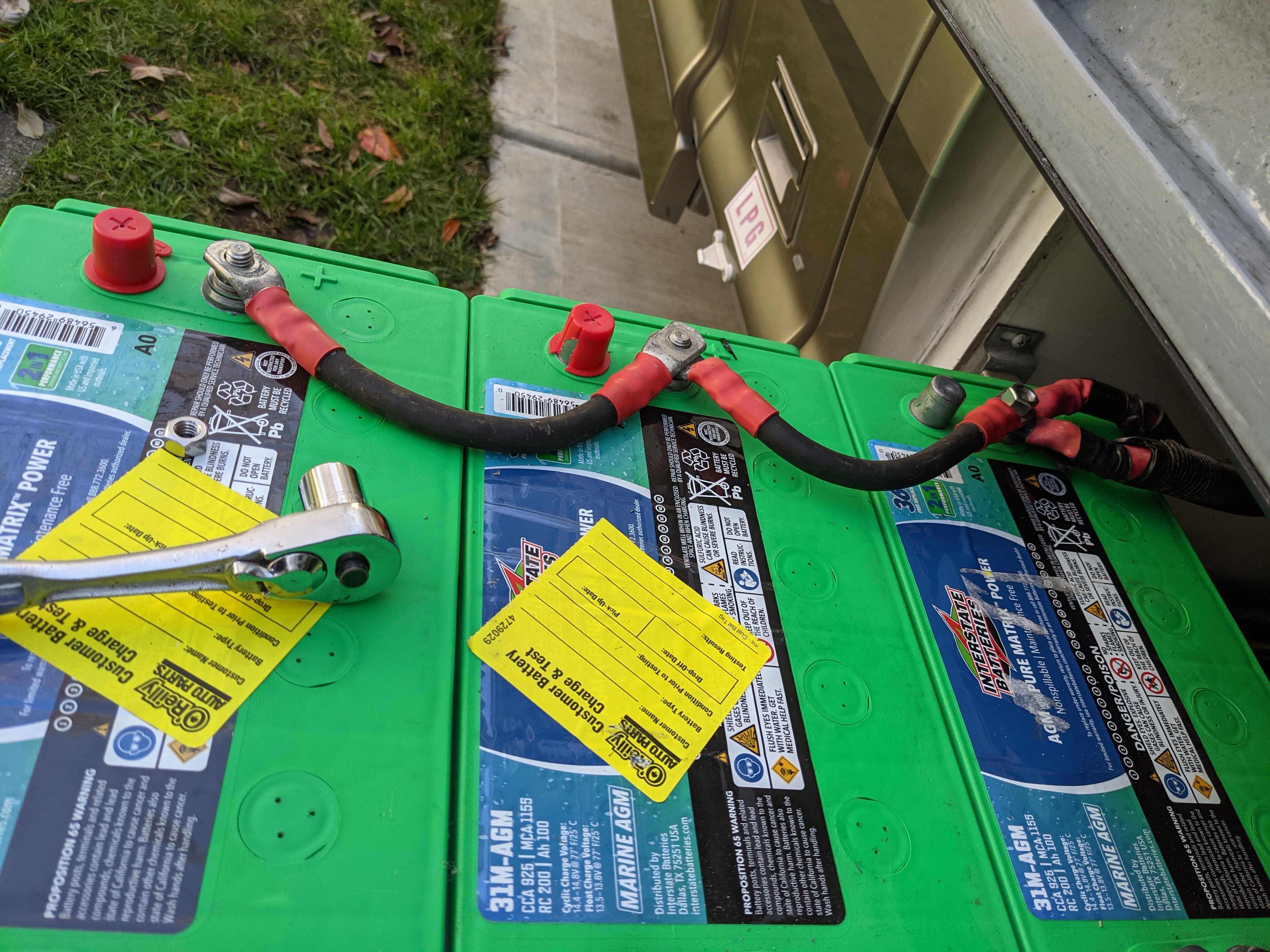

I connected to the batteries in parallel as shown. Which side do I connect the "yellow box" to?
Pic 1- i hooked up positive connections
Pic 2 - positive + negative connections

My picture labels (pic 1 and 2) are switched but I hope you get the idea. The inside battery control panel reads batteries fully charged (the repair guy charged them) and reads 13.1 v.
The yellow box concerns me. I attached it to the "farthest negative terminal in the series" per guidance I found on YouTube (before I read about this forum and quit trying YouTube).
From your comments, this may have been a mistake, What is it for? Which terminal should it be connected to?
dokramer@live.com
Posts: 6
Joined: December 22nd, 2020, 1:08 pm
Re: Guidance to install coach batteries
Post by dokramer@live.com »
Ok, per Xantac inverter manual
"You can mount the Battery Temperature Sensor in one of two ways:
• Mounting the sensor to the negative battery post allows the internal battery
temperature to be sensed and provides the most accurate results
I think I'm okay, i connected to a negative battery terminal. THANKYOU for your help and guidance!
BobW9
Posts: 270
Post by BobW9 »
Sounds good. Glad to see that picture, I was not thinking of a temp sensor because I'd never seen one big and yellow like that! I did look online and agree with you that putting it on the negative seems to be what Xantrex does for their sensors.
