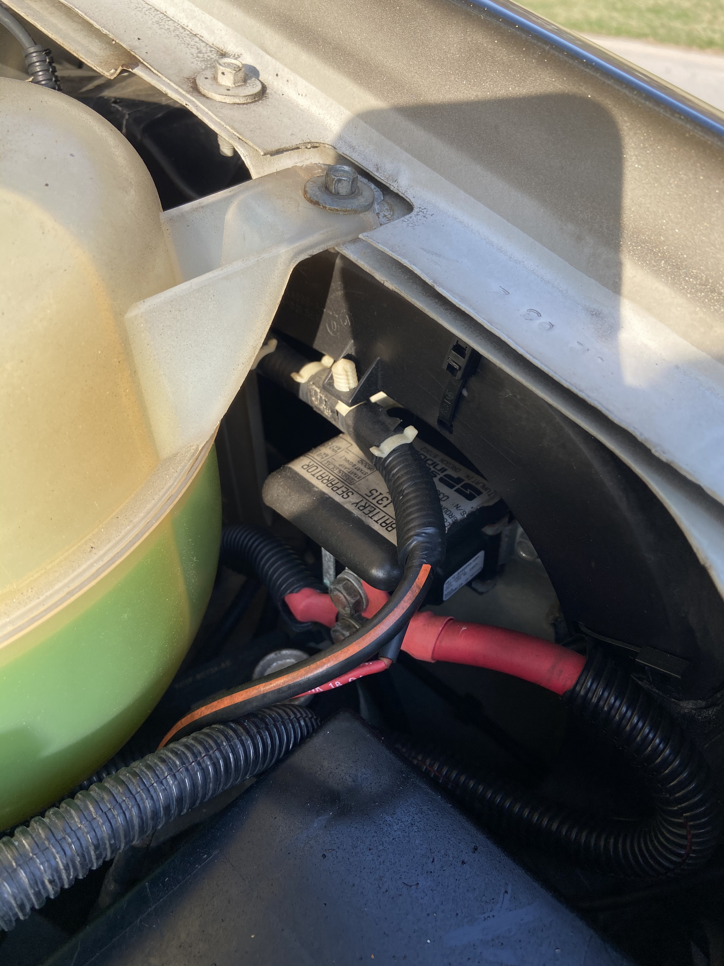

I am a new to me 2004 glacier 2500 owner. I am very happy but seem to have a few issues that I will be looking for help/advice on.
First issue is that my alternator does not seem to be charging my house batteries. Generator and shore power charge the house batteries but whenever I am underway there doesn't seem to be any charging of the house batteries. I have 3 AGM batteries at 80 AH each. When I hit the battery boost switch there does seem to be an audible click from a relay. I believe that is coming from the battery isolator under the hood on the driver side. With the battery boost switch applied and the vehicle battery at higher voltage than the house batteries, there is no noticeable increase in the voltage reading from the house batteries.
How long would a full charge take with the alternator if everything was in working order?

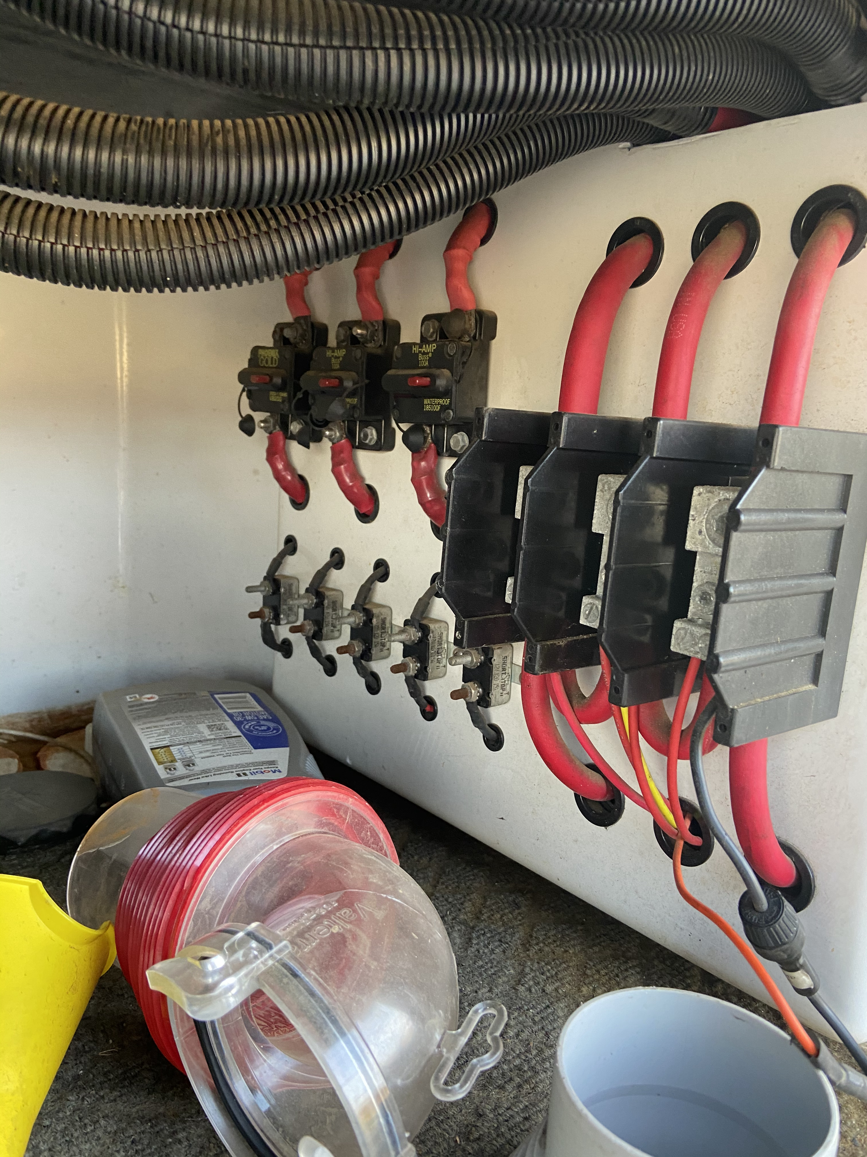

I feel like I have a decent understanding of most electrical systems in vehicles but opening up the battery compartment of the glacier really makes me scratch my head a bit. If anyone could point me the right direction that would be great!

In my experience the relay (surepower brand.. I forget thenmodel number.. we have a write up here somewhere) under the hood burns out often. Had to replace mine twice in 2-3 years). There may be a better solution, but just replacing it with a new one is quick and easy.

Is the relay located in the fuse compartment under the hood? I will search and see if I van find the post you are talking about.

I assume it is the same separator as in the Concourse. Here is the link to the manual. It gets warm when the solenoid is energized, and there is a noticeable click noise when the plunger moves.
viewtopic.php?p=3263#p3263
Do a search on Surepower on the forum should bring up dozens of threads. you can try to measure the voltage on the device and see if it is getting the control voltage when you press on the boost switch. If it does get the voltage, remove it and measure the solenoid coil resistance to make sure it does not have a short or got burnt out. Very likely it is the issue, since it is already like 18 yrs old.

I did replace the battery isolator and everything seems to be working great! I have heard a lot of complaints with the own replacement so I decided to use a marine grade replacement that was $40 cheaper. I will see how well it holds up.

Anyone have a part number, or link, for the original isolator? I need to order one ASAP.

For the Concourse, it is Surepower 1315. It is brought by Eaton. Check to make sure it is not recalled, and if it is, you maybe able to get a free replacement.
