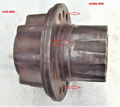

So heres a ford rear spindle bearing hub, its the part that your wheel bolts to. The deeper the offset is on your wheels, the further out you will have to move the new lug stud surface in order to prevent your tires from hitting on the leaf springs. This could result in premature bearing fatigue and failure because you have shifted the load of the vehicle onto the outer bearing inside the hub. The Dodge wheels keep this effect minimal. Keep in mind when you move the lug surface outwards on the hub, you must also move the hubcentric shoulder an equal amount. As far as spacers or adapters, i dont use them on my vehicles because i simply do not trust them, and certainly not something i am willing to take a chance using on a tall heavy truck like a chinook at 75 mph on the freeway. NOT GONNA HAPPEN. I do have a set of adapters here to bolt 8x200 dodge wheels on the back of the chinook, but they arent mine. I was helping Tim at Timberline come up with an adapter to do the swap but then i got really really sick last september and havent even fully recovered yet today, so they are just sitting here in the box at this point. One is an adapter to bolt dodge wheels on and the other is to bolt ford wheels on. That said, anytime i reference a dually spacer or adapter on "my" truck, i am refering to the OEM Ford dually spacer that comes on all of the ford dually trucks not an after market part. There are guys on the van forums that run wheel spacers/adapters on the backs of their rigs and claim no problems, but their trucks also do not weigh 10,500 pounds with nothing in them.
