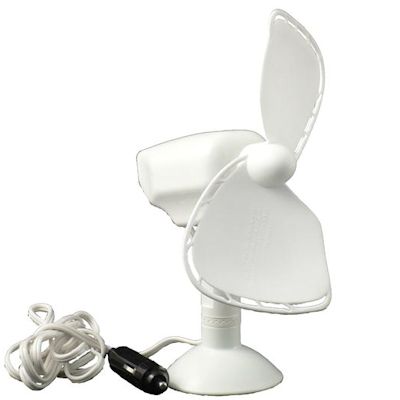

Caframo 747, low/high
144 cfm
210 cfm
.59 amp (not sure if that is high or low speed, probably high)
Picture shows suction cup mount but they can also be fastened with screws.

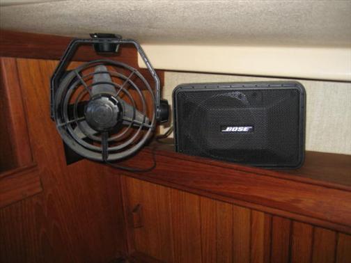

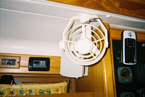

BTW, here are a couple of photos of the Turbo fans mounted on boats - just to give a sense of scale:
