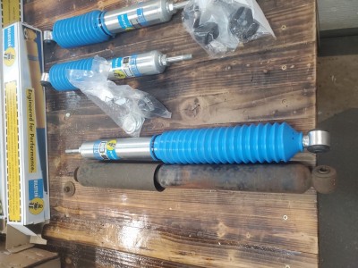

I have worked on Econoline vans before but somehow forgot how cramped they are (thinking back I may have blacked it out of my memory). Due to poor access to the top of the shock tower and rusted bolts (and lack of patience) I ended up carefully cutting the front shocks off with a torch.
Old shock compared to new shock.
One of the old front shocks was completely shot and had no pressure behind it. The other front shock still had some resistance.
Shock
Shock

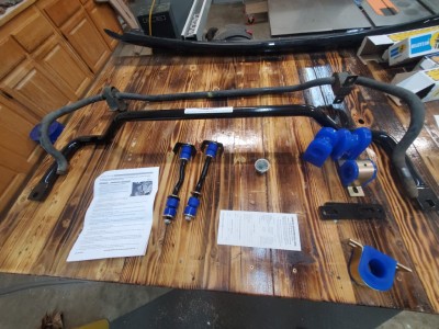

Here you can see the old front sway bar next to the new one. Note it is significantly beefier
Front Sway bar Comparison

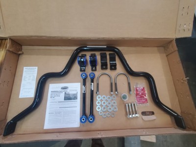

Here is the rear sway bar.
Rear Sway bar
Rear Sway bar
After installing everything, I took the camper out on some local roads and it felt much better. Still a little bit of floating feeling in the steering but I think I just need to tighten up the power steering box. The tires on the camper are wider than the stock tires and rub on the front sway bar at full turn. Not sure if I am going to leave it or put on a spacer.
