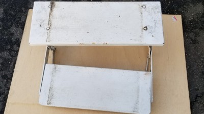

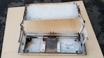

I just wanted to share a new/old project I was working on a couple of years ago. That needs to be revisited again to put in some additional work. I returned from a trip that involved taking a ship, and the high tide on disembarking caused the ramp to snag and damage my RV's rear step. I didn't realize how bad it was at the time and just used a bungee cord to get home.

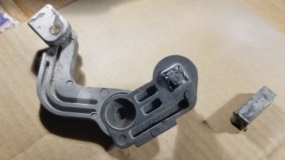

Once home, I took photos and discovered the gear box (#151320 from Kwikee) was broken. Online advice suggested buying new steps, which were expensive and not an exact match. So, I took apart the gear box and found the linkage was snapped and the lower step bent.
After extensive research, I found a replacement linkage on etrailer.com (Item #LC379649), but it's no longer available now. I clean up the original parts and pack the gear box with marine grease. I also had an auto shop straighten and weld the bottom step. This was only the beginning!
More posts and photos on this project will follow as I now have more time to share and complete projects that I put on hold due to work constraints.
Broken Linkage for Kwikee Electric RV Steps

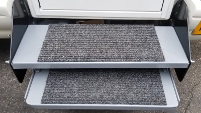

This project took some time to complete, as I had to purchase new nuts and bolts due to rust on the old ones. To prevent issues with the rug getting caught in the mechanism again, I attached large flat magnetic sheets to the bottom of the rugs.
After two years of trouble-free operation, the steps stopped working last week. In my next post, I'll show you what I had to do to fix them again.

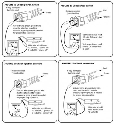

As I mentioned before, my RV steps stopped working last week. Having some experience with them now, I didn't want to start from scratch, but it was almost necessary. I removed the steps again to see what had changed since the last repair.
Living near the ocean on Long Island, salt spray and winter road salt can cause corrosion, and I found some under the steps despite them being primed and painted with Rust-Oleum. It wasn't as bad as the first time, but still needed attention.
I first checked the motor with a small 12-volt battery. It didn't move in either direction, so I opened it up, checked the gears, added marine grease, and tried again. This time it worked in both directions, so thankfully, the motor was fine.

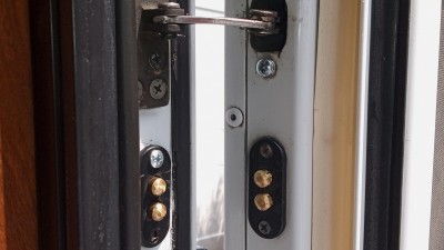

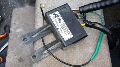

Next, I followed the troubleshooting checklist, disconnecting the main harness from the control unit. The power switch reading was below 12 volts DC, and I got different readings when checking for ground under the steps. This indicated a possible ground issue, especially since the door switch wasn't reading 12 volts with the door closed.
Figures 7 and 8 in the checklist seemed most relevant, so I added new ring connectors and 12-gauge ground wire to the control unit. I also cleaned rust from the chassis ground and some oxidization from the door switch contacts.
After reconnecting everything, I tested the unit by opening and closing the door several times, and the motor worked correctly! Next week, I'll clean up the steps and put everything back together.

Kwikee Control Unit
Kwikee Control Unit

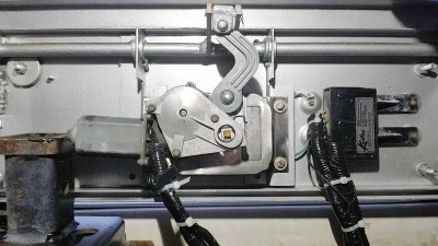

Gear Box and Control Unit

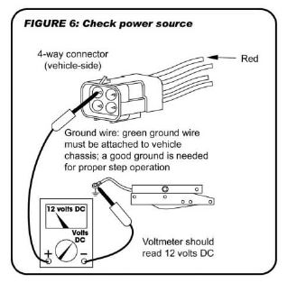

Once again, I wanted to share some updates to my Kwikee Steps project. One thing I forgot to show was the process on how to do a Power Check:
FIGURE 6:  Check Power Source

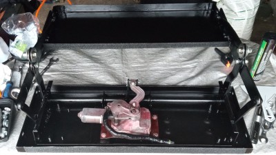

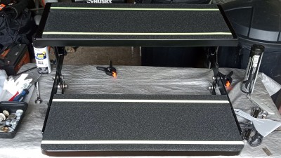

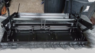

This time around I didn't go as aggressive on cleaning up the steps, but I did have to remove some new rust in spots, so I did some light sanding. This time I wanted to create a newer look similar to what the Kwikee Steps would look like new.  Originally the steps were White, after my first repaired I change them to a Gray to match the strips, which I thought look pretty decent.  This time around I painted them Black with new Bolts, Nuts and Washers.  I also replaced the Gray rugs I had attached to them, with Non-Slip Outdoor Stair Treads with Glow Strips to make them more visible at night.
It started to rain again today so I wasn't able to completely finish this project, hopefully in the next day or so.
I'll post additional images when it's done, for anyone that might be interest in doing something similar.
NOTE: I sprayed some anti corrosion spray on the Gear Box to perhaps add some additional rust protection.
Fully Painted ready to reassemble
Non-Slip Stair Treads with Glow Strips
Gear Box attached to bottom step
Re: RE: Replacement A Linkage for Kwikee Electric RV Steps
Posted: August 12th, 2024, 7:50 pm
by M_MINCEY

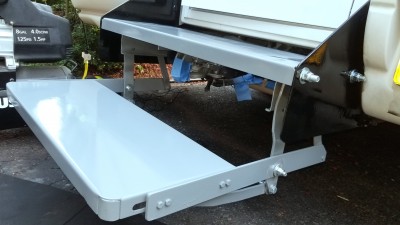

I was finally able to complete this project, as I mentioned in my previous post. I didn't take an aggressive approach this time, but everything is operational, and that's what matters most. I have a few more projects to finish, so time is of the essence. As always, I hope this helps anyone looking to undertake something similar.
NOTE: My steps are about 98% straightened. The mechanic did their best with the welding, and while it's not perfect, it’s a much better option than paying over $1,000 for new steps.

Gear Box and Control Unit Reassembled Under Step
