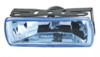

I'm going to reopen this topic. Since my fog/driving lights are dead, I'm now looking to replace them. Can't find anything exact with the measurements so I was thinking of getting some rectangular ones that are close and make it work. Anyone upgrade theirs? Looking for a model or brand.
Re: Fog Lights/Driving Lights
Replacements that I've read of being used include...
For about $180 a pair:
PIAA 1500XT fog lights
Apparently they're really nice. For the price, they should be!
For about $26 *each*, these LED bars from Amazon:
https://www.amazon.com/gp/product/B01N4 ... UTF8&psc=1
Pretty blinding.
For about $60 a pair from Autozone:
http://www.autozone.com/collision-body- ... true#close
Same as above, but only $25-31 a pair from Amazon:
https://www.amazon.com/gp/product/B0002 ... UTF8&psc=1
At least it says it's a pair. Also plenty on eBay, but hard to tell if single or not. You might need to ask the seller. Search for model NV-515W.
NV-515W
NV-515W
The above model NV-515W lights reportedly even fit in the original brackets. Be sure to check sizes vs. your openings of course. Luck!

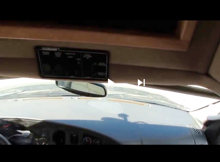

I know this is going to sound stupid, however, I have a 2004 glacier 2500. I have driving lights. I can't find the switch to turn them on. Help! :roll:
You've probably already tried this, but is there a switch panel on the overhead of the cab, sort of over your right shoulder as you're in the driver's seat? That's where mine is (along with a generator start, store switch, self jump start, etc.). Probably that's the first place you looked and they changed it for your year/Chevy though and that's why you're asking, but figured I'd mention it just in case.
I looked at a video of a 2005 Glacier, and the Chinook Lights-Gen-Battery panel looks to be almost behind the driver in the center of the rear entertainment overhead:
"Driving Lights" should be the leftmost switch.

Thanks Blue and Kevin. I never thought to check the overhead panel
I turned them on and I need to replace the bulb on the right side.

Kevin, I have the same lights that that you showed in one of your responses blue Lenses.
