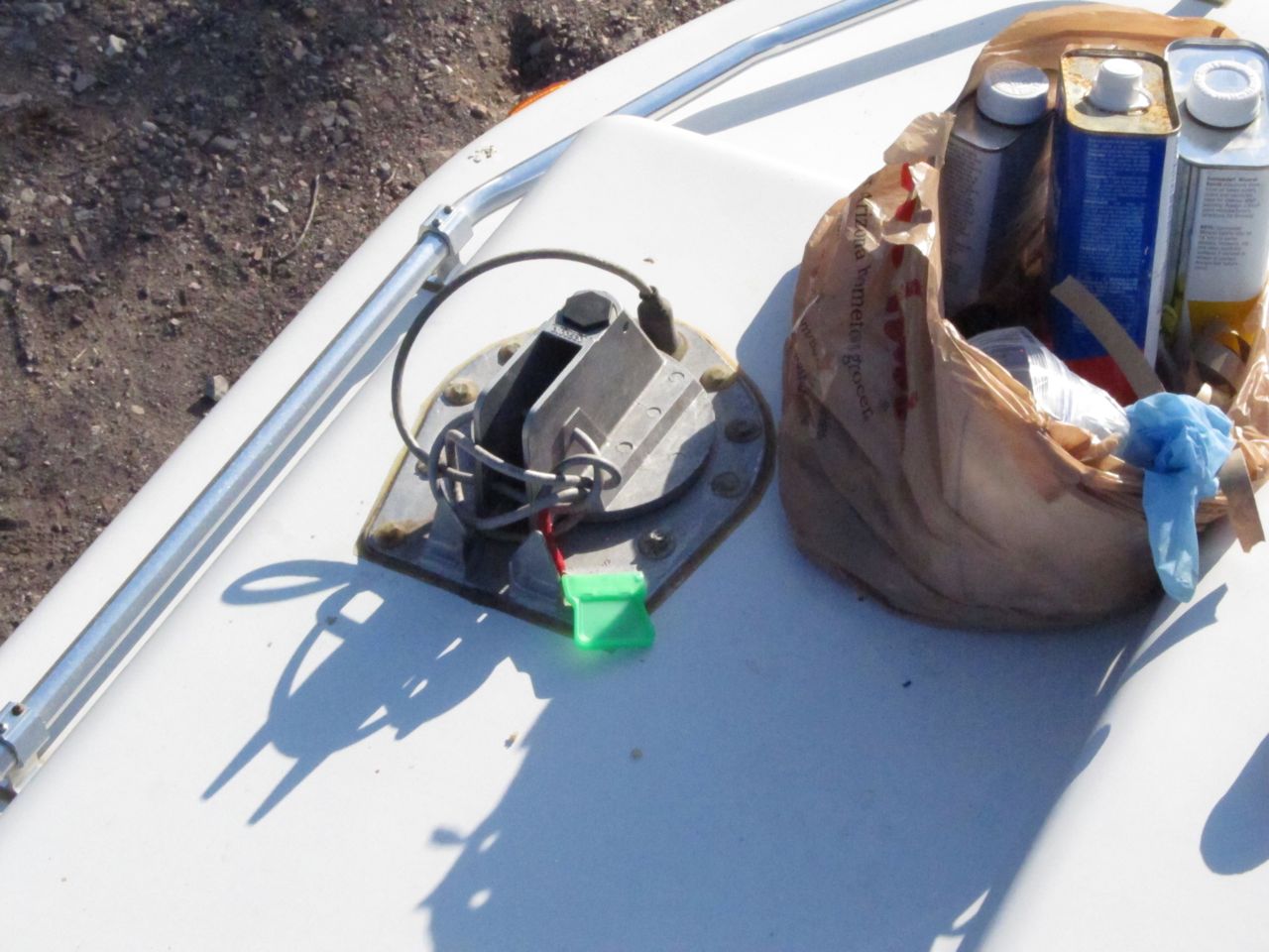

Here I'm mid-removal. Just shows things after the big crank-up section is removed.
And here is the roof just after removal. You can see that they didn't pre-chamfer the small holes for the screws, so they had "ruffled up" the fiberglass. Hence I chamfered them (and removed any small bits of cracked gelcoat) before filling them with the neat-then-thickened epoxy. BTW the razor blade you can see just at the corner of the below photo is a plastic "razor blade." They are very handy for working on fiberglass or other surfaces you don't want to scratch. This one is orange (the blade). There is also blue and yellow (slightly different properties to the plastic).
